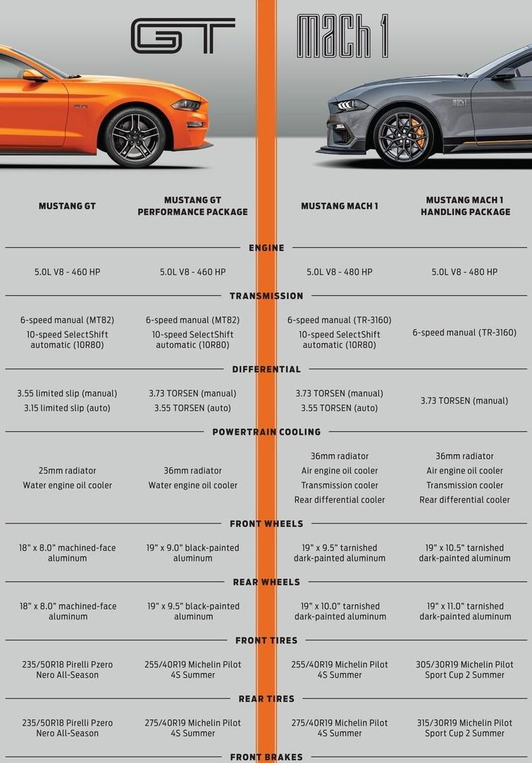

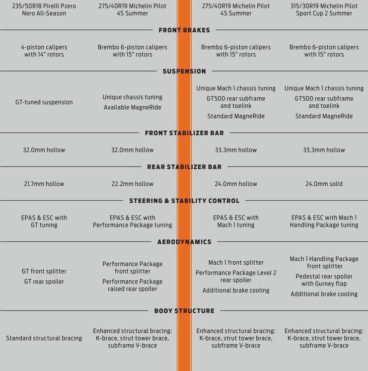

Pricing differences between the GT and DH are primarily going to come down to a lot of the things you cannot see. I'm attaching a comparison chart between the GT and Mach 1, to give you an idea. I've also noticed the initial specs for the '24 circulating in other threads.
