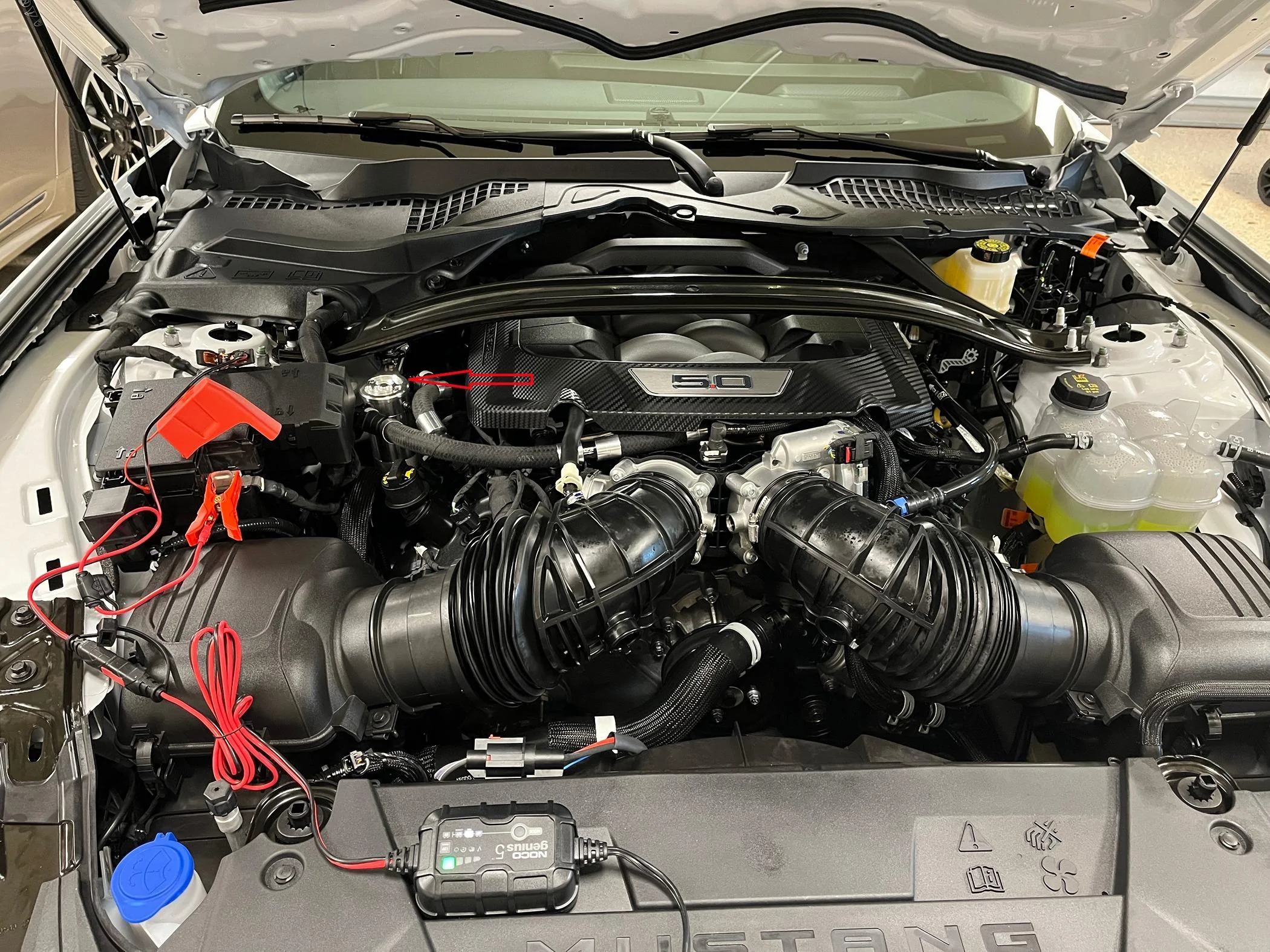

I put my 5 amp battery tender (for AGM batteries) on this morning at 7:00AM. Battery needed charging based on the indicators! While that was going on, I installed my white Bullitt manual shift knob. Looks great against the black upholstery and interior. I also installed the UPR Catch Can (dirty side only). That was a challenge due to tight spaces, the Strut Tower Brace, and the fact that I'm not mechanically inclined- computers, I'm your man.
After charging for three hours, I took the charger off and located my key fob "out of range" of the car and then measured the parasitic current draw off the battery - nothing turned on. I was surprised it measured 400ma (.4 Amp). This is what may be causing all the computer alerts due to a "non optimum" battery charge. I will measure again after the battery is fully charged.
Speaking of the charger, you have the positive clip attached to the fuse box line and negative to clip on airbox? This is working?the 5 amp NOCO Genius charger/maintainer on the battery.
Ford "nicely" put a Positive connection point under that red plastic cap next to the fuse box. The negative clamp is attached to a protruding bolt (longer than the others) near the strut tower. It looks like an obvious negative side connection for charging or jumping. Yes, it is working.Speaking of the charger, you have the positive clip attached to the fuse box line and negative to clip on airbox? This is working?
Hmm, interestingFord "nicely" put a Positive connection point under that red plastic cap next to the fuse box. The negative clamp is attached to a protruding bolt (longer than the others) near the strut tower. It looks like an obvious negative side connection for charging or jumping. Yes, it is working.

DCS’s way is considered correct. Way within the bowels of the owners manual I read this is an acceptable way, so the battery cover does not have to be taken off (also you can jump start this way) had been taking the cover also. I plan to do a plug and charge, by permanently addling a maintenance charger cable to the battery.Hmm, interestingI too have the negative on the long skinny bolt, but have been taking off the battery cover/hood to get to the positive battery terminal....PITA. Gotta check out your way.

I have attached ONE measly picture for now to show the catch can installation and the 5 amp NOCO Genius charger/maintainer on the battery. The car has been on the charger for almost 24 hours and is almost fully charged. I'll take more pictures in about an hour when the sun is up a bit more.

The positive tab is right off the battery post, before the BMS.Speaking of the charger, you have the positive clip attached to the fuse box line and negative to clip on airbox? This is working?
