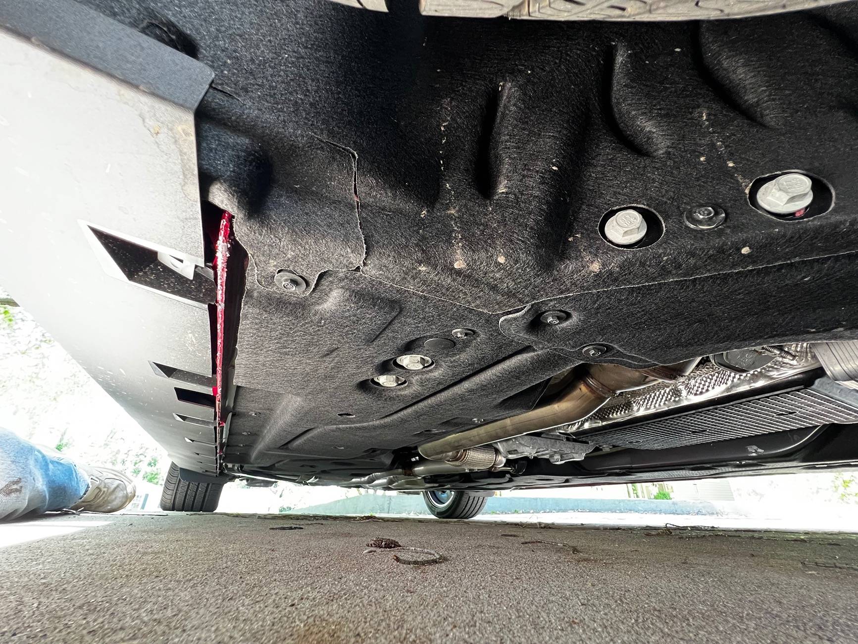

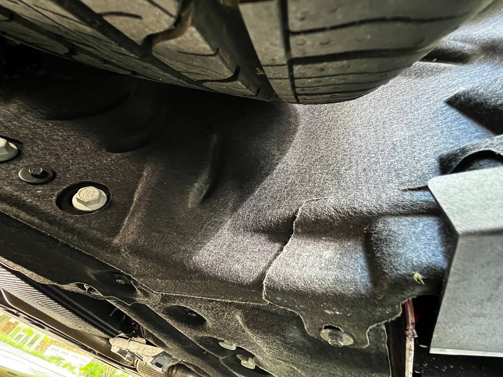

wide angle ground up drivers side. It’s attached in the center but the seam in the left puckers a bit. Looks like som black permatex is in order.

To me it looks like a new fender liner wich is cut from below and from the side, so the machine in the factory still can acces it. And they used a single screw below to close it.

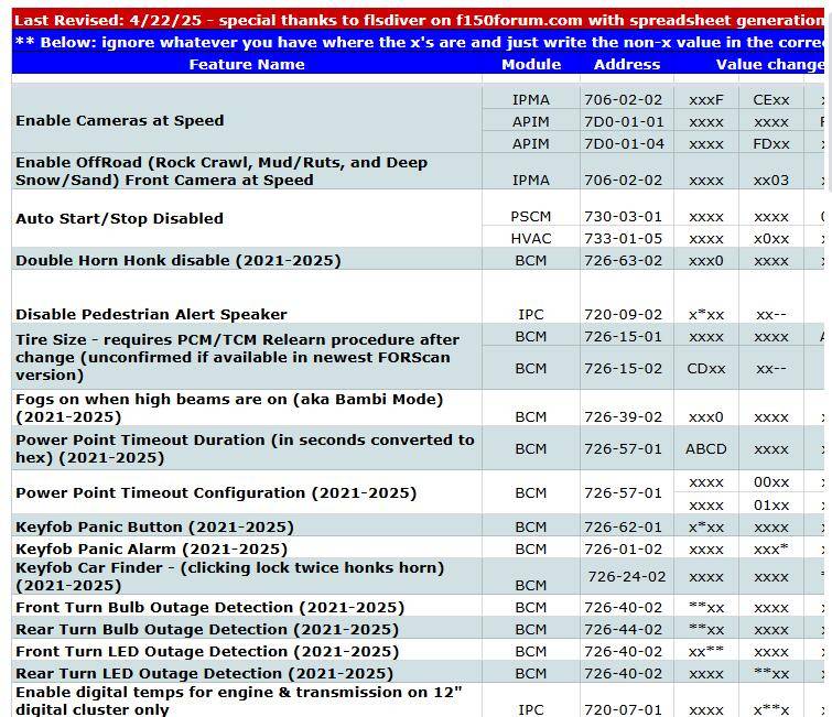

On the F150 forums, the spreadsheets have a tab called "Common" where all the "common" things that everybody does is listed.
Not sure why the "common" tab isn't being kept up to date on the 7G spreadsheet. @roket ??
E.g., 2021+ F150 "common" tab includes this:
2,715
4,121
Livinitup maintains the spreadsheet. all i did was ask him to make it, then post the link

Getting us back on track, if we can just note what changes you made / where you made them & any side effects.
Im ok with spreadsheets least will know the modules to check in when doing ‘ simple way’..

I found this video to be useful for me to understand Forscan basics. Not the specifics for our Mustang, but basics for using Forscan. I found it very helpful and afterwards I was able to easily change my continuous gear display in the easy method. I want to stay away from the changing of digital and hexadecimal values and just stick with things like ABLE and DISABLE. Having a spreadsheet listing those for our cars and a comment on what the changes do would be very helpful.

So you can select enable for gear display without changing values then?
DT-GT
Apr 28, 2023
624
1,092
Yes. In the IPC module it showed the name and DISABLED. I simply clicked on it and changed to ENABLED. Now I have continuous gear display.
