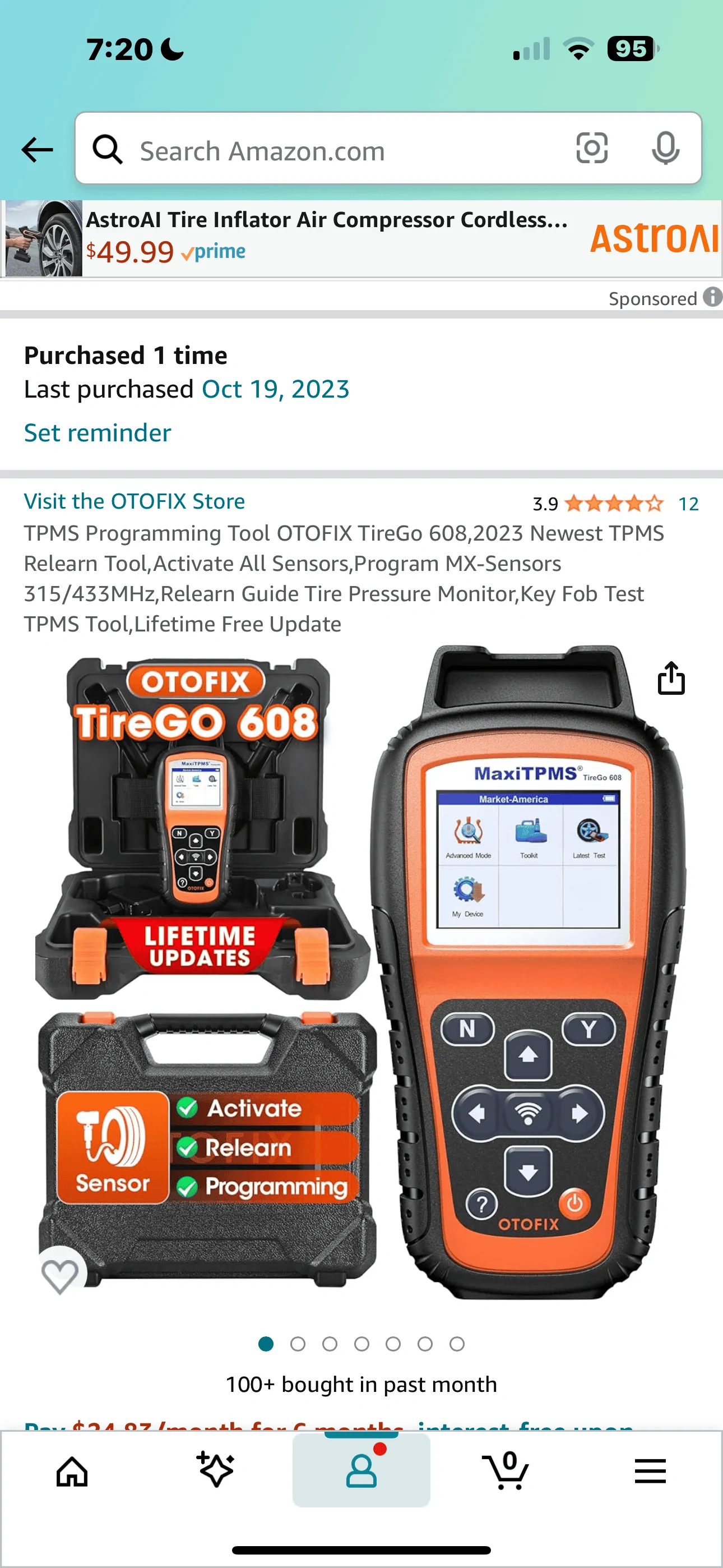

I bought a tpms tool on Amazon 150.00 seems to have programs the old sensors to the s650, it did however lose connection yesterday but this morning I was able to reconnect? I’ll see if it sticks and let you guys know the device I ordered had an update for 2024 model year as well but I had to use previous gen obviously with the previous gen sensors
I am wondering if that’s because it was working when the old sensors are close to the vehicle? I’m also have trouble training the sensors to my car…

I got they retrained with that tool I’ll drive a little to see if it sticks let you know
