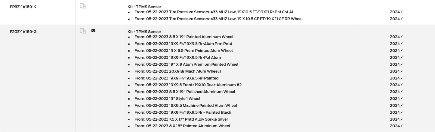

i have a solution to this. the correct TPMS sensor part number is F2GZ-1A189-G for EcoBoost, GT, and non-handling package Dark Horse, and FR3Z-1A189-K for handling package Dark Horse with both metal and carbon fiber wheels

That's the procedure I followed. Yep, everybody is selling the wrong sensors. Damn. I believe before 2024 they were 315Mhz.
**Edit.
So nobody has these in stock. Had to order through Ford.

By chance how do the old and new sensors compare ? Old working sensors have any visible numbers?

Thank you for the info. I ended up ordering F2GZ-1G189-G from the dealer parts counter. I'll find out on Wednesday if they fix the issue.

Thew new sensors are 868mhz I believe... after I too got the wrong ones the first time.

So with the correct sensors (F2GZ-1A189-G) what is needed to activate them? I guess the old button used for the S550 no longer works either? Anyone know?
