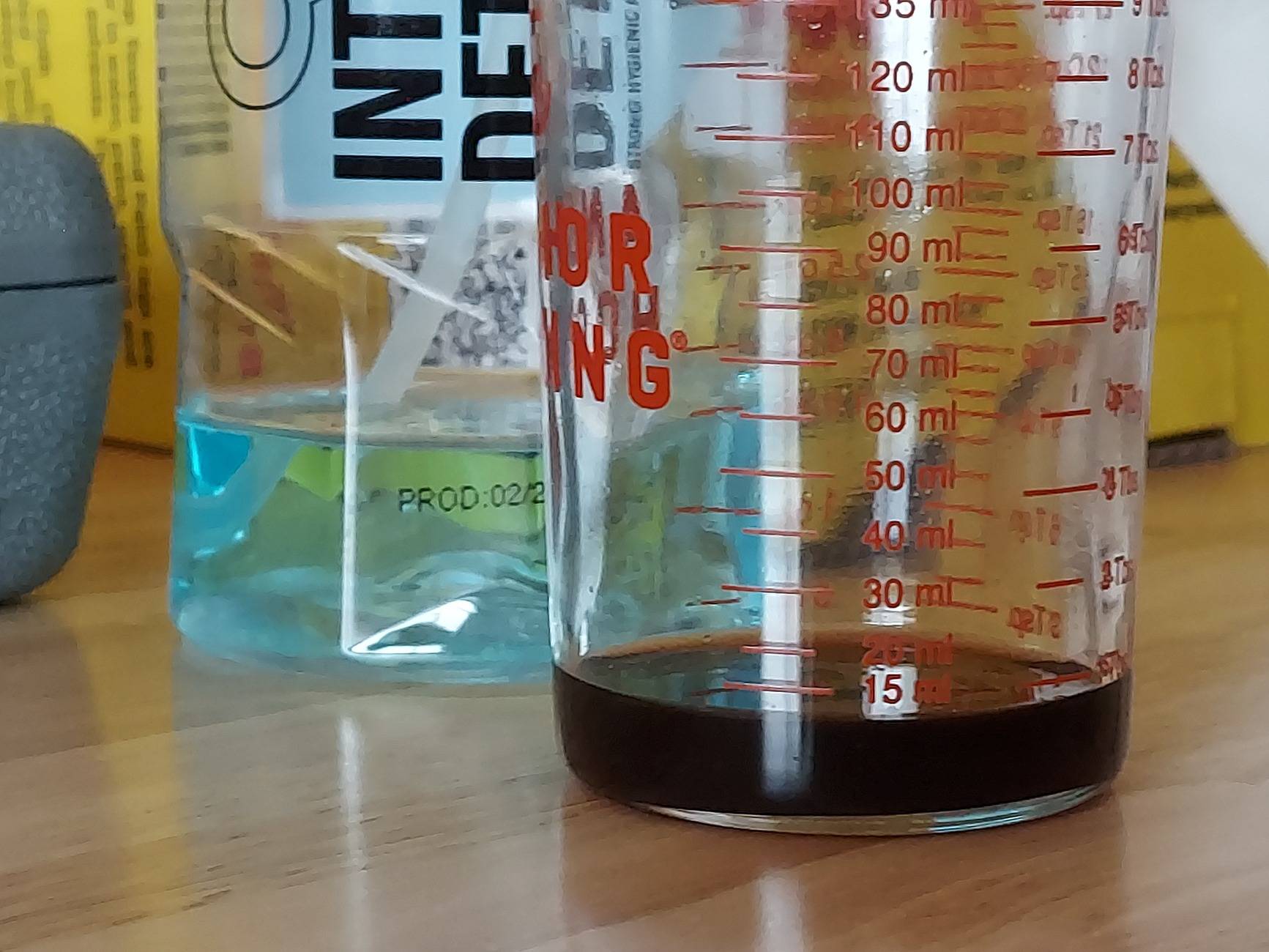

≈39N
However, the driver-side one is completely dry, with no sign of any oil residue. Is it normal?
Yes, that is normal.
On the Coyote, while the Driver can install catch cans on both sides, the Driver's side can often has little to none. A Driver's side can is often installed for a car which sees time at the track or has a unique engine setup.
Modded cars can be different. Turbos or superchargers often involve at least one breather. Catch can installation and positioning can vary with these engines.
On my Gen3, I recover between 10-15ml every 1500 mi/2400 km. If you want to measure the amount, head to the baking isle in the shops. They should have measuring cups of all standards for small amounts.

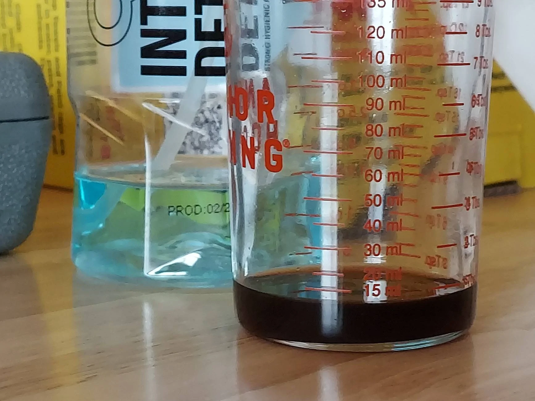

so about 3 tea spoons in a thousand miles or 2 or 3 oz between oil changes if my math is close. How many oz does it hold?

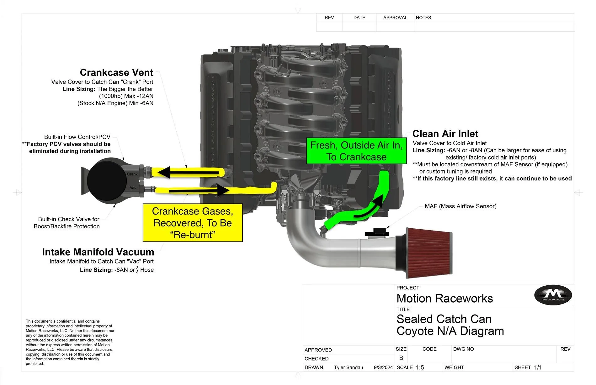

I'm using a unit from JLT, which holds up to 3 oz / 85 ml. Close to half a cup.
I did look at the Ford Performance site, the installation literature, etc., and the fill size is not listed.
But the measuring cups and items I referenced, those are good for anything in the garage like that. Some also use food syringes, especially when they're measuring out other additives for the drivetrain. Next time you're at the shops, check out the kitchen utensils isle. You could use any of those and water to confirm what it holds.

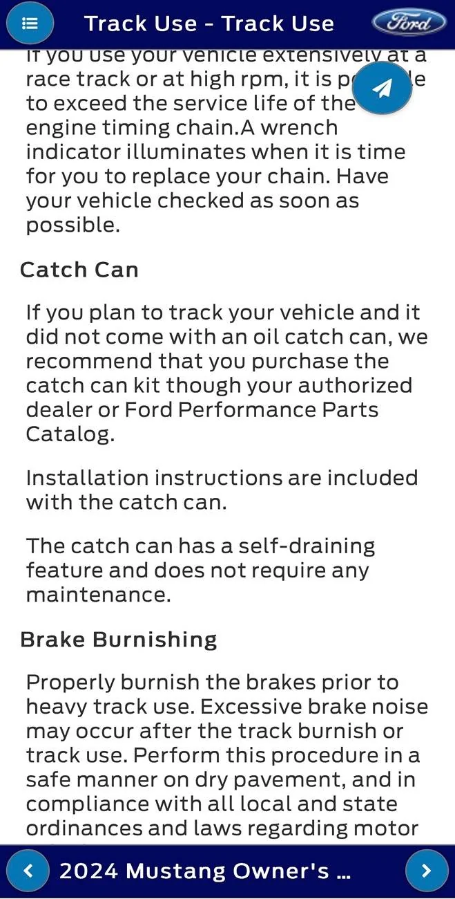

Excuse my ignorance but is it really a big deal to not have one of these on my car? I have a 24 GT (base model) that's completely stock that I use as my DD unless the weather is crappy here in MI. Not even sure what this does and what I need it for?
I think it's subjective. I can see a need for it for some use cases, but for others, not so much. Furthermore, why would Ford not include it from the factory if it was that critical? That's just my $0.02.
