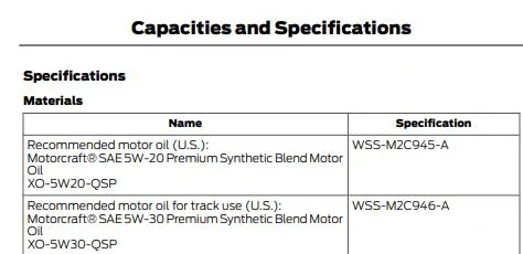

So strange, my two different 2016 mustang GTs both had 5W-30 in the manual.
II checked a few manuals for the years, some are 20w and others are 30w. Here's the currently available manual for a 2018, v3:
https://www.fordservicecontent.com/...-Owners-Manual-version-3_om_EN-US_03_2018.pdf
Regular is 5w-20 and Track Use is 5w-30.
Pages 299 - 301. 299 shows the header for the 5.0 and the below pic is from 301.
S650 Mustang First oil change dealer put wrong engine oil. 1735210781905-pq
The 2019 manua, 5w-20:
https://www.fordservicecontent.com/Ford_Content/Catalog/owner_information/2019-Ford-Mustang-Owners-Manual-version-2_om_EN-US_01_2019.pdf
The 2020 manual, 5w-20:
https://www.fordservicecontent.com/Ford_Content/Catalog/owner_information/2020-Ford-Mustang-Owners-Manual-version-2_om_EN-US_12_2019.pdf
The 2021 shows a move to 5w-30: https://www.fordservicecontent.com/Ford_Content/Catalog/owner_information/2021-Ford-Mustang-Owners-Manual-version-2_om_EN-US_03_2021.pdf

This brings up another issue besides viscosity, the -A oils in the screen capture above are SN oils. The 2024 Mustangs require SN Plus oils to reduce the possibility of Low Speed Pre Ignition “LSPI”. This is probably more common in Ecoboost engines than N/A coyotes. The one approved variance on SN vs. SN Plus is Whipple, who recommends 5w-50, which is out side the SN Plus spec.

For a 2024, if you get an oil that is WSS-M2C961-A1 compliant, a 5W-30, you'll essentially get a GF-6A oil that has the 7 new tests for timing chain wear and covers the LSPI requirement.
The older SN stuff was typically GF-5, not GF-6.

Mostly correct, the older SN (not SN+) was GF-5 whereas the newer SN+ is ILSAC GF-6.
Also, it’s not what we get from the factory, but also what we’re supposed to get from anyone servicing the vehicle.
My point was the OP only stated viscosity. So I wanted to make its not just viscosity but API and ILSAC spec as well.
Dealers are supposed to be professionals. They should know this. Also, how many quarts 8 (I’ve seen that problem here for the GT’s) vs 9.5/10. Pay extra for “official” service and get less quality is completely unacceptable.
