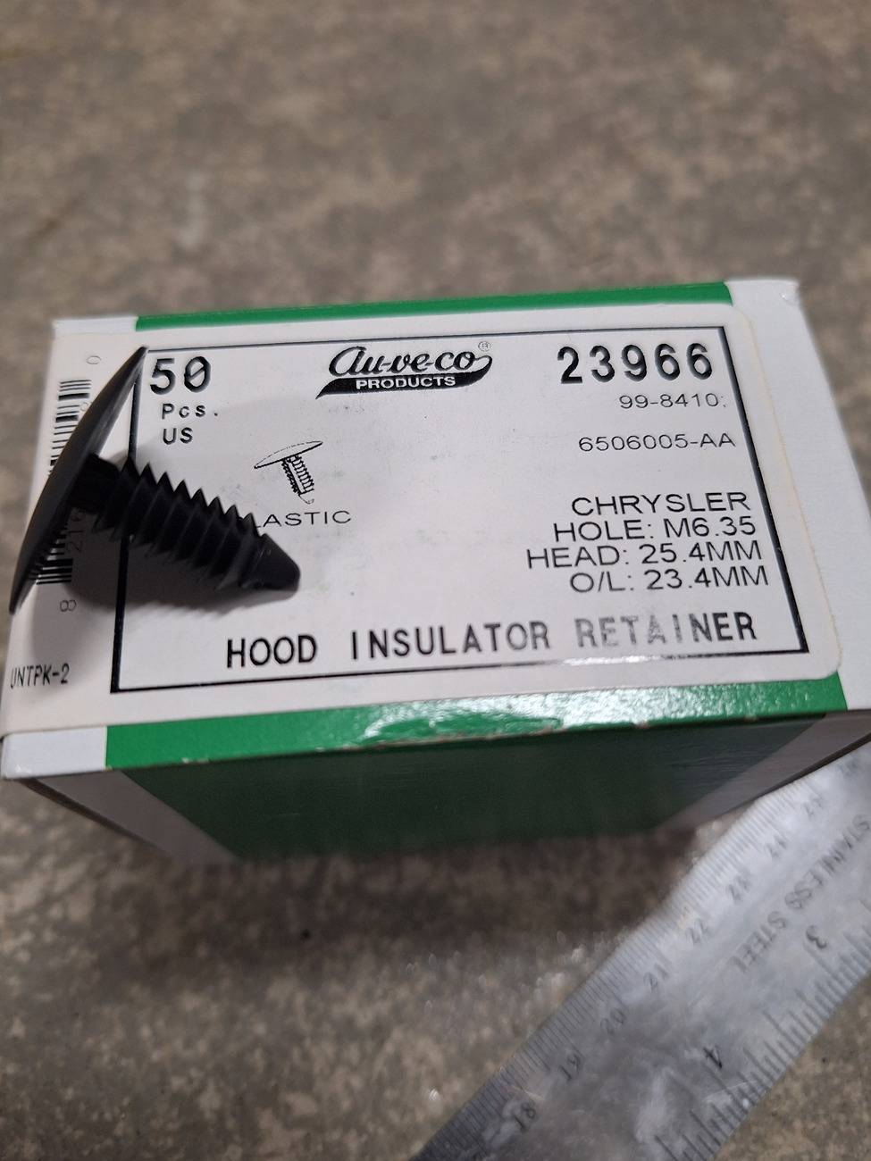

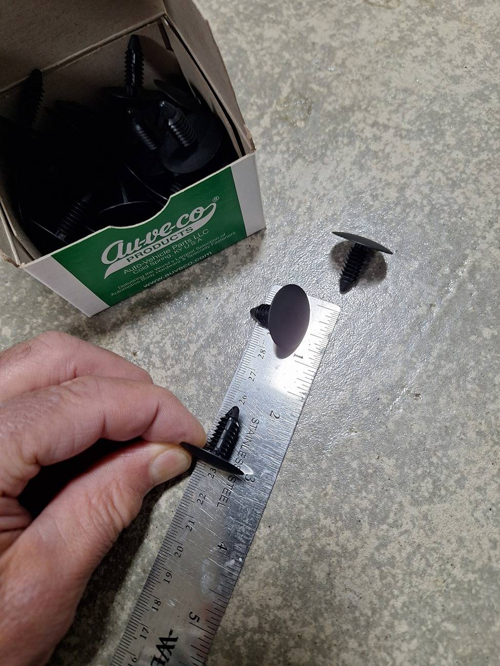

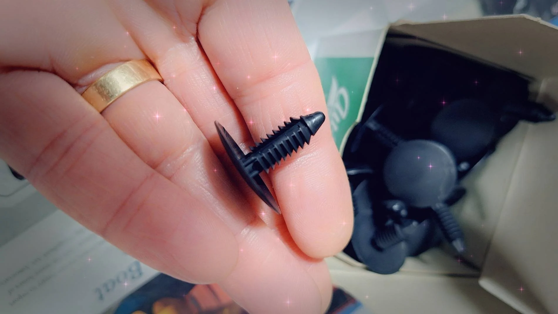

The other day I had to pull the liner to retrieve a small battery cover connector. I had to pull a factory push pin off the bottom shield and it got trashed. I compared the 2 and they are the same so I pushed it into place and it seated very firm and snug. They come in a box of 50.
https://www.amazon.com/Auveco-Chryl...r+w709371-s300.+qty+50.,automotive,140&sr=1-1

@Grabber1 ..... awesome looks identical to me - good to know. Thanks for the info. Yours will probably work fine, although having a dusting of ocd I'd probably check after a freeway run :-) I bought a bunch of aftermarket too then I chickened-out and bought the Ford oem pins. They weren't expensive they just took a long time to arrive, hence me ordering them ahead of time - just in case. Ford PN for the finned pin you show is W711687 S300 (4 pcs) Ford PN for the other pin - the split pin - is W714040 S300 (4pcs). I always hand the two packs to the tech and tell him to use a pin(s) if he needs to and just leave the packs on the passenger seat. So far one pin (one of the split ones) was used. So three shield removals one pin used.

Mine are not aftermarket. They are a Chrysler product. 🤣
Box of 50 for 10 bucks delivered.
