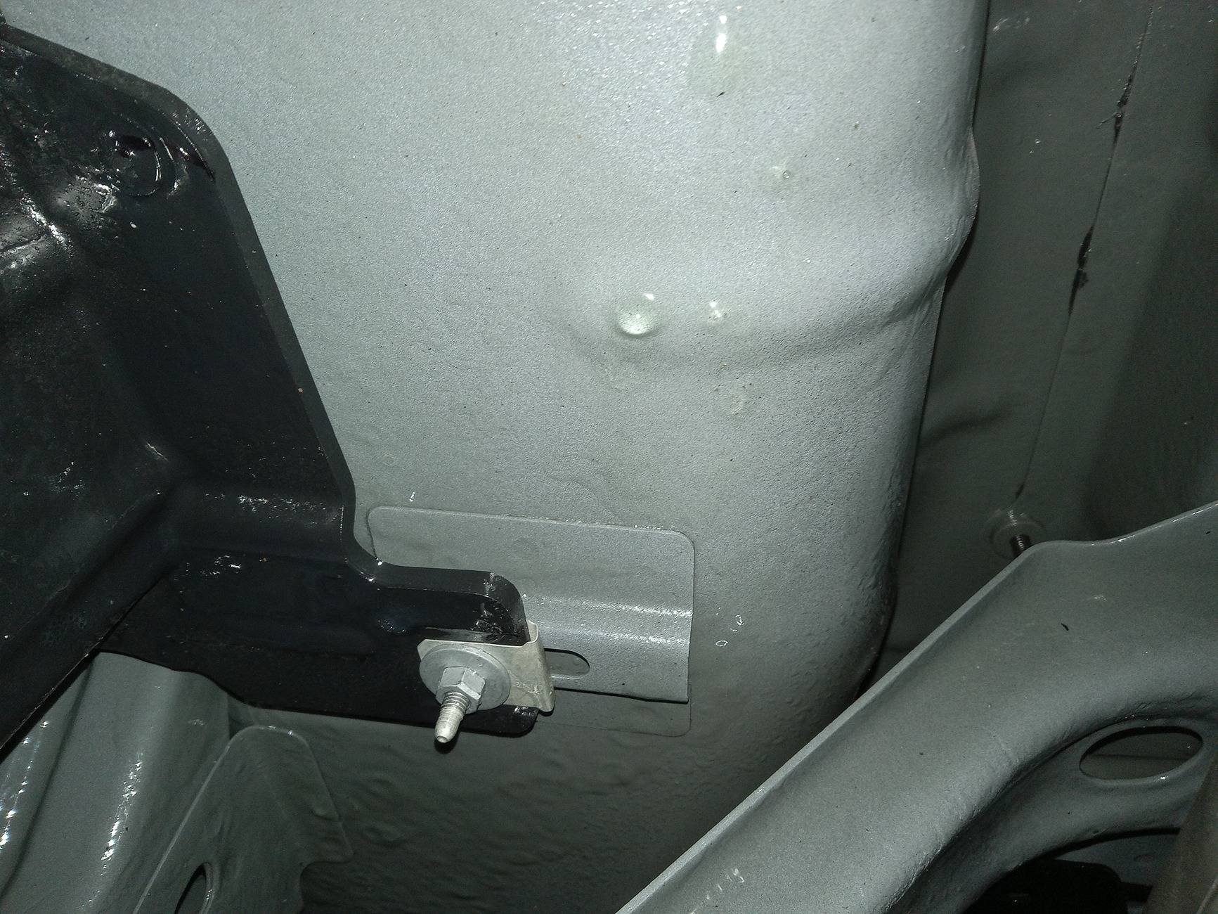

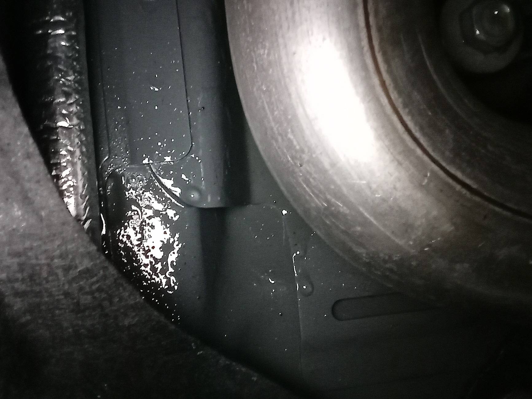

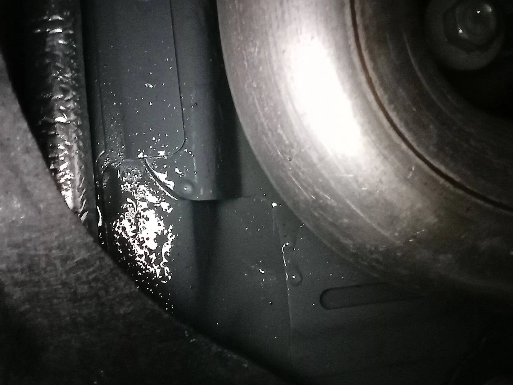

@HeyMoe! ..... Thank you for taking the time to share your experience with us. There are several interesting discussion points. The new "salting" of roads should be called "brining" of roads. The liquid brine they now spray stays on the roads (and subframes) longer. The "old" salt crystals were easy to get off with the water underspray at car washes. The "new" brine gets everywhere under the frame - every nook and cranny. Even driving on a dry road in the winter clouds of this $hit go everywhere. The new belly pan covers are worse than the old "open frame" configurations as the belly pans hold the brine/water/ dirt poultices against the frame longer in a wet format that can't dry-out easily. Worse yet, these areas are almost impossible for a car wash underspray to get at. Modern engines that run much hotter and dual catalytic converters cook these poultices, really speeding-up rust damage. What to do? For the vehicles we drive daily in the winter I have used clear oil undersprays on the undercarriages - NOT the waxy crap that actually traps moisture and causes worse damage than using nothing at all. I get the "winter" vehicles oiled every year (cost about $100) and do NOT use the car wash underspray option at car washes as that would just wash the protective oil off. This has resulted in no significant rust in vehicles that we kept 10+ years and the dealership mechanics bought from us for their children, family & friends. ......With my 2014 Mustang and 2024 Mustang ...... same clear oil treatment. The oil spray on the 2024 was done AFTER the belly pans were removed and @AZ_Ryan AFTER the patches from DIYvan.com were installed. Ha Ha ..... My 2024 Mustang will likely not ever be driven in the winter BUT if it was the oil treatment would protect it very well AND because it has belly pans that I believe promote rust even in the summer - the oil underspray will IMO 100% stop any rust there, again @AZ_Ryan for $100. :-) I'll try to attach a couple of pics. Just a clear free flowing oil that (like the friggin' brine road spray) gets everywhere. IF you have a Mustang that has already been subjected to road salt or worse yet road brine spray or even of you live in a coastal area - take it to a car wash and run it through the under spray several times. let it dry thoroughly and then have it under oiled. I use Corrosion Free oil spray now but in the past used a spray called Oil Shield. I have seen the same or very similar product from other manufacturers. Corrosion Free has a web site where you can buy the product in cans or even bulk with spray nozzle systems - for any of the DIY guys on the forum - especially the lucky ones with their own lifts.
