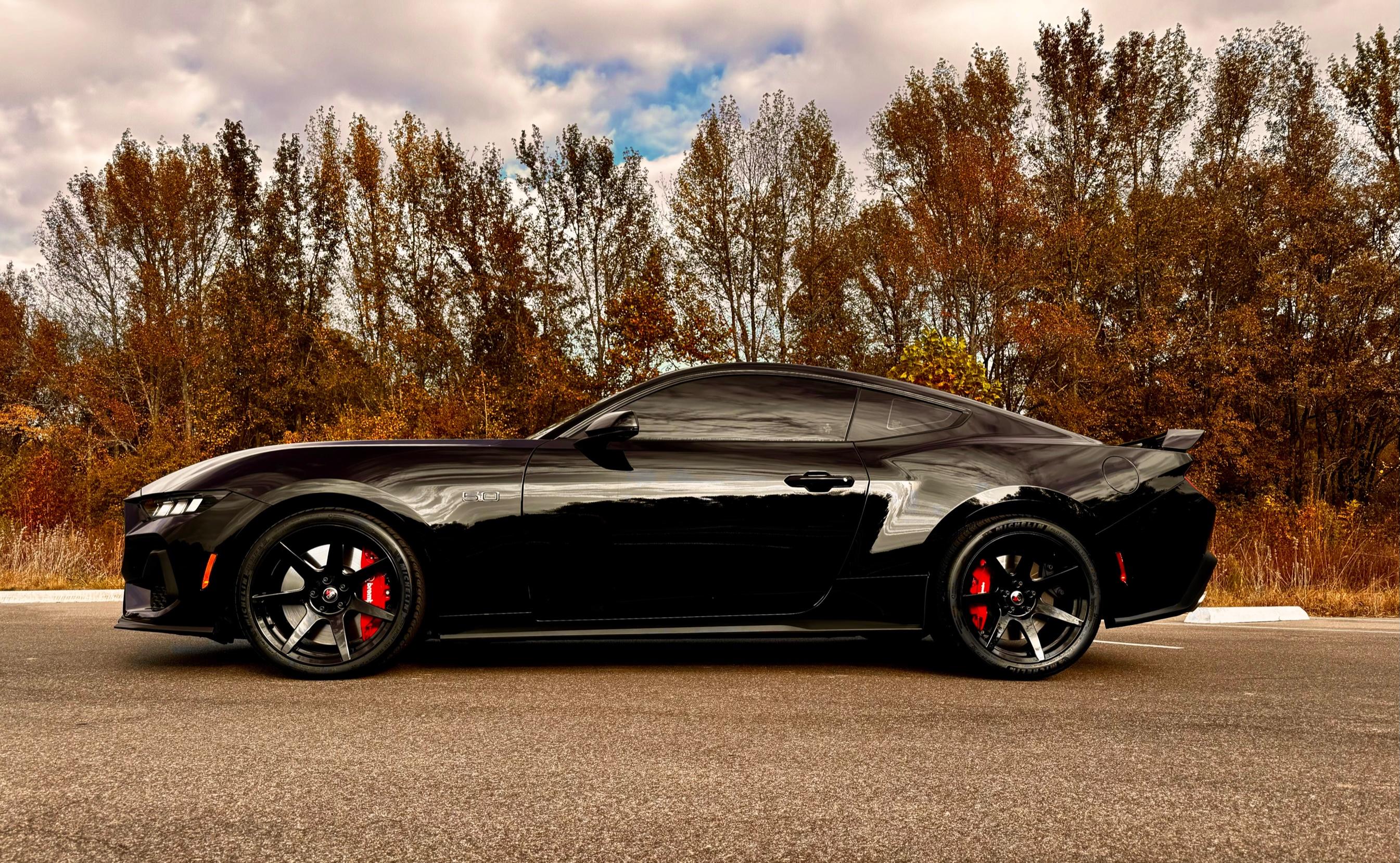

Here's what I did...Project 6GR 19x10/11 with 285/30 and 325/30.
Running the same setup as you with GR6 10-spokes. I want to switch to 20" wheels with the same tire width, but I'm a little concerned that they might rub.
