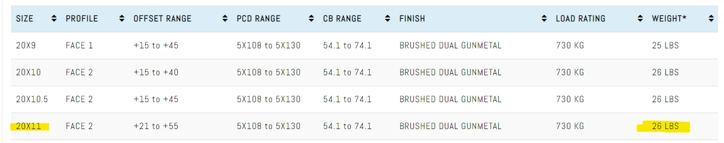

I see you guys carry Vertini wheels. I'm trying to decide between the RotaryFlow Forged RFS1.9 and the Fully Forged VS21. Do you know what the typical weight difference is between RotaryFlow Forged and Fully Forged at the 20 inch size? Vertini lists the 20 x 11 RotaryFlow Forged at 26 lbs but weights aren't listed anywhere for the fully forged version.

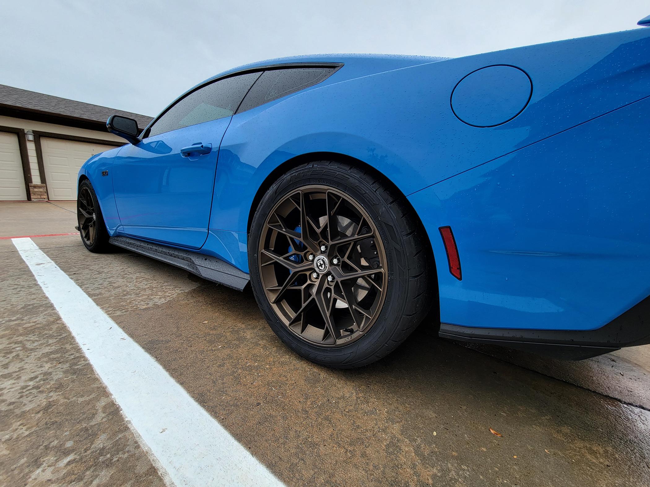

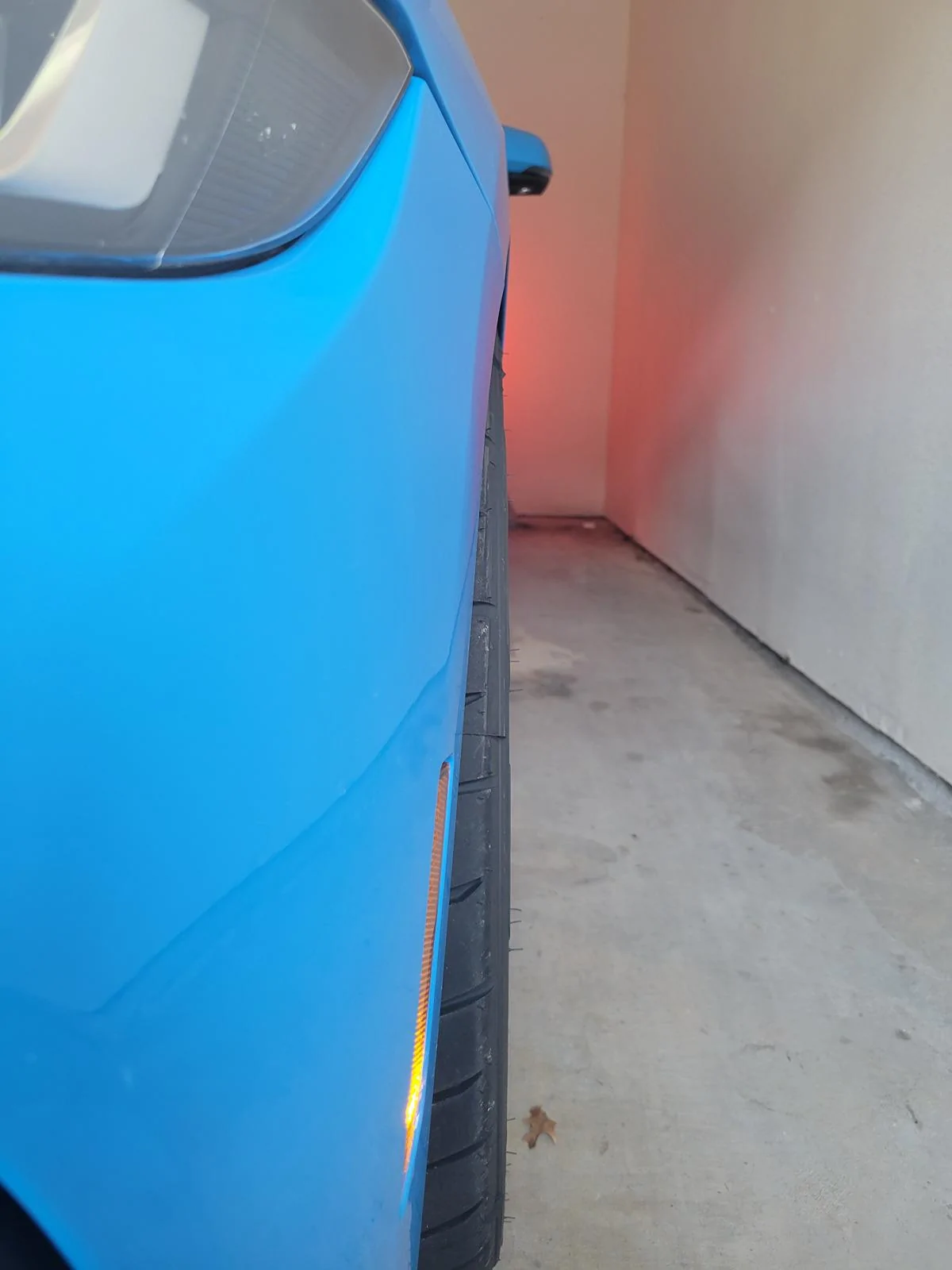

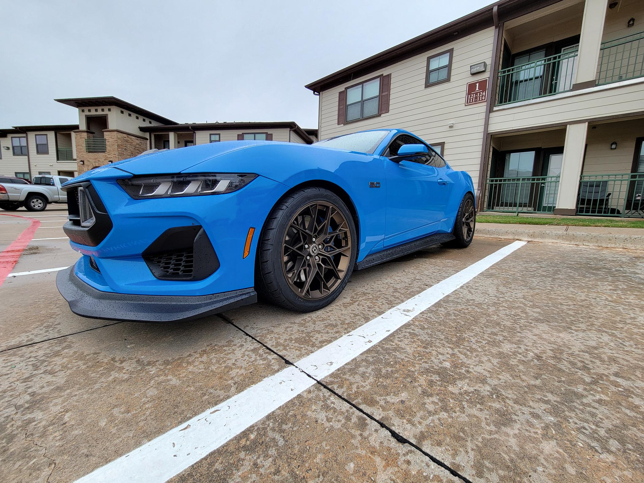

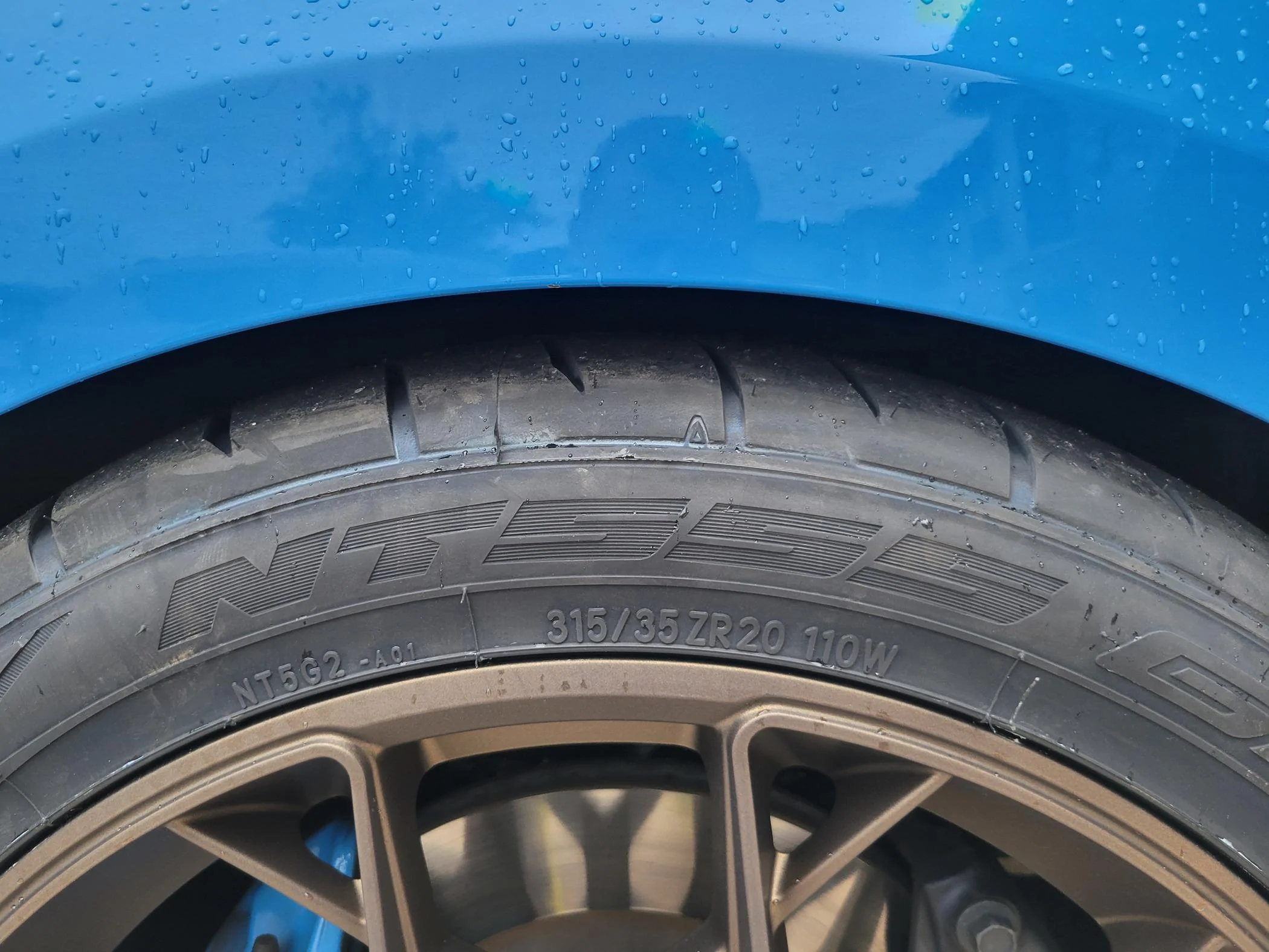

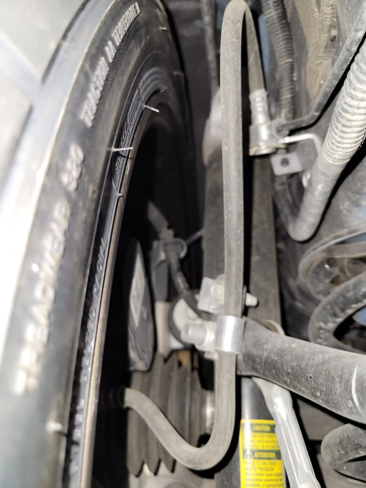

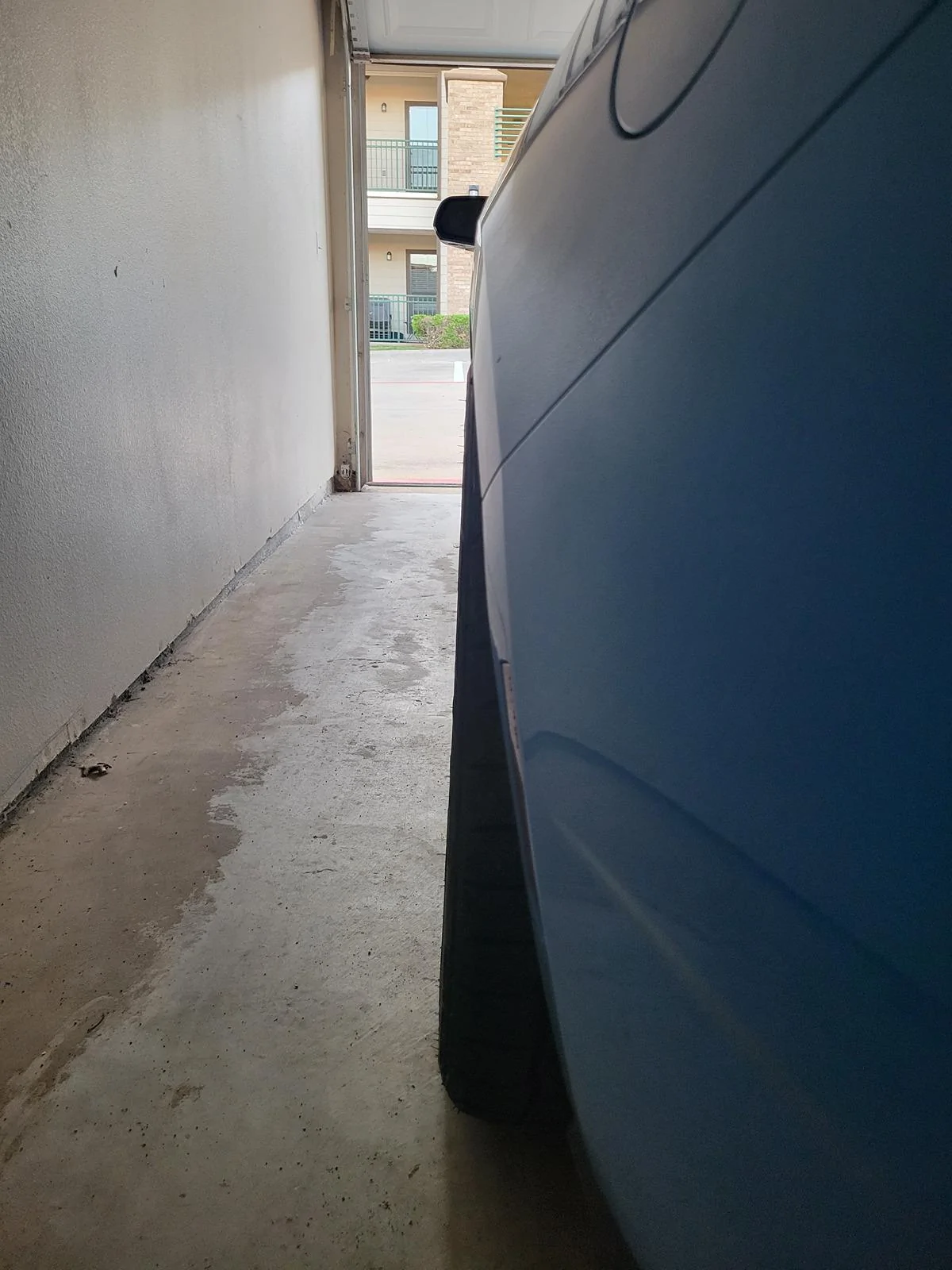

As promised here you go, HRE FF10s in IPA Bronze
20x10 285/35 NT555G2 front.
20x11 315/35 NT555G2 rear.
Plenty of space on the rears
S650 Mustang Widest 20" setup in the rear? 20240420_135117
S650 Mustang Widest 20" setup in the rear? 20240420_135129
S650 Mustang Widest 20" setup in the rear? 20240420_135419
S650 Mustang Widest 20" setup in the rear? 20240420_140346

Looks awesome man! I think you nailed it. A couple follow up questions if you could help me out.
1. I like the way your setup fills out the wheel wells. Is your car lowered?
2. Could you share the offsets on your rims ?
3. On that last picture about how much clearance do you have? It looks like the first thing that would hit is the shock?

1. nope, stock magneride system
2. 35mm front 50mm rear
3. hard to get a good measurement but its about 1-1 1/2 inches of space between the tire and shock

Nice, I'm guessing the shock is the first thing that would hit back there? Have you noticed any rubbing since driving it with your new setup? Do you have any pictures straight down the side kind of that would show how much the tires poke out of the fenders / rear quarter panels? It looks like your tires are flush or tucked pretty nice from the angled photos anyways.
I'll have to grab those photos after work but it's flush to ever so slight poke. No noticeable rubbing. Yeah the shock will be the first thing hit in the rear.
