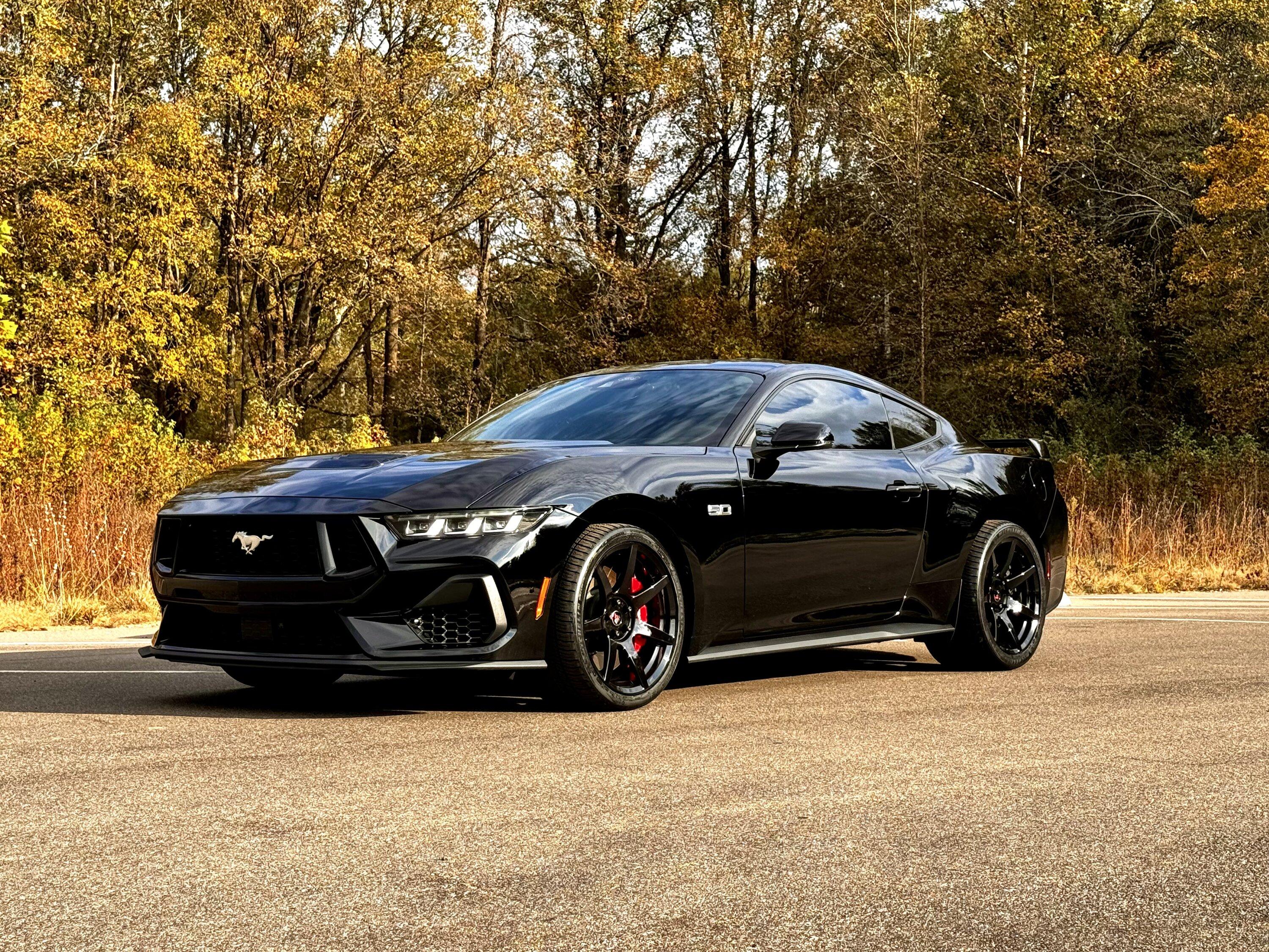

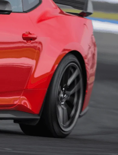

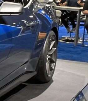

Does anyone know what the widest wheel we can fit in the back of the S650 is?
ThreePedalPlow
Mar 7, 2023
61
552
505
Saint Louis

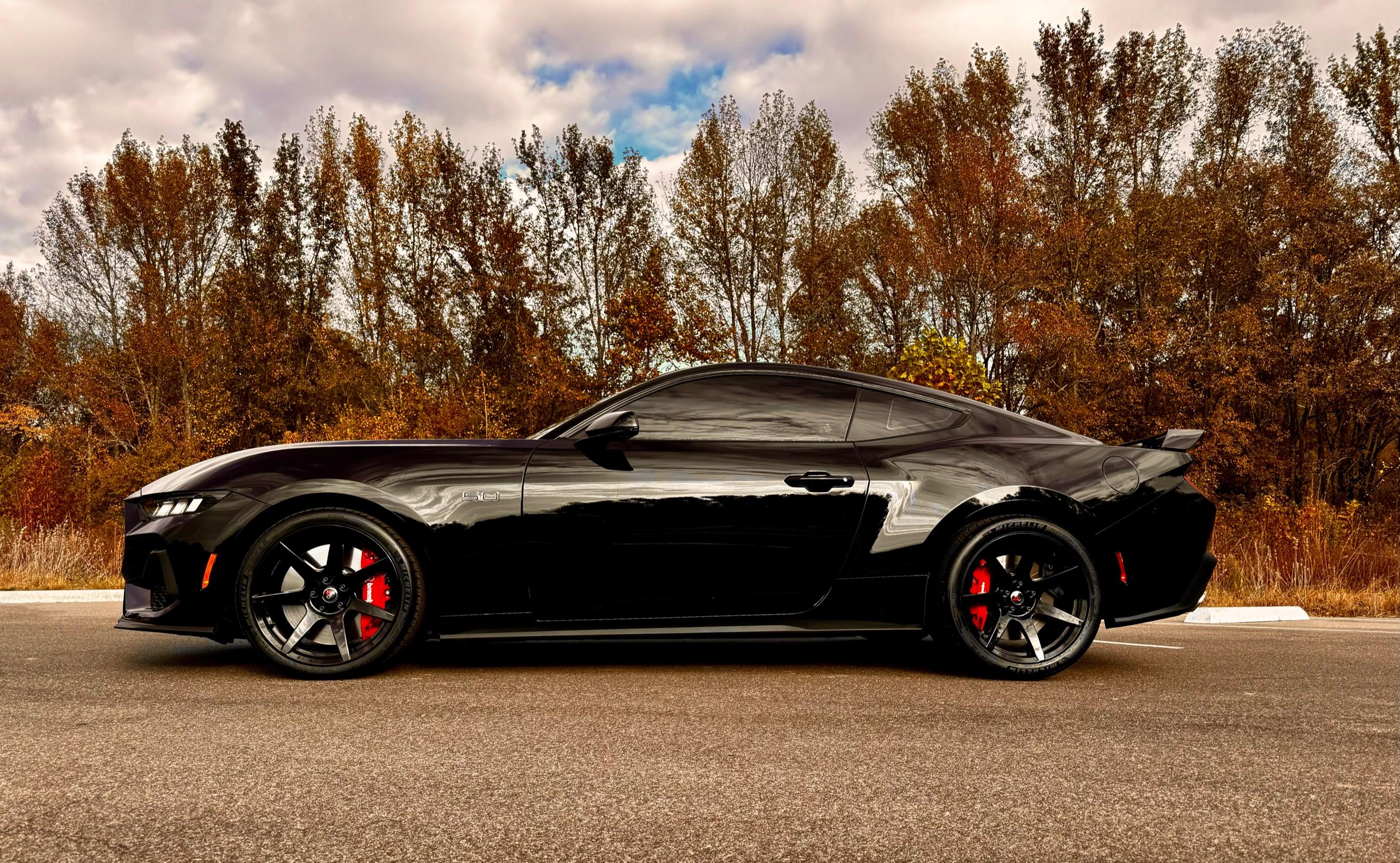

I found a 20 x 11.5 wheel I like but could go to a 20 x 11.0 if need be. I'm wondering if the 11.5 would stick out of the wheel well too much as well. I don't care if it sticks out some at the bottom of the wheel well but I don't want it to stick out at the top of the wheel well. I'm pretty sure the Dark Horse wheels are 11.0 wide. Dark Horse pictures below for reference. I'm just looking for as much grip as possible out of the hole. Maybe I would be better going with a 19 x 11.0 or 19 x 11.5 and just use a taller tire if that is my goal.

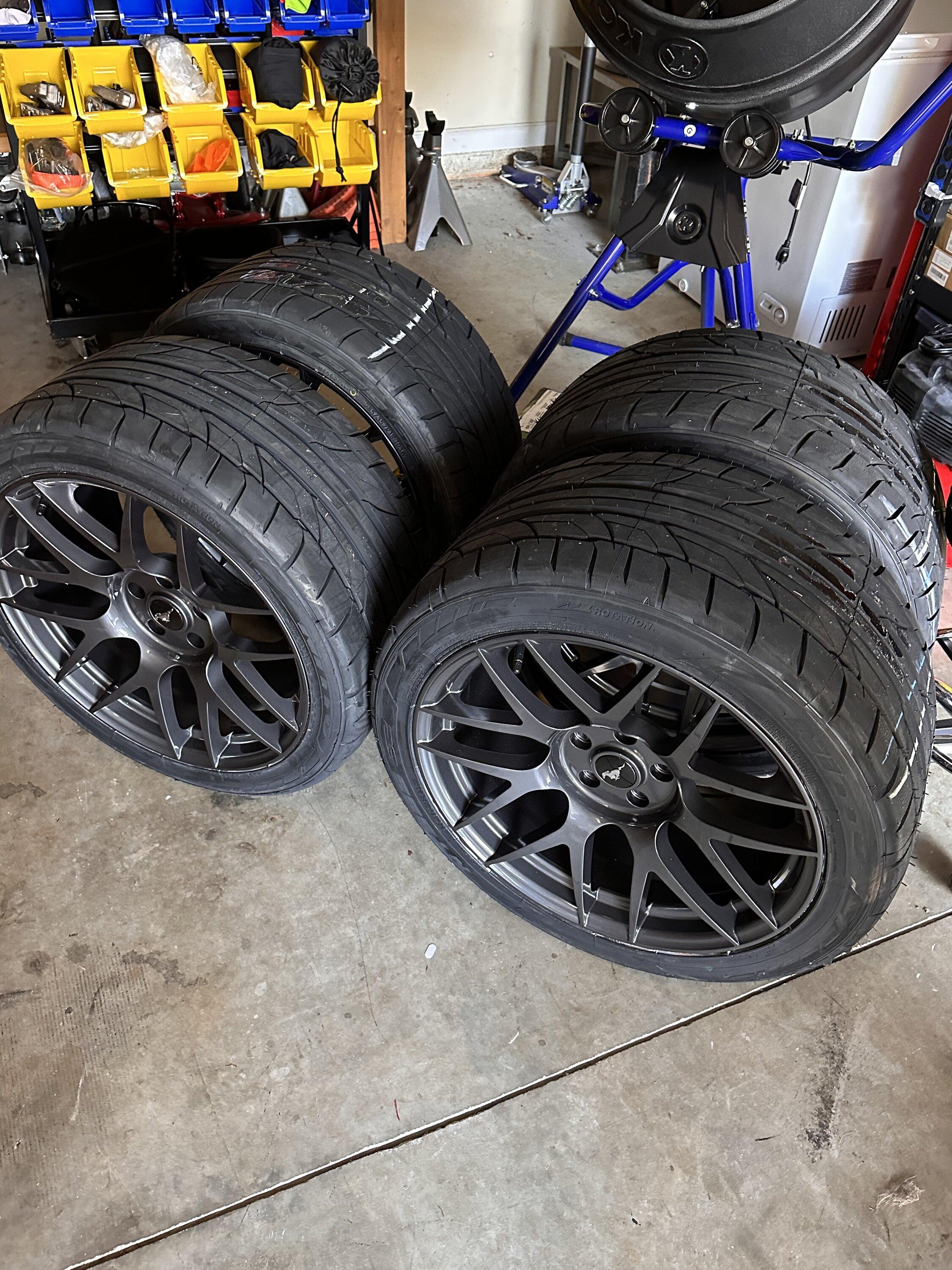

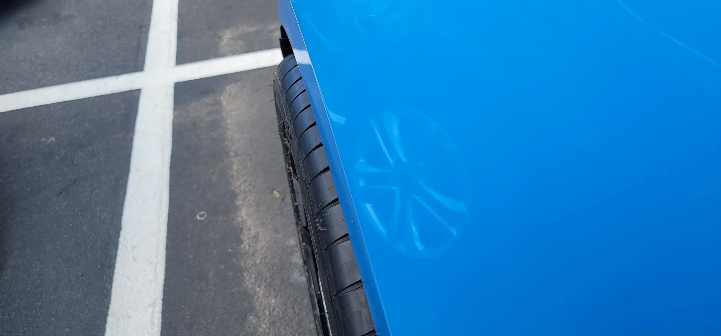

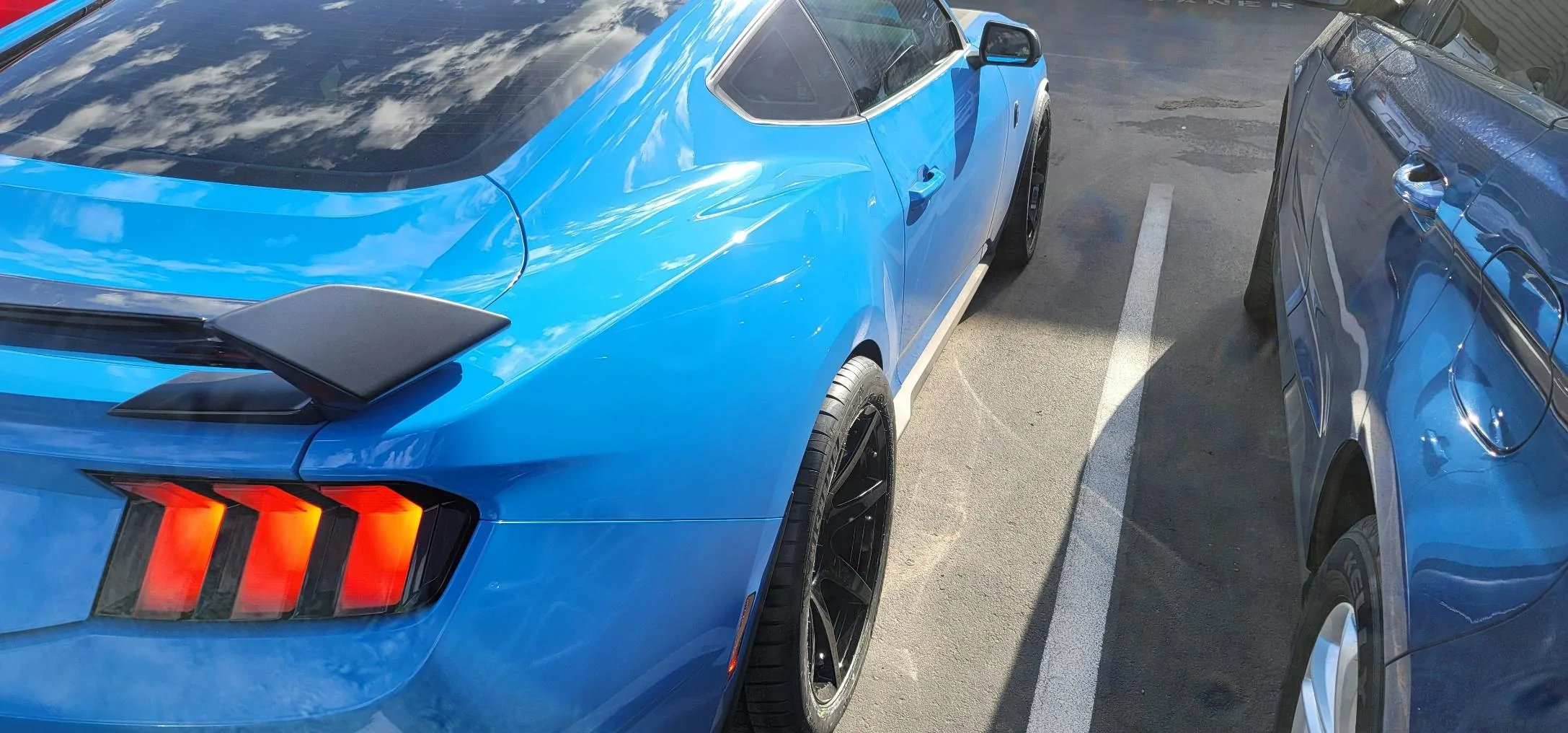

Dark Horse handling package has 11" wide rear wheels. the Shelby GT350R and GT500 have 11.5" wide rear wheels. i have 12" wide rear wheels. it depends on offset, width, and tire sidewall

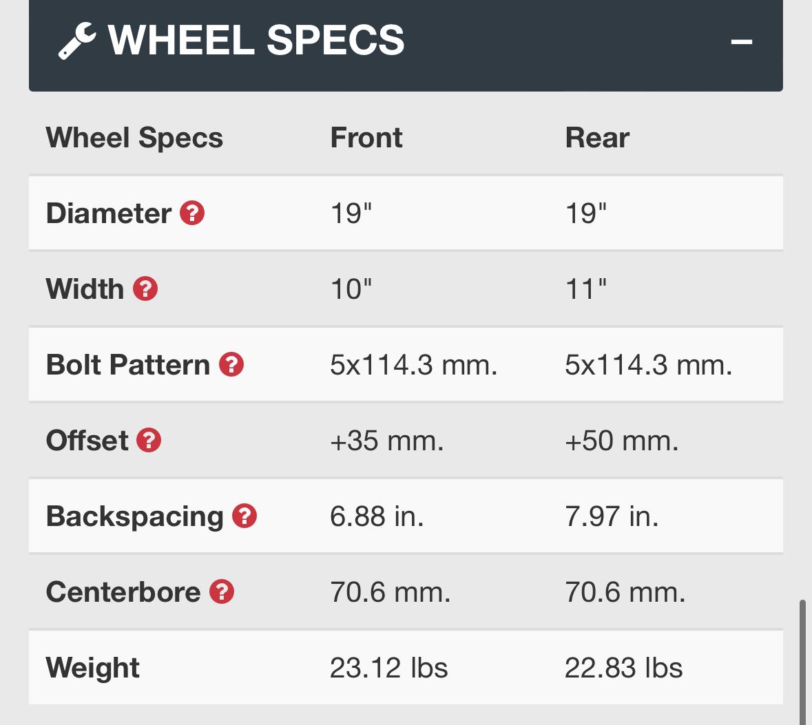

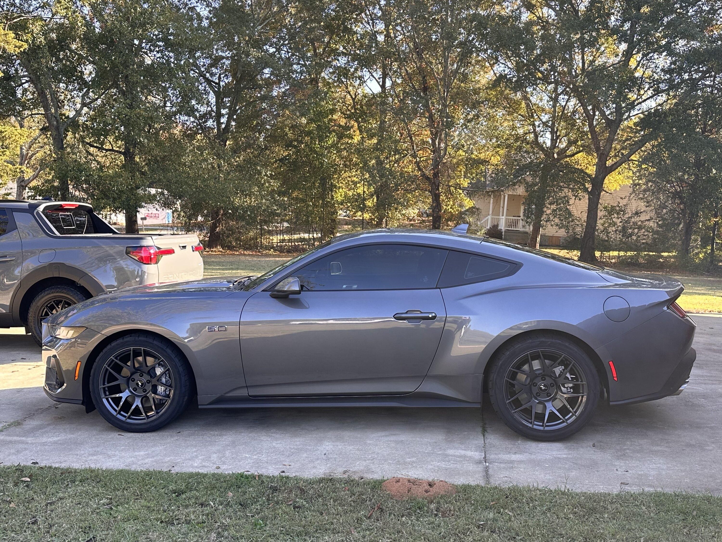

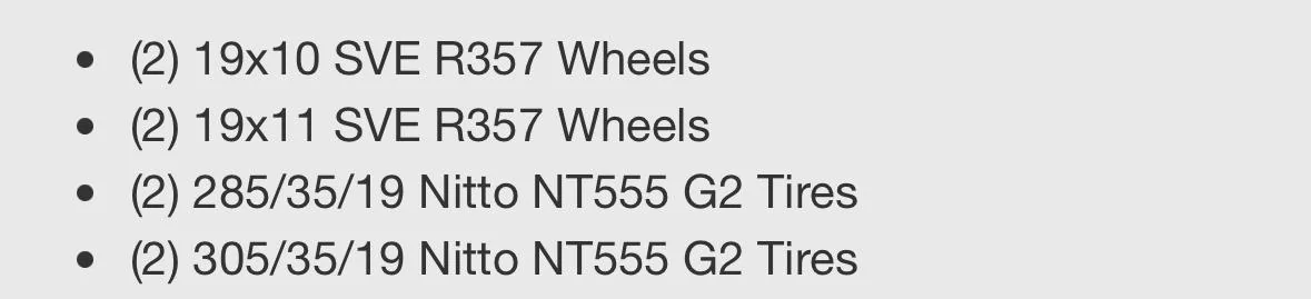

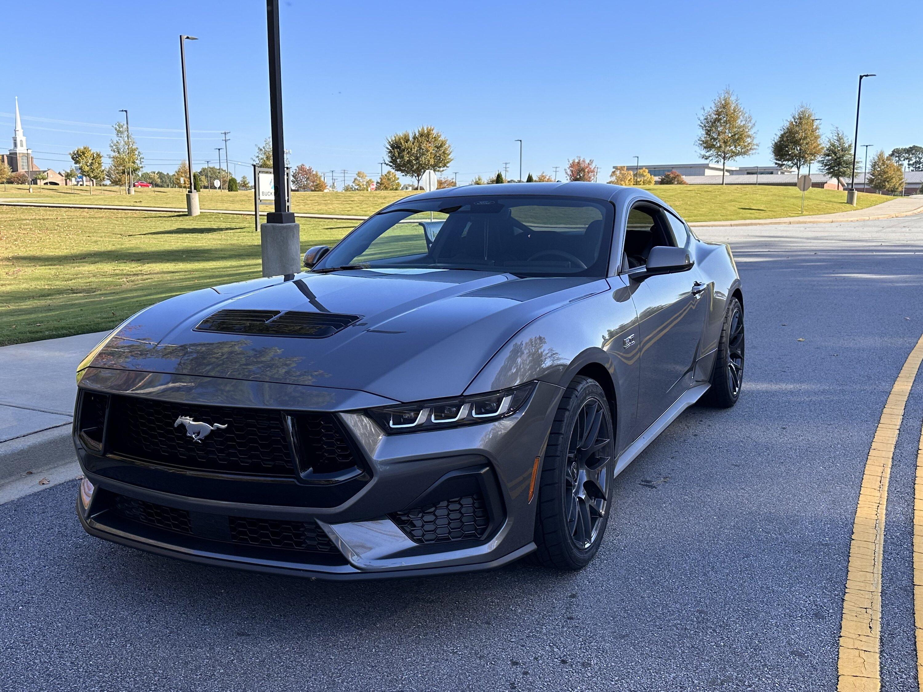

Don’t know the widest but the 19x10 front and 19x11 rears I put on today fit just fine :-).
Hey, can you share pics, and specs. Thx
What are the details of your rear setup if you don't mind me asking? Could you share a picture or two?

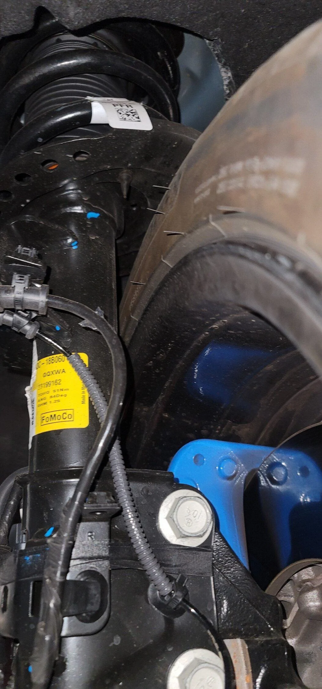

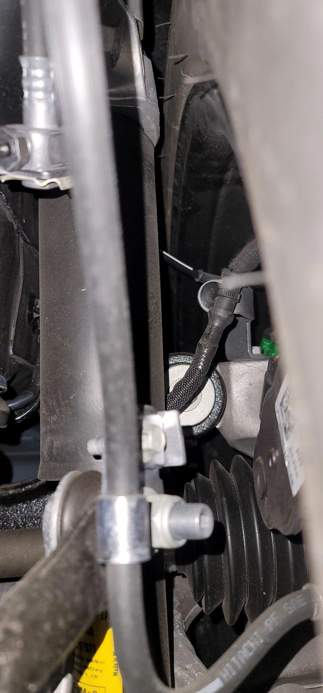

I would love to see the inner clearance to the strut on the front wheels on some of your cars if possible!
2,689
4,076
2,689
4,076
Holy smokes!
Would you say thats like 2-3mm of space there?
not sure, but i can say it's definitely less than 5mm. it seems like the most backspacing for the S650 is 6.94" front, 8.31" rear without getting recklessly close to the shock/strut
