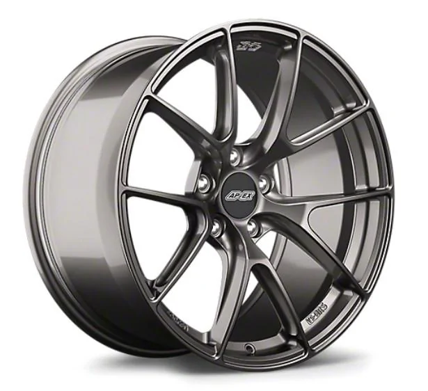

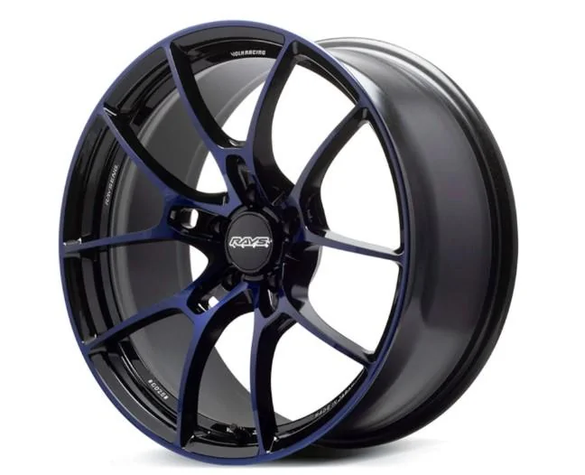

I found some silver looking APEX wheels I like and some blue VOLK wheels I like. I might just copy the Dark Horse tire sizes in hopes that I don't experience tire rub although my suspension in a non-track pack GT is probably going to be a little softer than the Dark Horse.
S650 Mustang Do we think the 19 x 11 rear wheels & tires available on the Dark Horse would fit in the rear wheel wells of a GT ? Silver Wheel
S650 Mustang Do we think the 19 x 11 rear wheels & tires available on the Dark Horse would fit in the rear wheel wells of a GT ? Blue Wheel
which volk wheels are these? have loved volks/rays since seeing them on 240's, GTR's, etc. These things are making me drool
