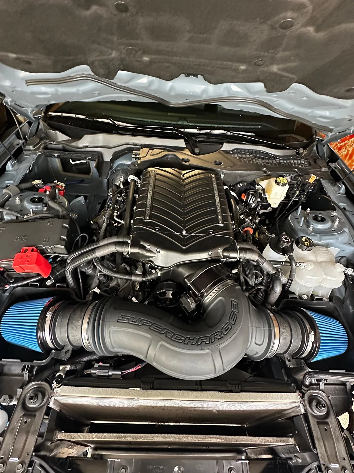

The only other issue I had was my heat exchanger brackets that mount to the posts they give you needed to be clearanced/slotted a bit.
it did take me awhile, I must be slow, did the install alone except for a 2nd set of hands to lower the blower in place.
off to do some light road testing and top fluids etc…
Have fun! You are going to be smiling ear to ear lol.
Nice. I had the same problem but I used a little mallet persuasion on the post screws so that the brackets lined up. Enjoy!

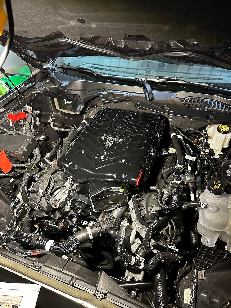

Did anyone leave the foam blocks that were under the stock manifold in place when they installed their blower? The instructions don’t say to remove them but have pictures of the valley without the blocks in later steps. I’m in the middle of installing the VMP flavor Whipple and I decided to remove the blocks. I felt like there may be some fitment issues if I left them in, but I saw some others on youtube that left them because they felt like it would reduce false knock. I’m at the point where I have the lower part of the blower installed. Just want to make sure I don’t need to pull the blower and reinstall those blocks. Thanks.
Q6543
Dec 11, 2022
1,648
2,068
Detroit
1993 fox
I left mine in. There is a bolt on the front that pulls it all together and squares everything up.
I would try to leave them specifically for possible false knock/resonance
RonBurgundy
Jun 25, 2024
Man, I hate bolt 10. Should finish up this evening or tomorrow.
I accidentally hit the bypass actuator with my hand when I put the lid on. Hoping I didn't damage the diaphragm.
ETA: I did end up pulling the bottom portion of the blower off to reinstall the foam blocks. While it was out I went ahead and put the o-ring and silicon tubing in. If you follow the instructions it has you install the o-ring and silicone tubing while the bottom half of the head unit is installed, which would be a bigger pain than it needs to be.
