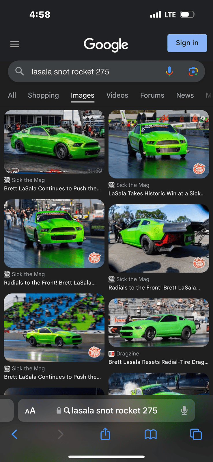

oh, I thought you were changing compound….
street tires aren’t gonna help much for you then.
going wider won’t normally do anything, it’s the tire compound that makes all the difference
the fastest s550 mustang on earth runs a 275 out back.
im curious to see what/where this info is from, everything i see is 6 second cars running drag radials well above 275 and the fastest stock S550 GT500 runs 315s in the rear.
Snot rocket is on a 275
S650 Mustang Did you notice an improved 0 - 60 time after switching to wider / stickier tires? IMG_1728
