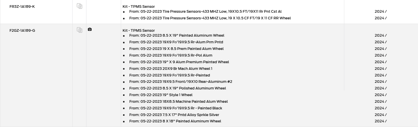

Wondering if you can have two sets of wheels and tire’s programmed at same time. Also are the motorcraft sensors pre programmed., is correct sensor part no F2GZ1A189G

Apparently there is a different part # if you have Magneride vs standard suspension?
JediMindTrix
Aug 9, 2023
198
220
S650 GT 401A (NP, PP, MR, AE, 10R80)
I’m not sure if a new PN was created since I’ve worked at Ford last but @roket’s picture of the TPMS #’s was correct at the time of launch.
S650 Mustang Can you have two sets of wheels and tires TPMS programmed at same time? IMG_2484
