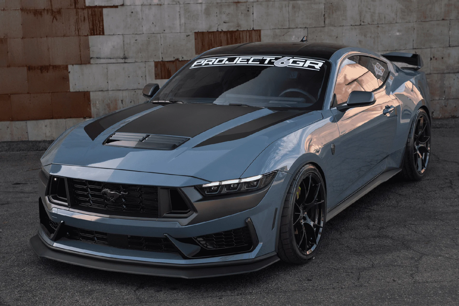

I have the DH with a second set of rims and tires.
305/30/20 squared. I'm looking to go wider with my next set. Wondering what the widest I could get on the front without any issues?
What are you guys running on your mustangs?

Hey Jay this is Junior from P6GR, we did this dark horse in a 20x11 305/30 front, 20x11.5 315/30 rear. You can do the same on a 19" wheel setup. We have a couple different sizing options for Dark Horse. If you have any more questions feel free to reach out!

Hi, Do you know if you go wider with out rubbing in the front? The setup you mention is tight on the rims 20x11 305/30/20

wider than 305 up front will rubb

i run 325/30R19 front but get some rubbing at wheel lock, so 315 will probably have no issues. when i had a Mach 1, i ran 315 fronts and never had any issues

Thanks, did u like the look? I have the HP so my car may sit a little lower but idk tbh. Also I have 20s.

I liked it a lot, my DH has the HP and my Mach 1 had the HP too. 315/25R20 is pretty equal in size to 315/30R19

Dude, awesome! DH is the jam for sure. What are you running on the rears?

Wow that is wild. how does the car handle?
should note i'm running an aftermarket set of wheels, 19x11F, 19x12R. it handles really well. i can launch from a dead stop with no wheelspin, i've seen peak lateral Gs around 1.21G (probably tops out at that from the compound of the Pilot Sport 4S), and during autocross i'm usually setting times only a couple seconds slower than the likes of the Porsche 911 GT3RS and Cayman GT4RS when they're using Pilot Sport Cup 2Rs and some racing Bridgestone tire
