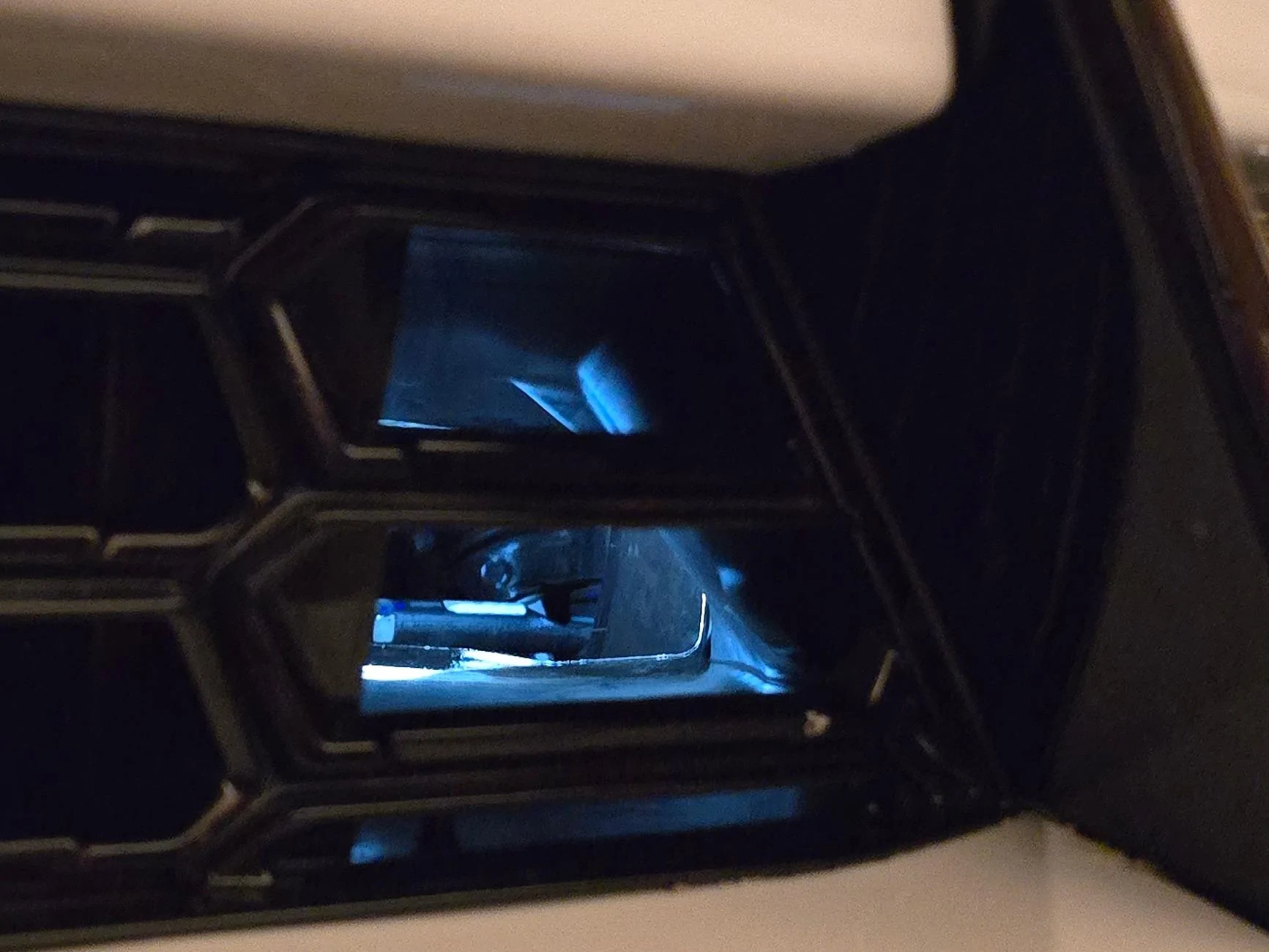

I don't know that you'd be able to put them on a PP but I can tell you the DH ducts are on the outside edges of the lower grill. The outer driver's side is for the oil cooler and the passenger side is blocked off.
S650 Mustang DarkHorse front brake ducts in a GT 5.0 PP? 20240712_223124
S650 Mustang DarkHorse front brake ducts in a GT 5.0 PP? 20240712_223135

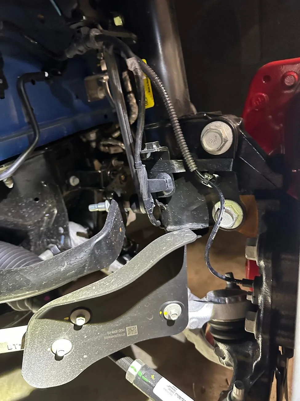

I have a PP Mustang and it has the brake ducts and what some call diverters. It also has an oil cooler which requires venting through the inner fender well.
The strakes/diverters are shipped in the trunk and dealer installed when car arrives.

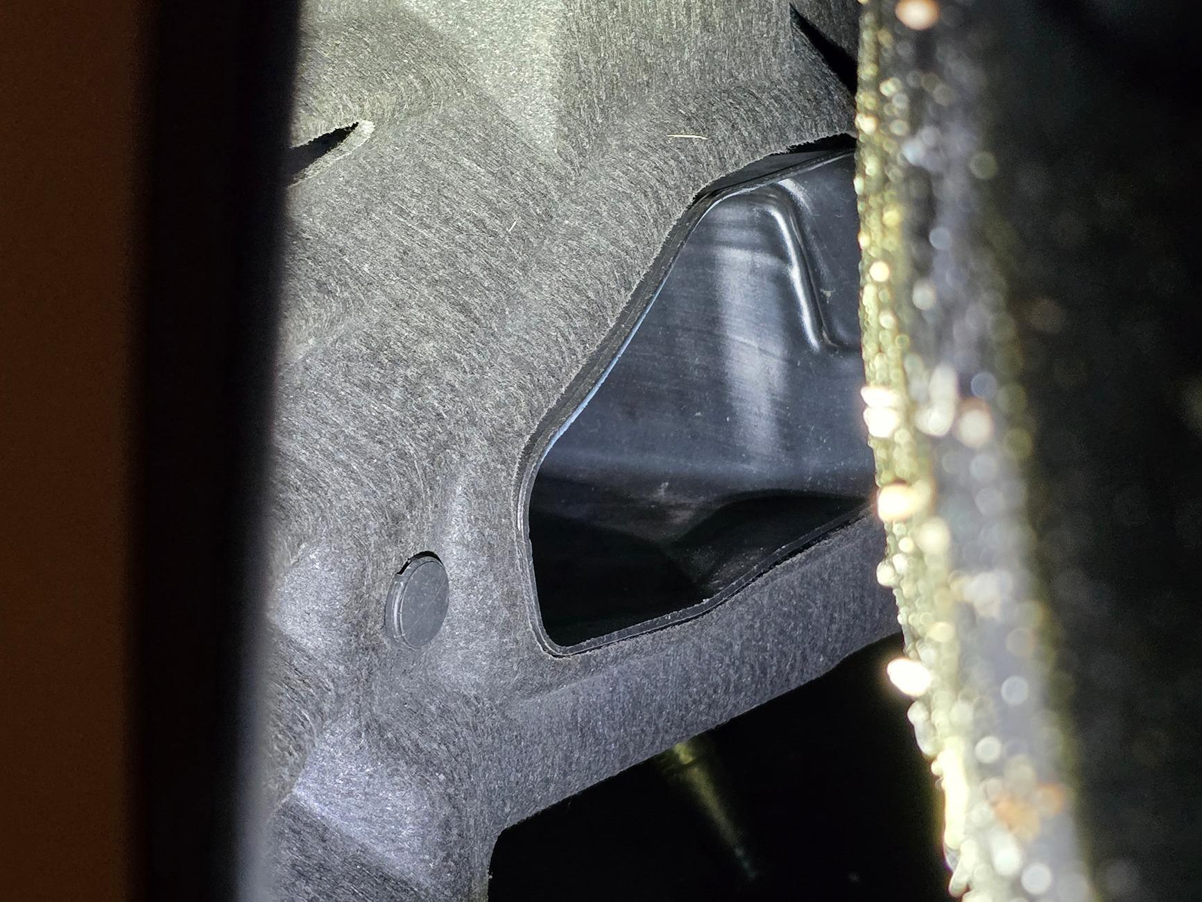

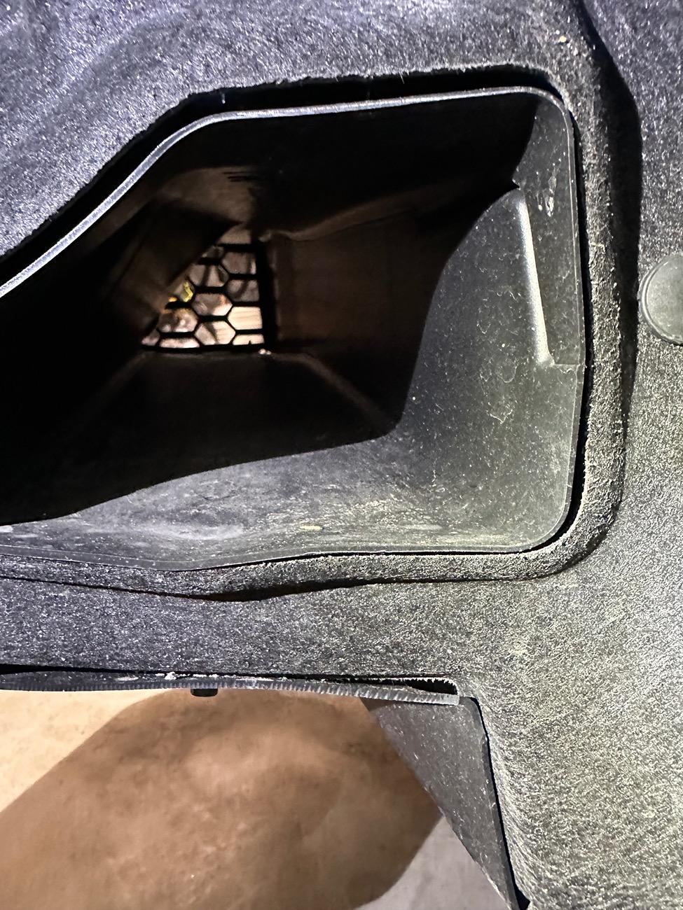

Maybe I’m misunderstanding what you’re asking about. My PP GT has ducts from the corners of the lower grill that are wide open to to wheel well and point directly at the deflectors on the lower control arms to direct air at the back of the rotor.

I may have been misinformed about the ducts in the GT PP, guess I'll have to wait until the car shows up to see if the ducts are there.
