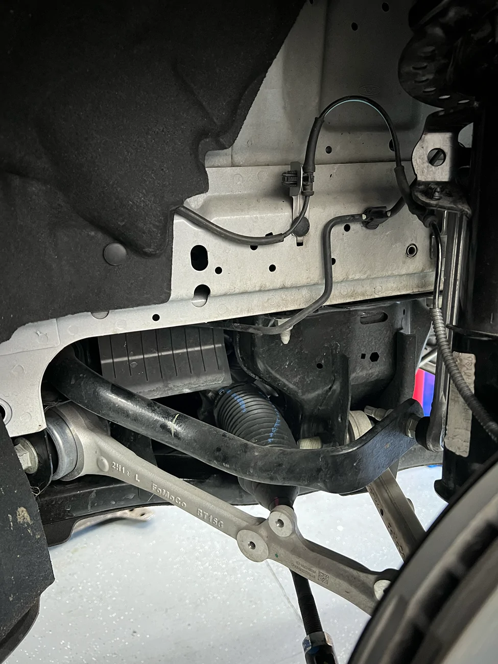

MustangNoob
Apr 11, 2024
219
209
CA
Mustang GT
this is a photo of a base GT. Can you install the defector kit https://www.steeda.com/steeda-555-6003-s550-brake-deflector ? It seems that the arms already have the mounting points. Will that work without opening any air ducts? I expect some air will be caught and redirected towards the brakes?
Also what the thing right above the sway bar (it has 8 "ridges") ?
