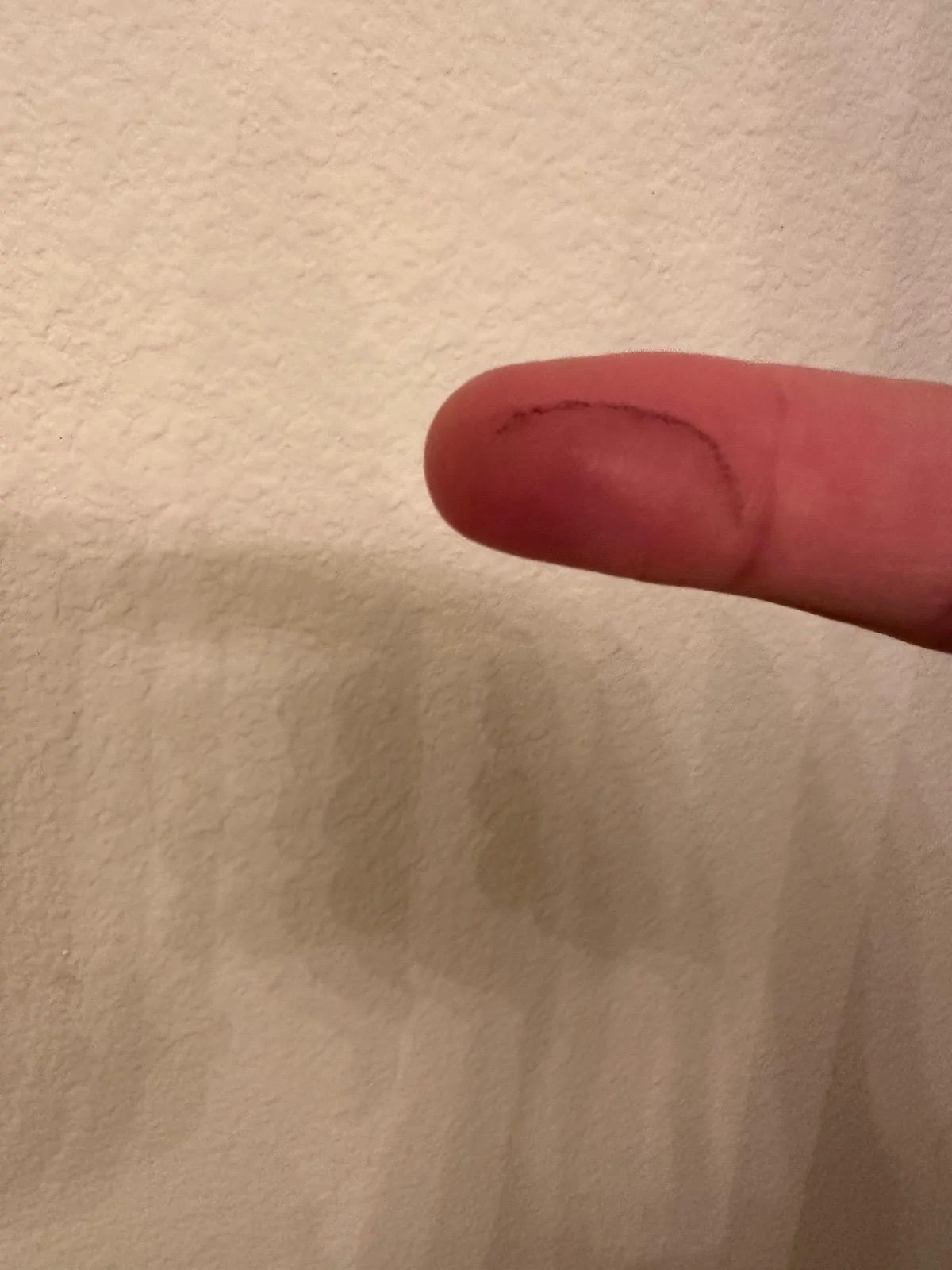

I wash my car almost weekly so I don’t notice a lot of brake dust. However, we just put almost 300 miles on the car and the rims barely have any dust on them. How long are you guys driving before washing your car? These stock pads put off less dust than most cars I’ve had. This is off the front wheel.
edit: I don’t have the PP option
