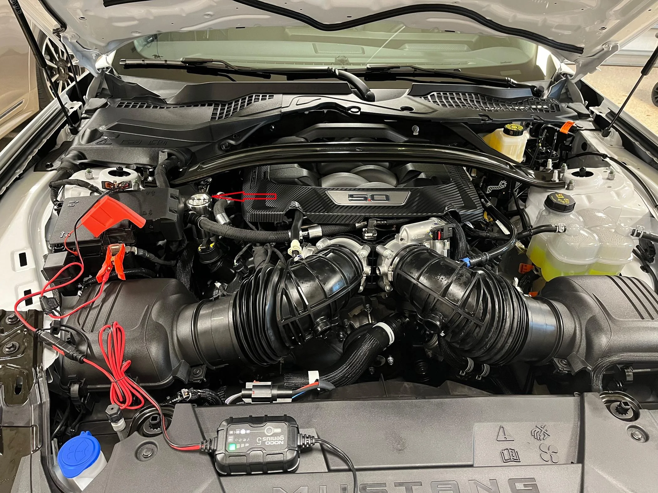

I realize the space in the engine compartment is "TIGHT", but how do you recommend removing the can for checking/emptying? I can't get my hand in there to unscrew the can itself. I am thinking I am going to need to disconnect the hoses and the top knob and remove the entire assembly.
Did I not install the can per the instructions? (See attached picture)

To remove the UPR Catch Can from below the Mustang S650 strut tower brace, you release both UPR plug-n-play catch can fittings and then unscrew the quick-release knob, and you are all set. This should take a few minutes, and if you have any pressure on the hose, loosen the quick-release knob to eliminate any pressure on the lines when releasing the UPR-plug-n-play fittings.
Here you go. Everything looks good on your installation.

I check mine about every 1k miles and it usually has around a tablespoon of oil in the can. Like previously said, check it more frequently at first to see how much oil you collect. That strut tower brace does make it a little bit more of a pain, for sure.
