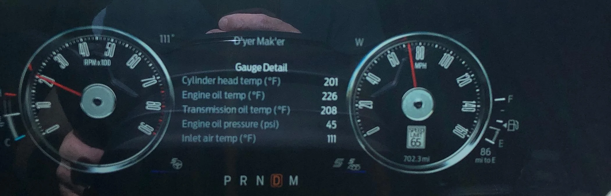

I live in AZ and temps have been upper 100’s this past week. Curious what the opinion is on higher viscosity. Here is pic of temps the other day when I was running around. It hit 115 before day’s end. I didn’t see a dramatic drop in oil pressure. My GT has just over 800 miles on it.

Thanks for the pics. I will compare to mine in Central FL with temps in the mid-nineties. I also love your signature. I'm 77!

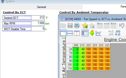

I trolled several threads on the topic. Some involving street driving in the south. Others, when people track.
Like any oil thread, there is no consensus. Some continue to use 5W-30, others 0W-40, 10W-40 or 15W-50. You name it. It's all over the place.
The 2024 Owners Manual says 5W-30 can continue to be used up to an air temperature of 104F / 40C.
An additional factor to consider is Cylinder Head Temperature, when and how many cooling fans are operating.
Most drivers are using their A/C at these temps. At least one cooling fan will run when the A/C is turned on.
If A/C isn't used, the attached highlights when Gen3 fans kick in. 212F for the initial fan, 223F for both.
Finally, internal engine tolerances need to be taken into consideration if changing weights.
