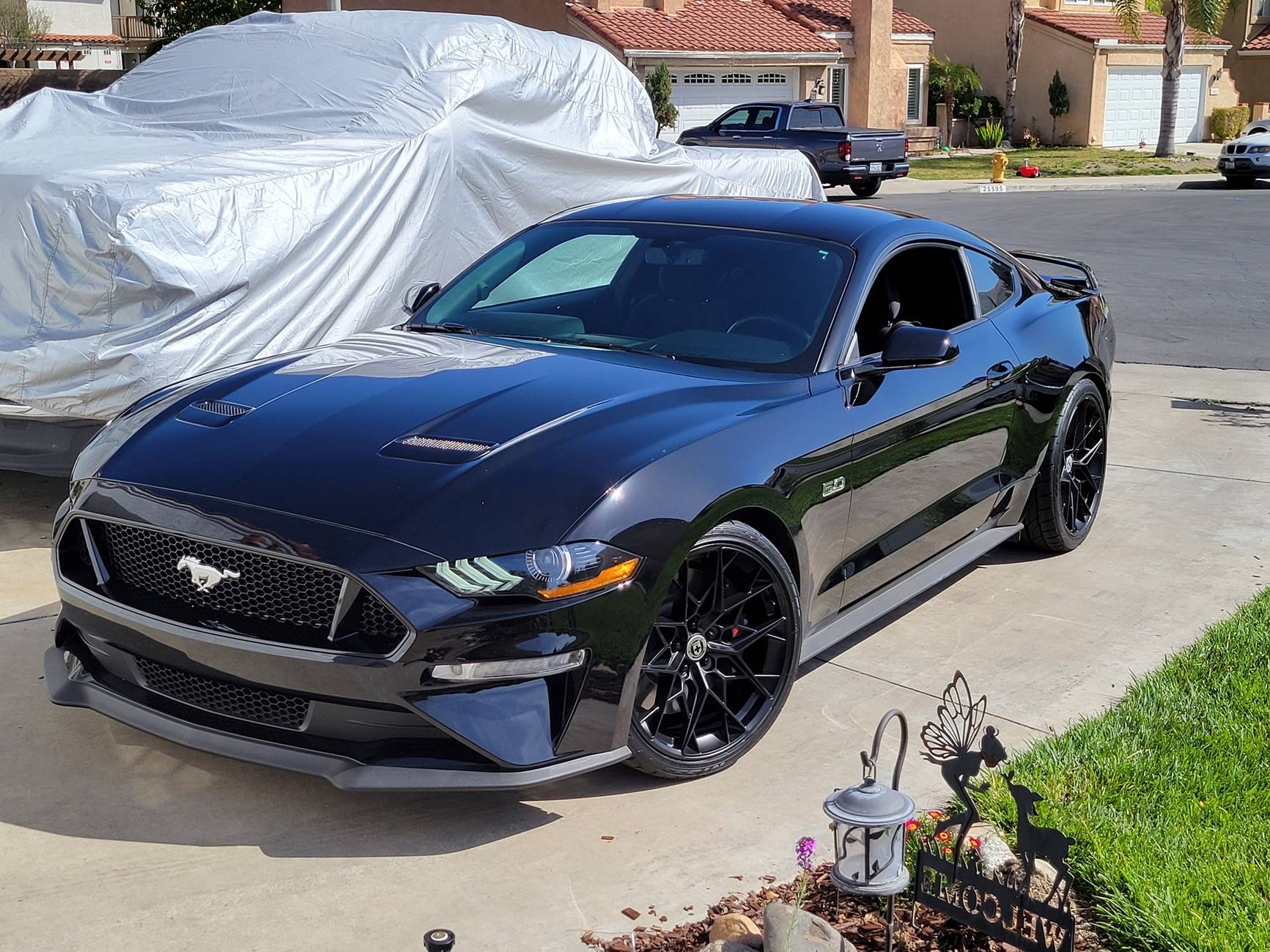

I’m in the tune in camp … also I added HRE wheels and suspension mods to my S550 PP1… the lighter wheels made a nice difference in feedback
