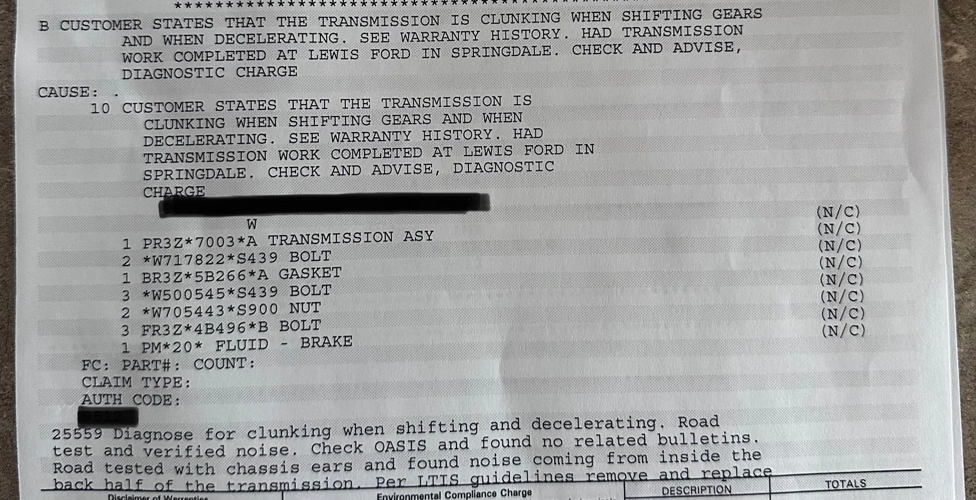

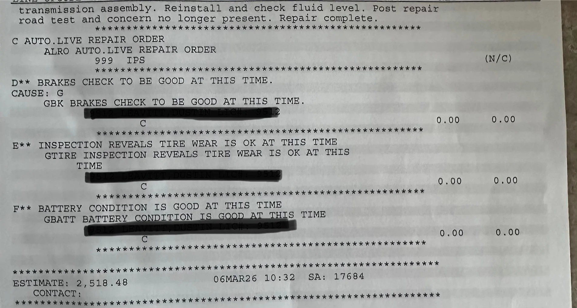

Just an update for anyone who may come across this in the future: the new dealer I took the car to verified the noise on their test drive and they used some kind of automotive stethoscope tool to pinpoint the exact location of the noise. They stated it was coming from "the back half of the transmission." The solution was to replace the entire unit (under warranty of course). Got the car back today and the shifts are noise-free and buttery smooth, which is how I remember my 2016 Ecoboost and 2018 GT being. I guess the car just came with a faulty MT82 unit from the factory.

Id love more context to this. The back half of the transmission usually means output shaft, which would make sense. Are you saying they replaced the entire transmission? Because that seems like major overkill and usually the dealers will opt for a rebuild instead.
Stuck at work still but when I get home I will pull the paperwork I was given from the dealer and get back with you.

Alright I’ve taken pictures of the invoice I was given when I picked up my car earlier. Blacked out the tech’s name and license number and cropped out my personal information from the top. Let me know what yall think.
S650 Mustang Clunking underneath car after blipping throttle & shifting gears (MT82) IMG_8223
S650 Mustang Clunking underneath car after blipping throttle & shifting gears (MT82) IMG_8224
