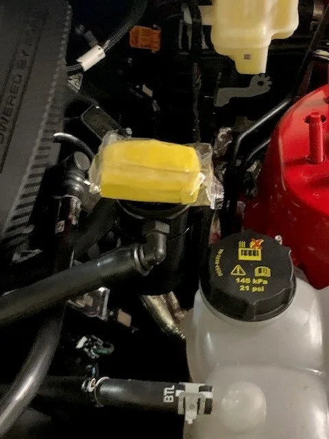

I bought J&L but noticed it touches the hood liner when i close the hood. I'm returning it, and buying UPR instead. I couldn't justify the 3x cost of FP kit.

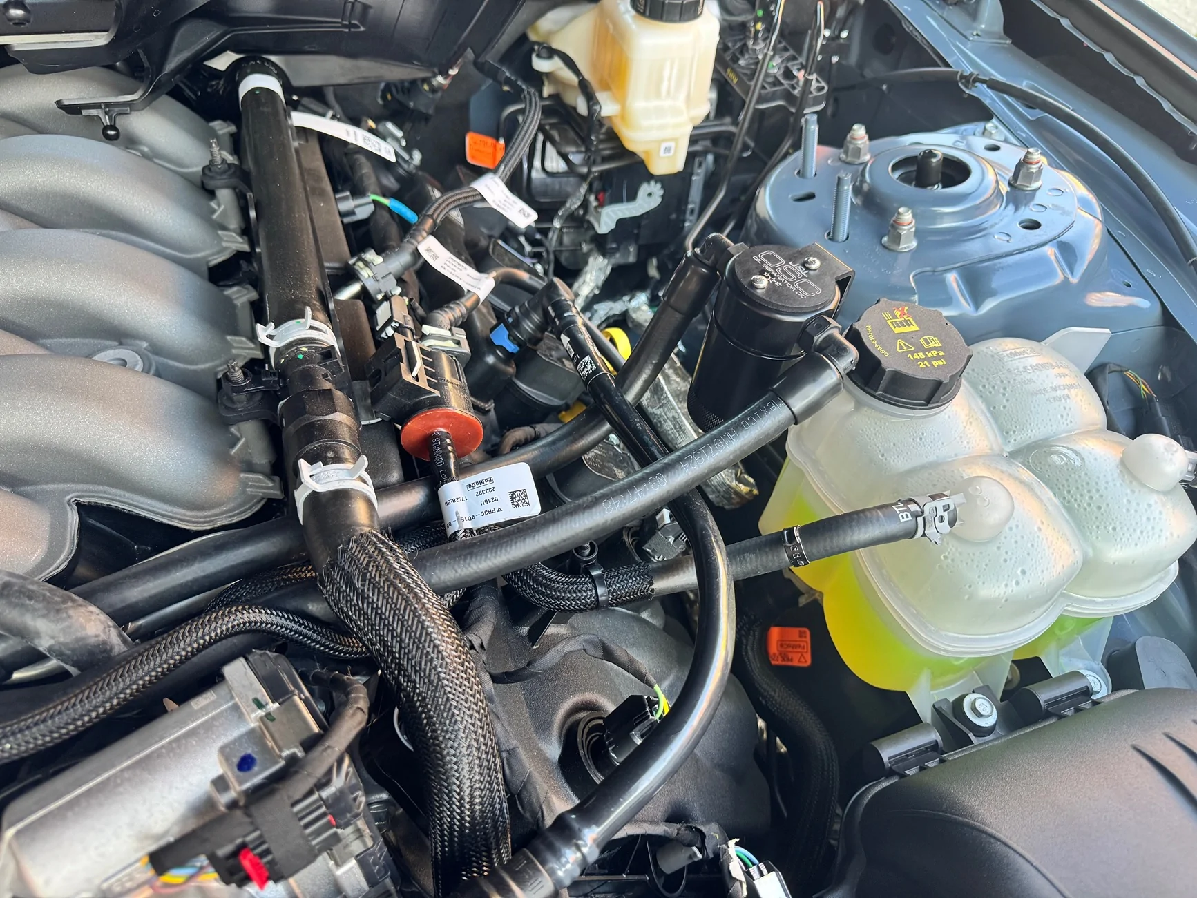

Doesn't touch my hood liner, not even close.

Don’t know why. I placed a tiny claybar on top just to make sure, closed the hood opened again and it was squished.
Hard to tell from this angle, but is the top of the can higher than the radiator overflow container cap or the strut tower posts/studs?
Yes it is, about 1/2 to 3/4 inches higher than the radiator cap; that's what made me test for contact. I saw one guy on youtube complaining about the same issue I had.

J&L Catch Can with clay bar on top of catch can. No marks on clay bar or hood liner. Other poster has a 2024, I have a 2025 Mustang.
