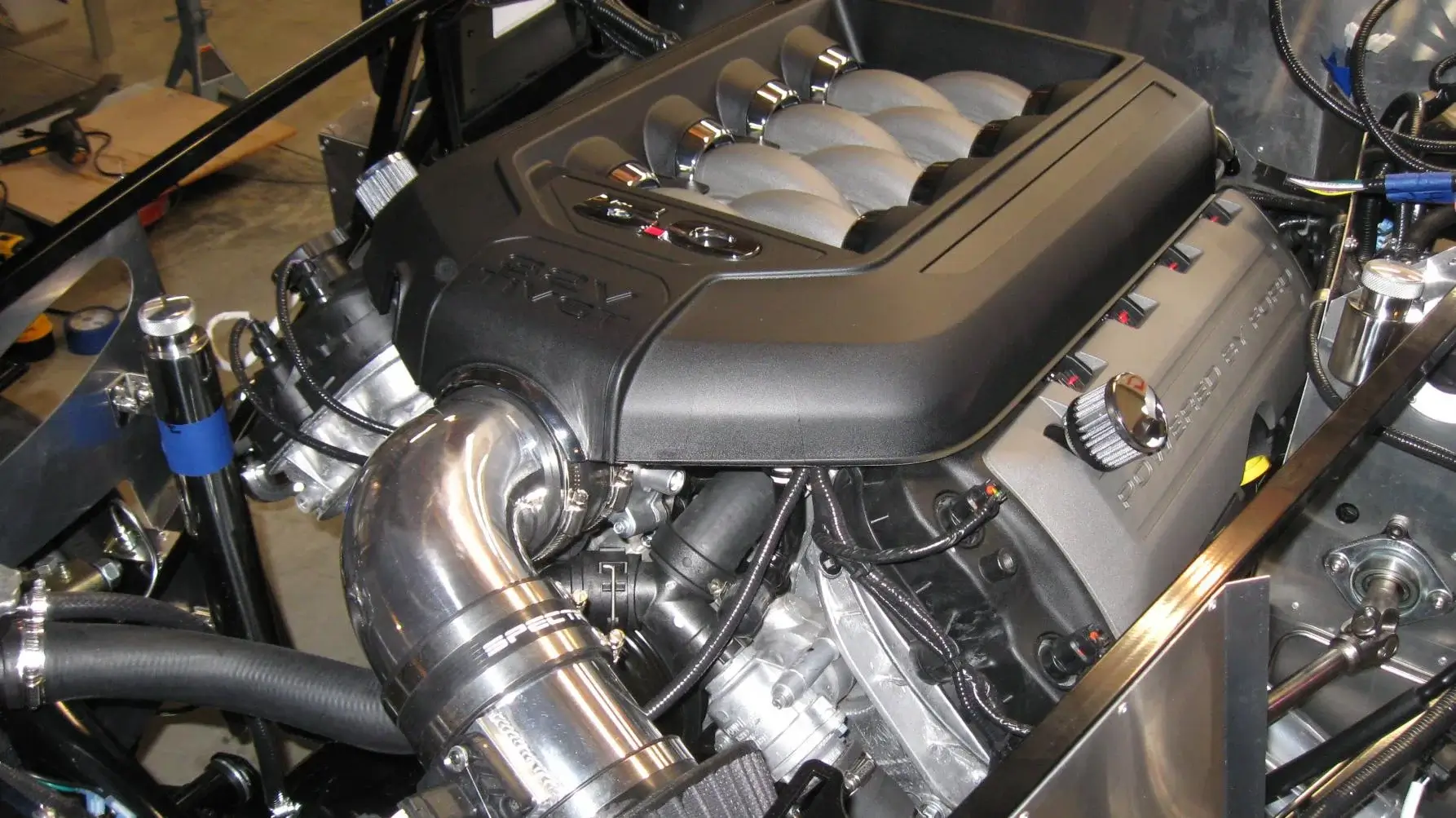

If lack of a catch can really causes a carbon build up on the back of the intake valves, then we could just install breathers on the valve covers like everybody did back in the 60s, 70s, 80s and into the 90s on our older cars to relieve the pressure and let condensation go to the atmosphere. Much simpler. Isolates these fumes and their "gunk" entirely from the intake.
The PCV is an emissions thing, like catalytic converters.

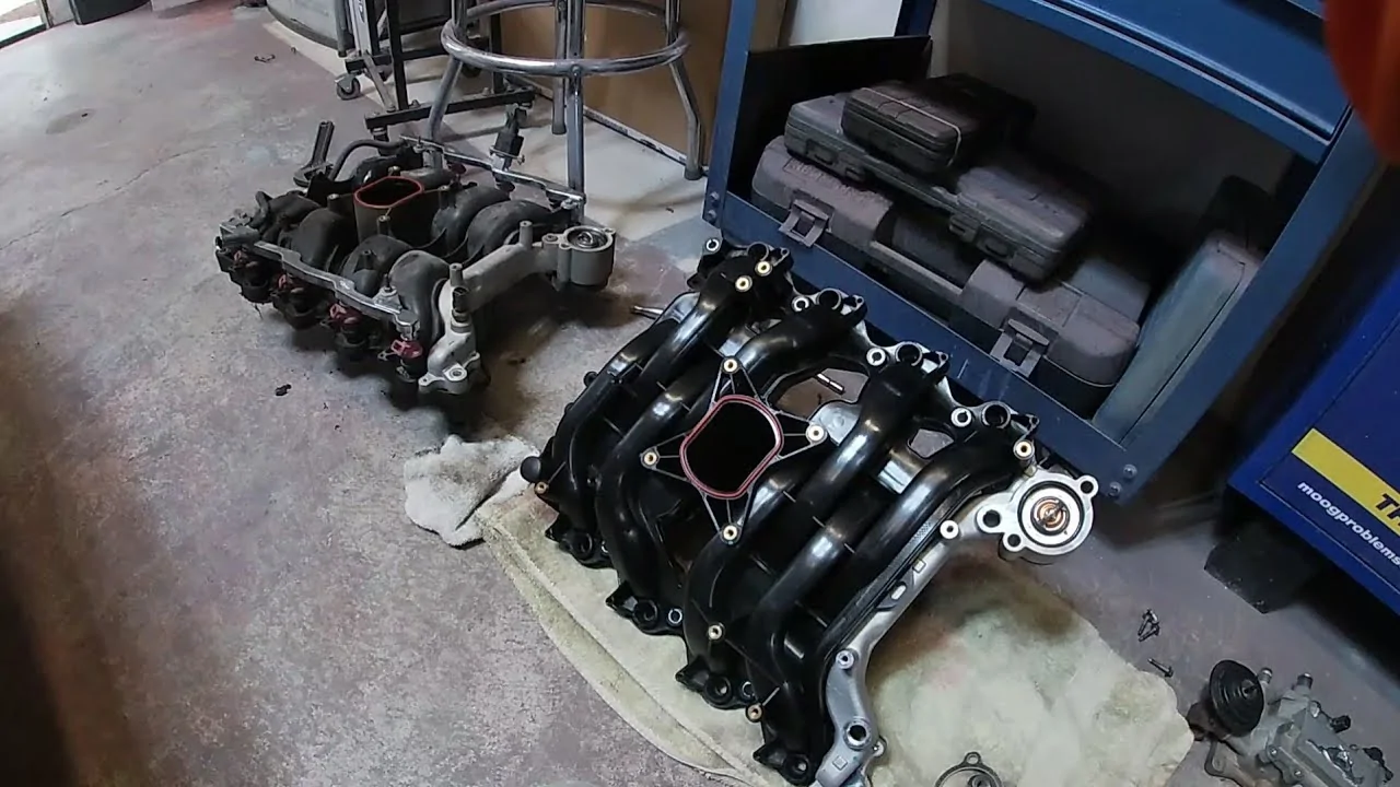

As in if it does do more than produce condensation sludge where are all of the images that show
this:
S650 Mustang Catch Cans - Do They Really Do Anything Beneficial? IMG_4801
to that:
S650 Mustang Catch Cans - Do They Really Do Anything Beneficial? IMG_4800

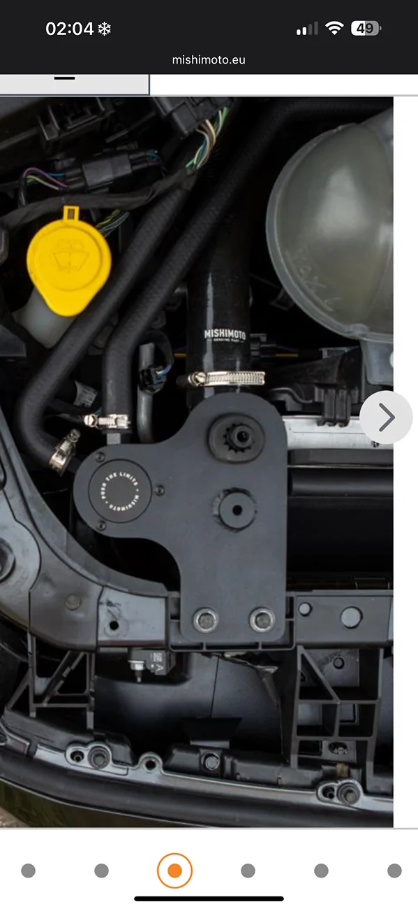

No DTC (codes) at all, i used the Mischimoto catchcan, clean and easy install on passenger side on a GT 2021.
