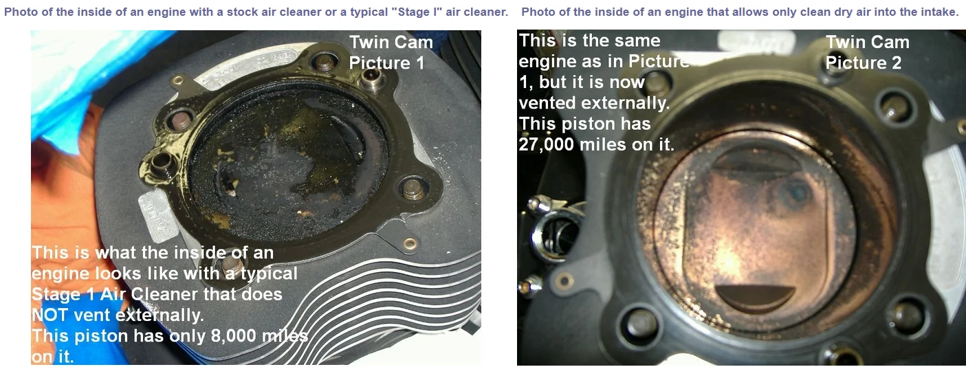

Here is what is shown in the Harley world. I'm just showing this, not suggesting anything or making any conclusions. Pic 2 would be "catch can" use.
S650 Mustang Catch Cans - Do They Really Do Anything Beneficial? 1755789241084-z

Another vote for "nasty looking crud" or "gunk," but what is this, and is it harmful to be going into the engine?
Posting that something is in the catch can does not mean that the catch can is doing something beneficial.
Again, I am not arguing with you. I am not even disputing the point you made. There is nasty looking crud in the can. This does not, however, answer the question, Catch Cans - Do They Really Do Anything Beneficial?
I am starting to think that there is no evidence out there, as opposed to suppositions and marketing. Hopefully, I am wrong, and there is evidence out there one way or the other.

The intended benefit is to prevent carbon buildup on the back of the intake valves.
Is this a problem on the S650 Mustang Coyote engine (this subforum) which still has port injection in addition to direct injection?
If it is a problem, does installing an expensive, high quality catch can make a difference in the amount of carbon build up?
If it does make a difference, how much of a difference does it make? Is it significant, and, if so, how is it significant? In other word, what difference does it make for me in practical terms for my 5.0 engine? Horsepower? Longevity? What?

Everything I can find on the internet that even pretends to be looking empirically at the issue basically concludes, "Look! There is 'stuff' in the catch can!"
That is not evidence that it is beneficial to the engine.

As in, run two cars, one with a catch can and one without, and then do this? What is your hypothesis to be tested? What do you expect to find? Does whatever we are wiping end up as carbon deposits on the back of the intake valves?
Why the mention in the track use section of the manual if no benefit?
This is sort of asking me the same question I am asking. Is there a benefit? I do not think that the argument premise "catch cans are mentioned in the owner's manual" leads inexorably to the conclusion that "there is a benefit," and, if it did lead to that conclusion, we should still want to know what that benefit is and what the evidence is supporting that benefit, wouldn't we?

It’s called vapor residue, akin to a smokers house. Aftertime simply moving a picture exhibits the collection of residue. Short term not noticeable long term quite evident.
