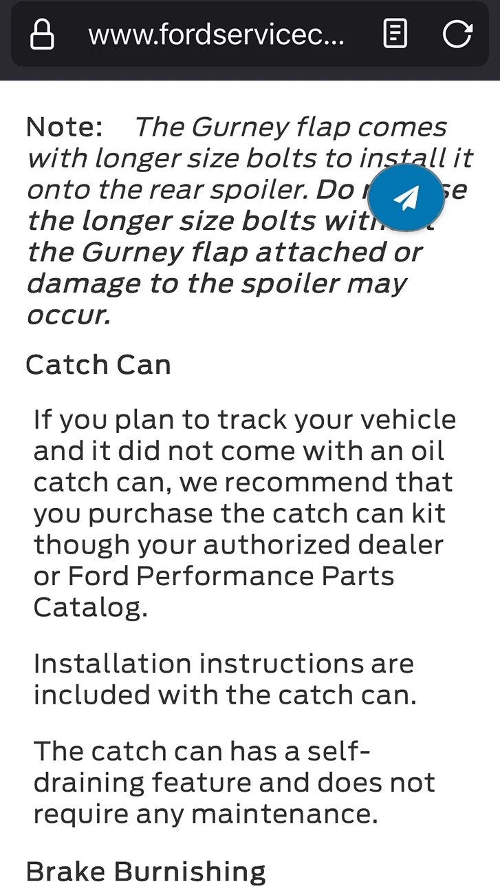

Well Ford recommends them for some conditions in the owners manual. Like anything else, it’s a tradeoff.
S650 Mustang Catch Can IMG_2156
Disregard the self draining feature that’s a misprint from the GT500.

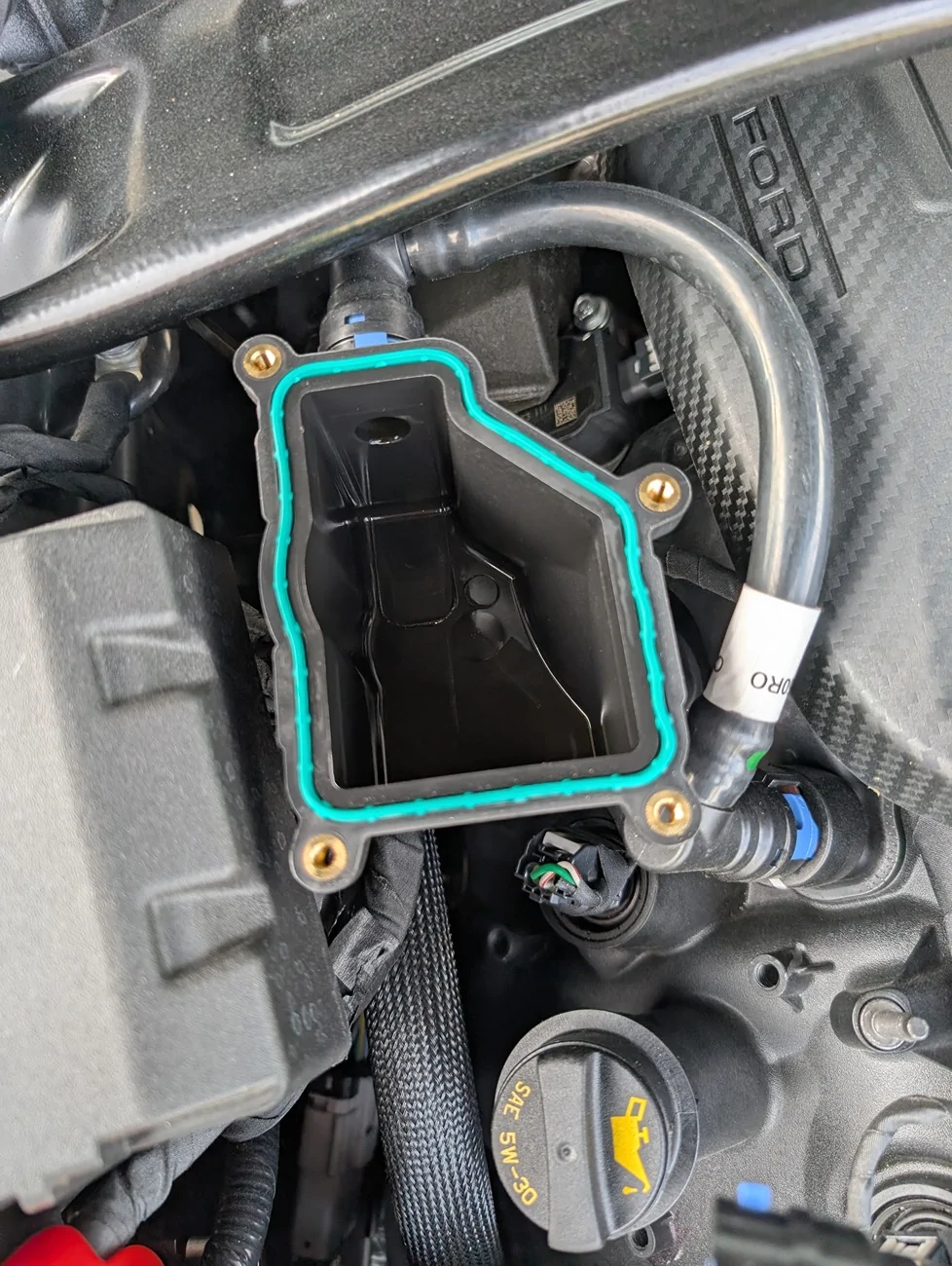

I have the Ford Performance air/oil separators on my 25. I installed them at around 1000 miles and just for fun I checked them at around 1300 miles and there was a little bit in the passenger side and none on the driver side.

Why did you get 2 AOS? Is it because of the dual intakes?

It's just the Ford Performance version. It comes with two cans. It's probably why it is so much more expensive than the others
