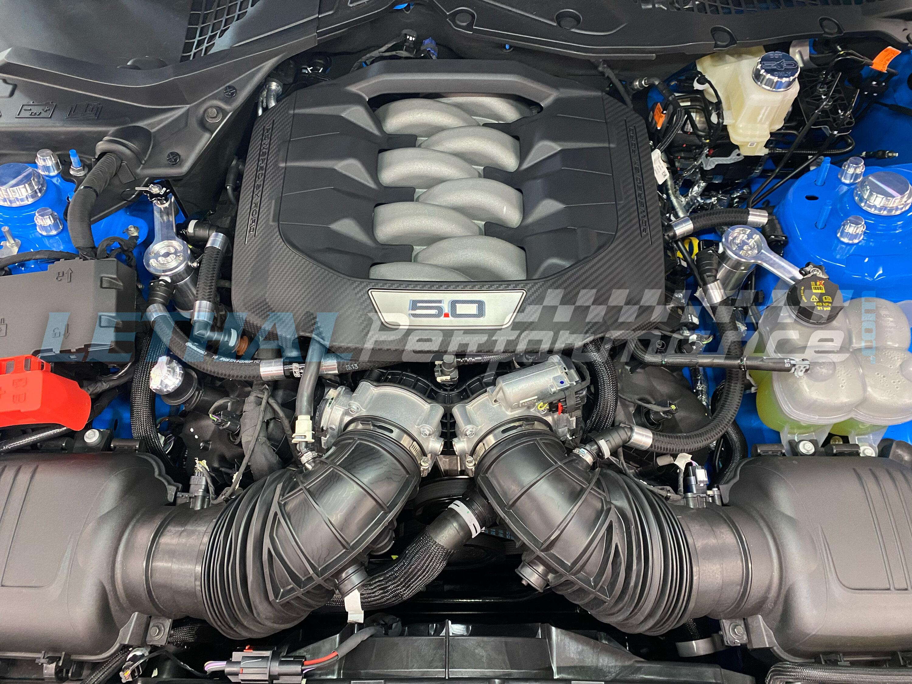

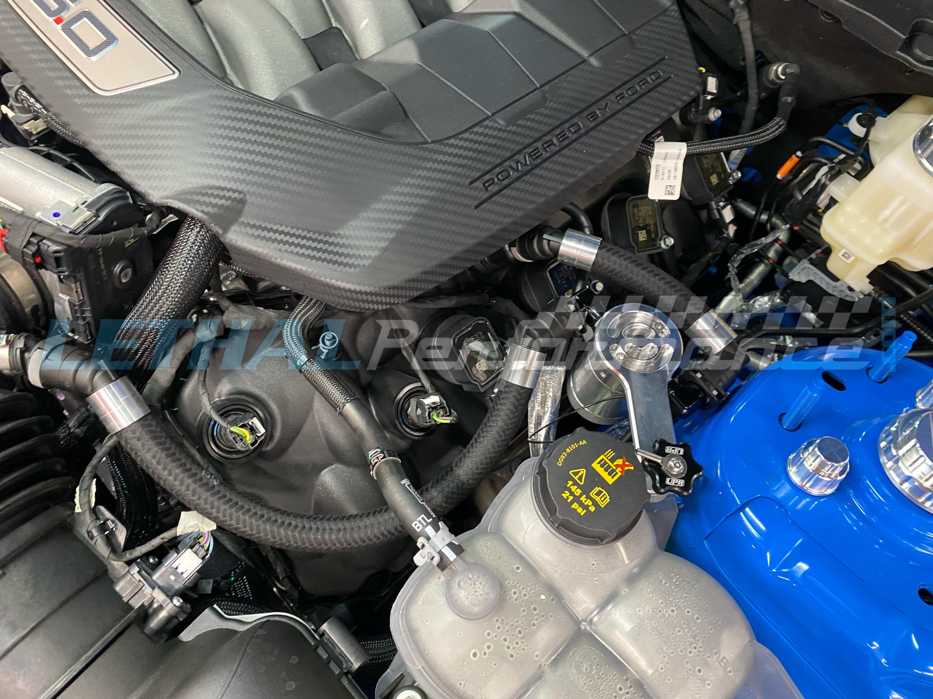

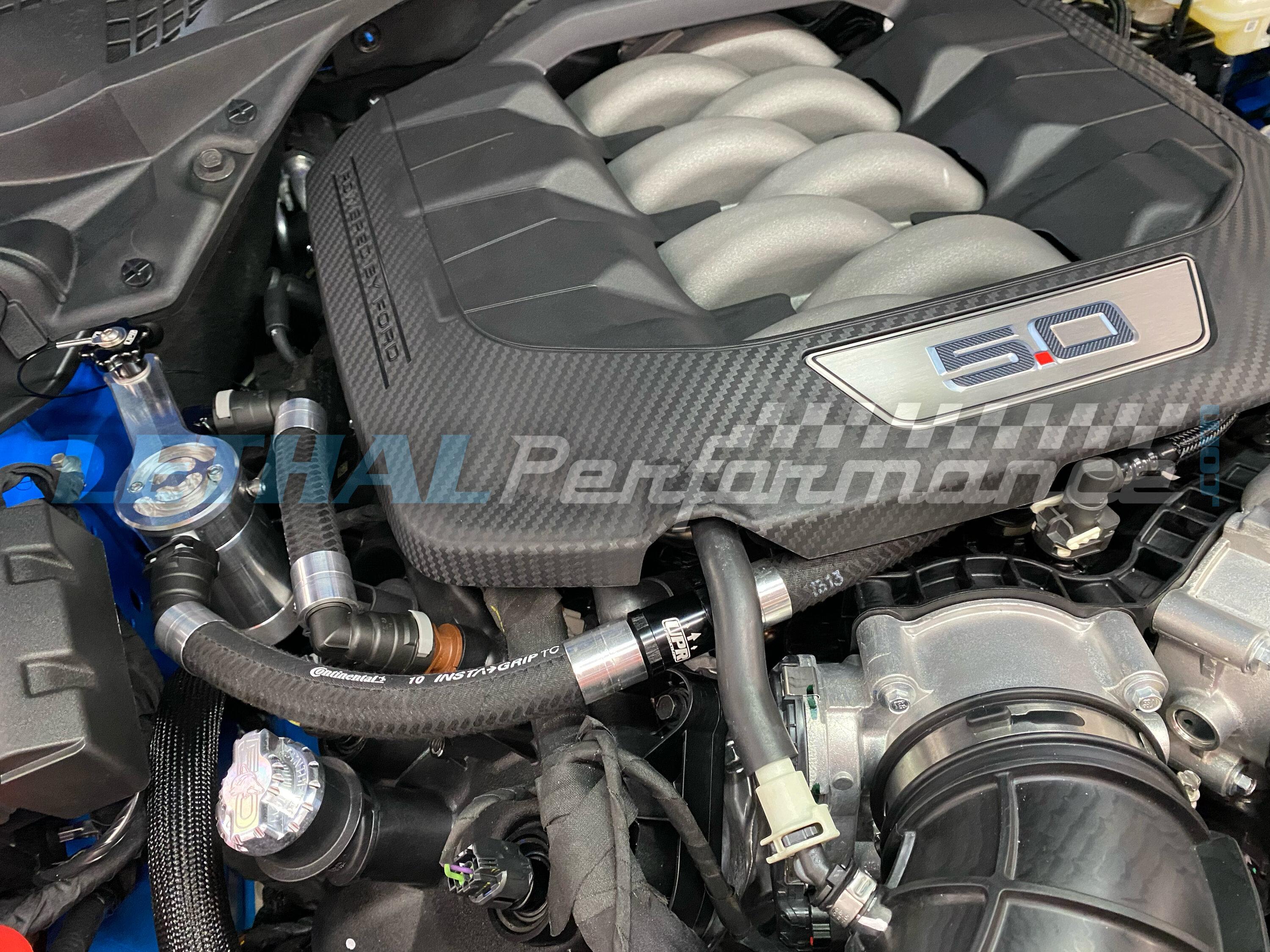

Here's a few pics of the kit installed on our car. We will be replacing the clear cans with black anodized ones once the new mounting brackets come back from the anodizer.
We'll have these listed up on the site shortly and post the video of all the content once it's been edited.

Just above the throttle body, is that a check valve on the passenger side line returning to the manifold?
Yes that is a check valve. Really not necessary on an NA setup but has no negatives to it being installed. UPR installed it on the car for fitment purposes in hopes that when the centrifugal blower kits come out for the car that this setup will work perfectly for it.

So is there an advantage to doing both side with catch cans, I assume cleaner? Seeing this setup versus the new J&L, is it possible to y the hoses to only use one catch can? Basically having 2 intakes and 2 outs from one can?

The twin TBs have no effect as to whether or not what 2 cans are needed. They still share a common plenum.
The engine has a PCV (dirty) side and a CCV (crankcase vent - fresh air/clean) side. The driver side (clean side) primarily draws fresh air into the crankcase from the air filter/ cold air kit/ air box connection to help flush out fumes that are drawn out by the PCV side which is connected to the intake manifold vacuum fitting.
When the car is run at WOT for long periods or if it is boosted oil can be pushed out of the driver side by crankcase pressure.
Normally, we’d use a UPR Clean Side Separator like we have for previous generations of the Coyote, but there isn’t room for one with the engine cover in place on the 2024. By using a small driver side can, we keep the engine cover in place and still protect the intake tube from oil splash out of the driver side.

...We will be replacing the clear cans with black anodized ones once the new mounting brackets come back from the anodizer.
It's a shame the reservoir can isn't actually clear.
You could see how much oil is it has actually collected, and would provide a visual cue to empty/drain it.
This feature alone would help differentiate it between the many other cans on the market.
