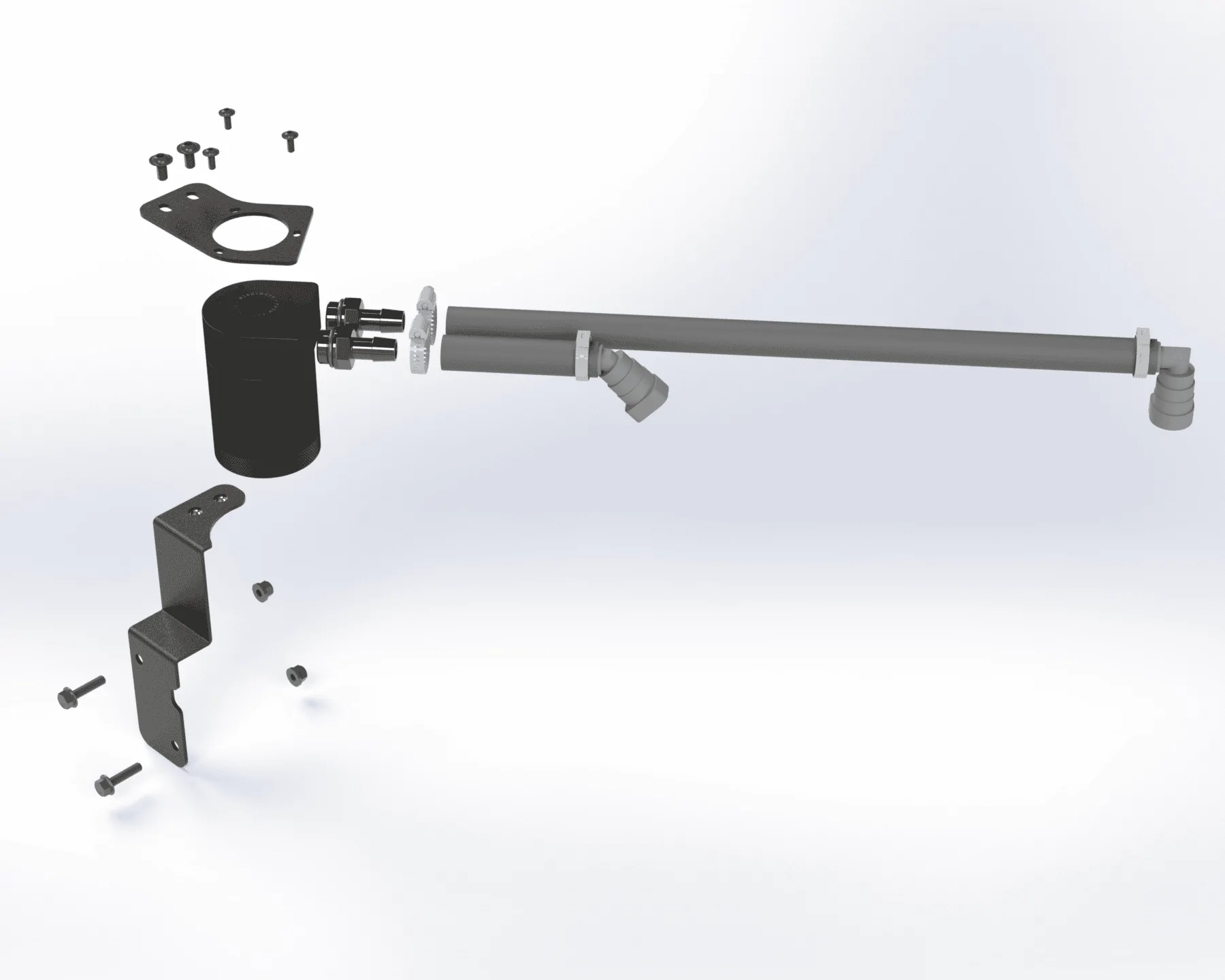

From the start, we wanted our catch can to be both effective and easy to service. We incorporated our existing Mishimoto V2 Compact 2-Port Baffled Catch Can, a tried-and-true design that uses a 50-micron bronze filter and internal air diverter to improve oil separation. We designed our new kit to be a direct fit for the 2024+ Mustang 5.0L V8 with a two-piece bracket for quick servicing.
S650 Mustang Mishimoto 2024+ Mustang GT Catch Can Kit R&D MMBCC-MUS8-24 Exploded 3D Model

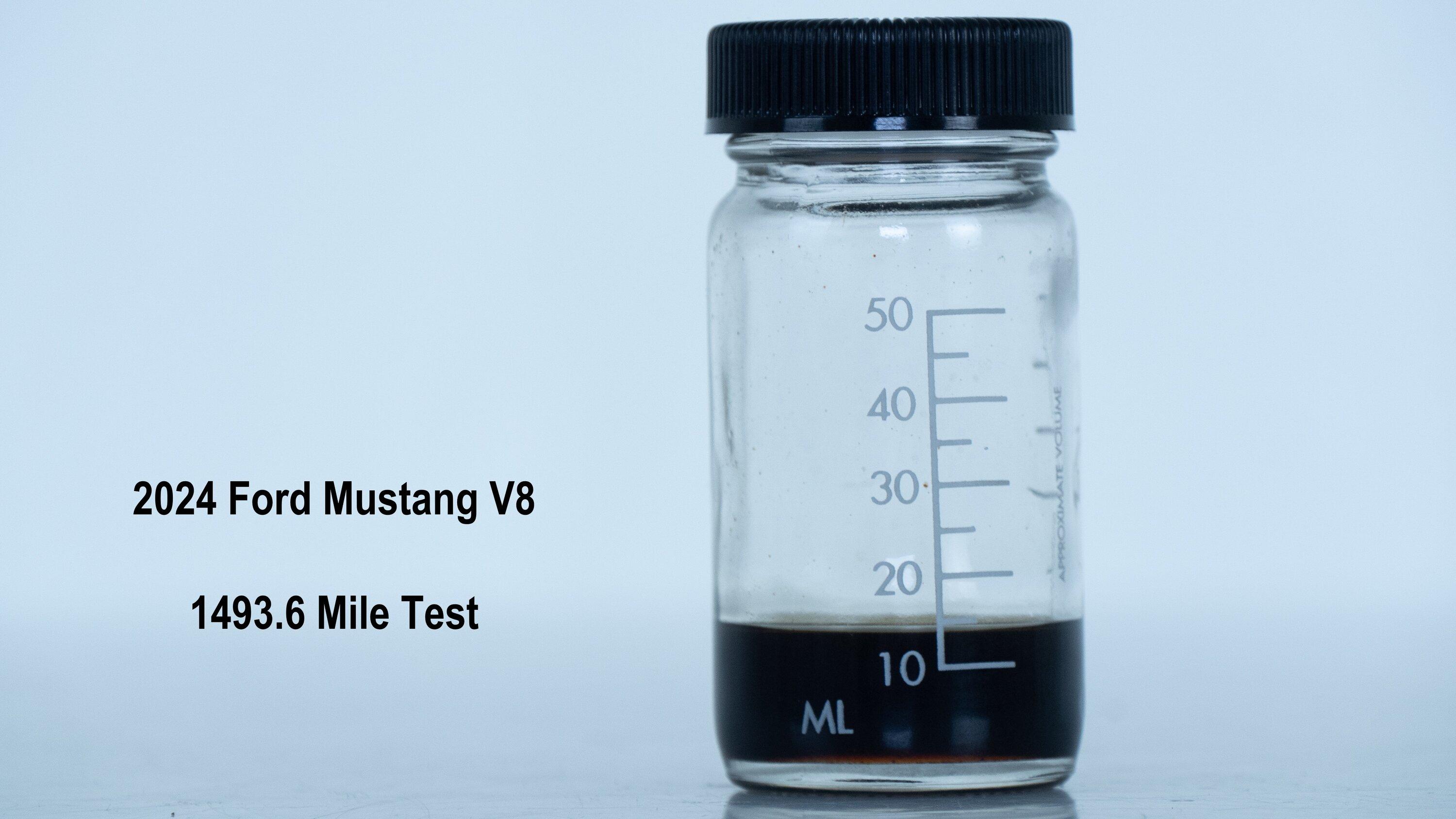

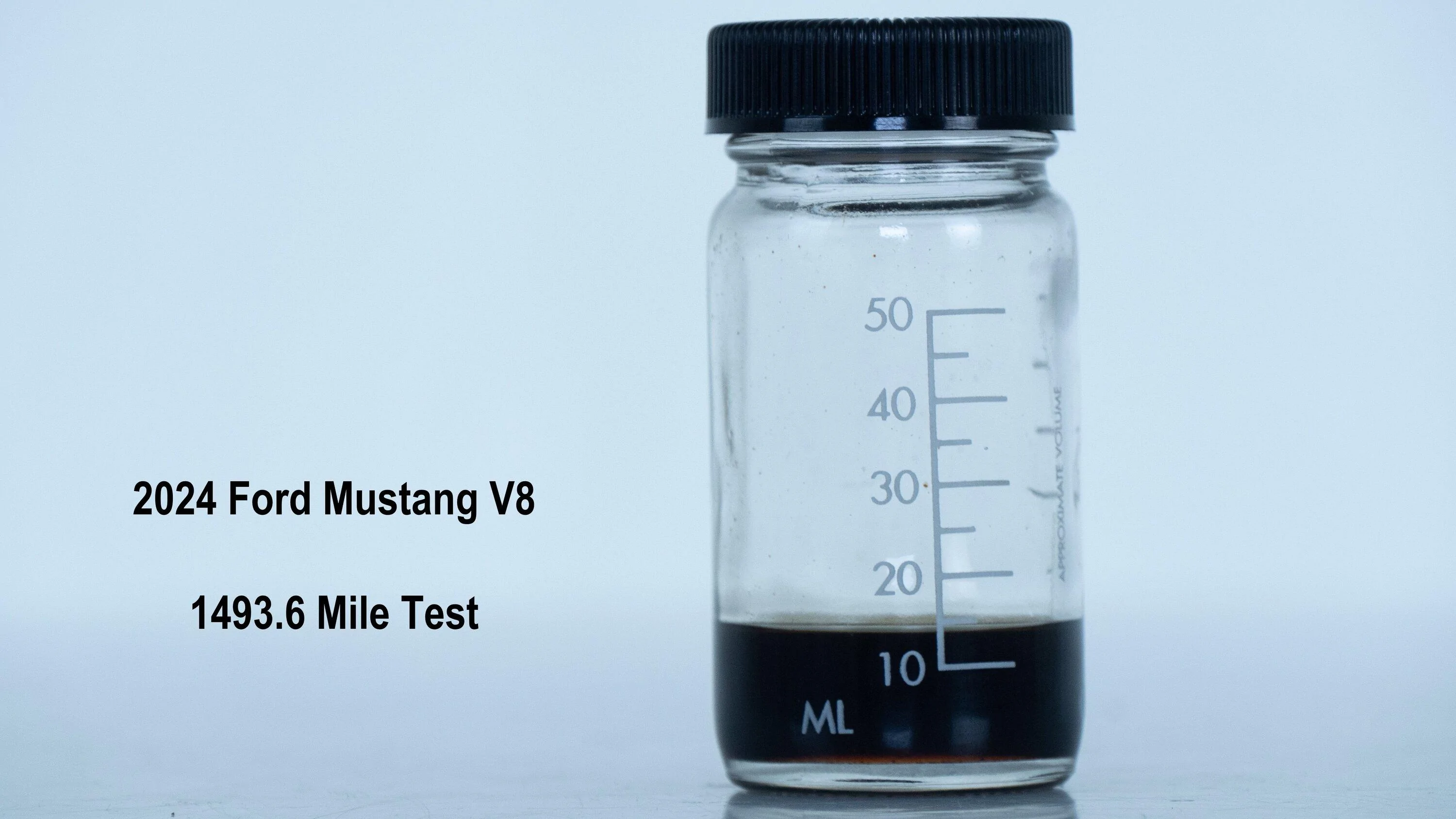

After test-fitting some prototypes we sent the catch can out for a 1,400+ mile road test. Since the Coyote engines are known to produce excessive blow-by, we were expecting our catch can to collect an ample amount, but we were surprised at just how much. After the 1,493.6 mile road test with a total lifetime mileage of only 6,558 miles, we measured 15mL of blow-by collected.
S650 Mustang Mishimoto 2024+ Mustang GT Catch Can Kit R&D MMBCC-MUS8-24 _Blow-by_ Labeled

@Mishimoto Is this driver side or passenger side on the 2024? I'd want something that is easy to drain & or clean. How is your catch can serviced-cleaned? Are you able to show how where it mounts in the engine bay?
Hey @Darkness24 - The catch can for the 5.0 is on the passenger side for the 2024 model. Servicing is easy, there's two bolts you need to remove on the bracket and after that you unscrew the reservoir. You can clean everything using soap and water. To see photos of where it mounts in the engine bay, check out our product page by clicking here.
