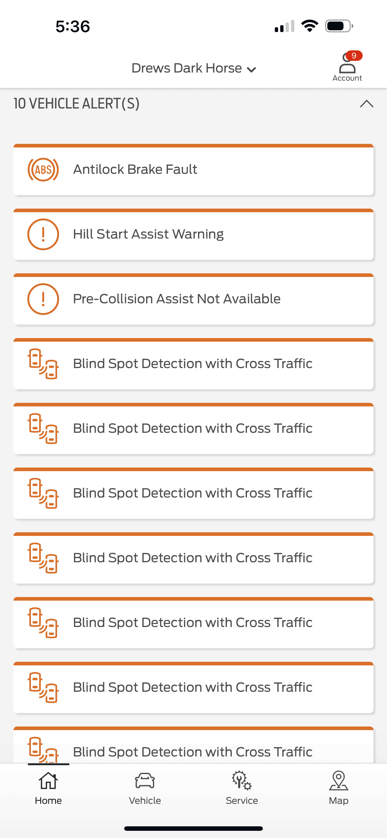

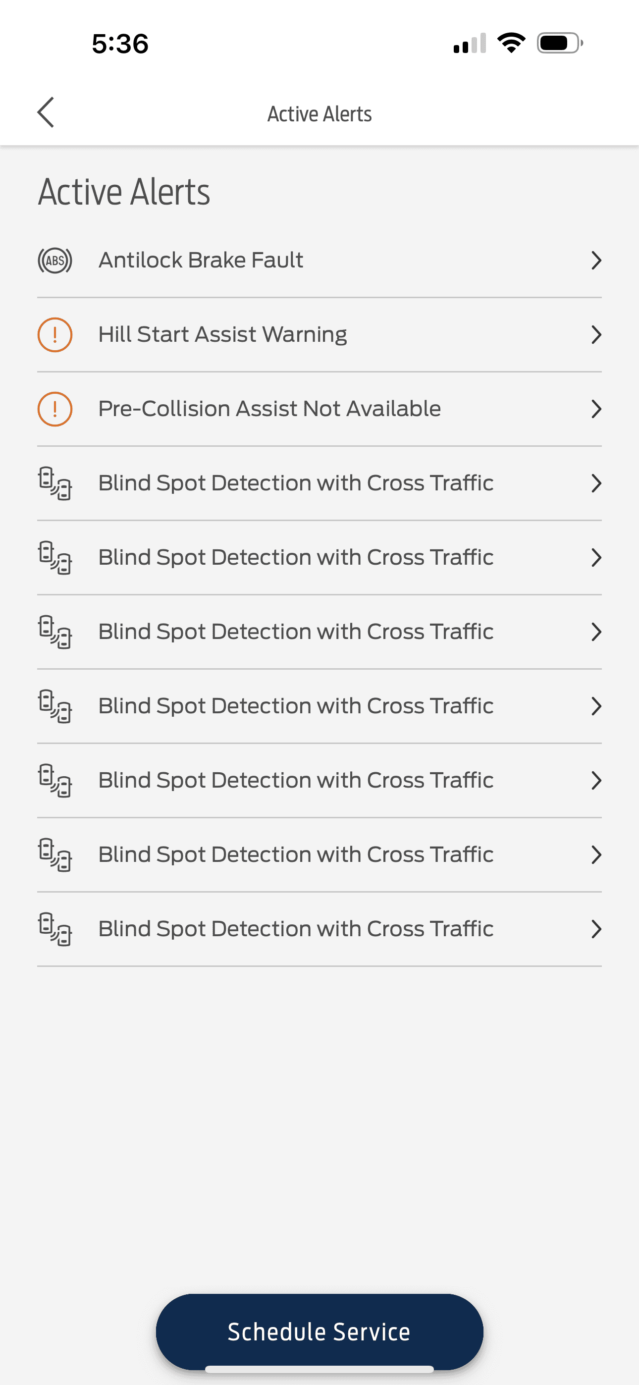

I have a similar issue, was driving to the dealership to get the shredded up trofeos replaced and every single light on the dash came on, abs error, stability issue, can’t change drive modes, hill start and pre collision errors, the works
Some community members having been stating this happens due to the battery, can this really be the case though? I was around 40 mins into my drive, and when this happened I was shifting pretty aggressively. So I guess it could be a bad/loose cell in the battery causing this. This can be very dangerous as when this happened my car dropped from 110 to 60. Hope Ford actually comes up with a solution other than saying to charge the battery.
Hmm I’ve heard that too, although my cars gauge says the battery voltage is at anywhere from 14 to 15 when the car is running/driving, I don’t know how accurate the gauge in the car is but who knows, I had the notorious trofeo rs issue where giant chunks of rubber come off the tire and as I was driving to the dealer all those lights went on, anyone have any ideas?
