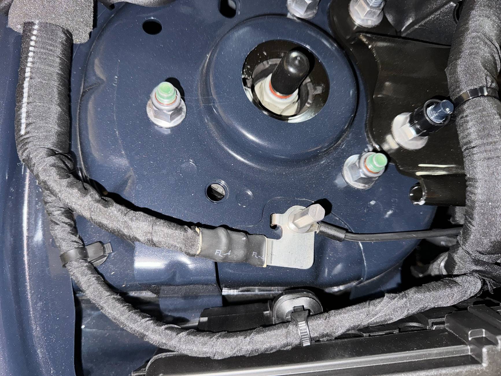

Does anyone have a video or image on how they hooked the ground up in the Dark Horse? I took a peak under the hood when I was working on the RTR Hood Vent and saw that it is very different from previous gen. Looking to perm install my CTEK so I can plug and walk.

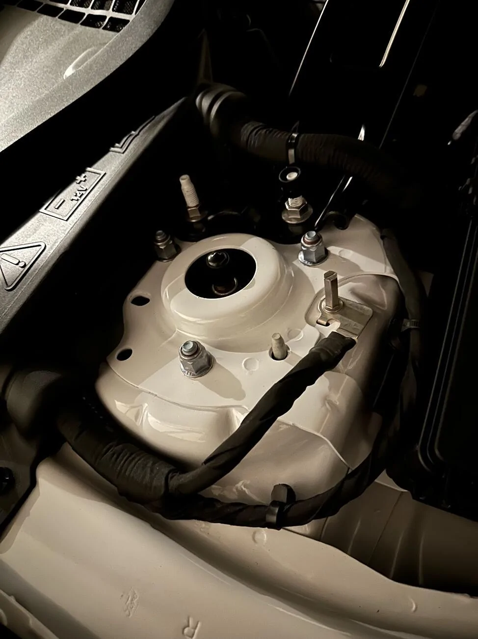

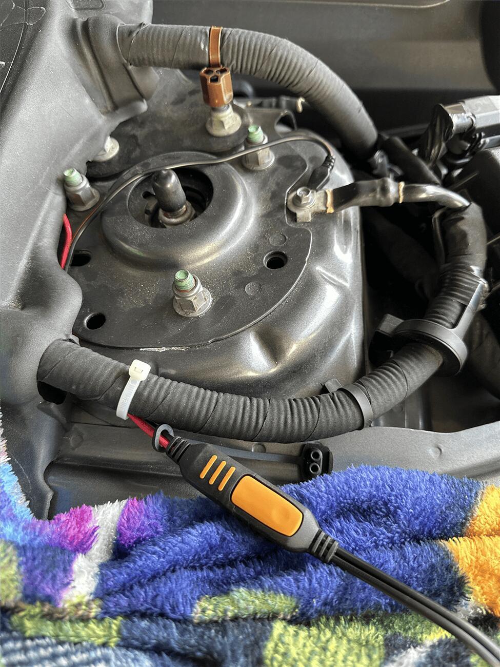

The hexagonal post that the ground strap is attached to is removable with a socket wrench and your battery tender ground can be attached to there as well. I have attached a picture of the set up on my car.
Yeah there is another MEGA THREAD going on where I did the installation just like this. I actually used a box wrench to remove the ground bolt, throw my ground eyelet on there and then do it back up.
Took SEVERAL hours of charging but my battery is now back up to snuff. Ford had the car sitting in a lot for 2 weeks waiting for shipment. Car has only been driven 86km since it was built a month ago lol
