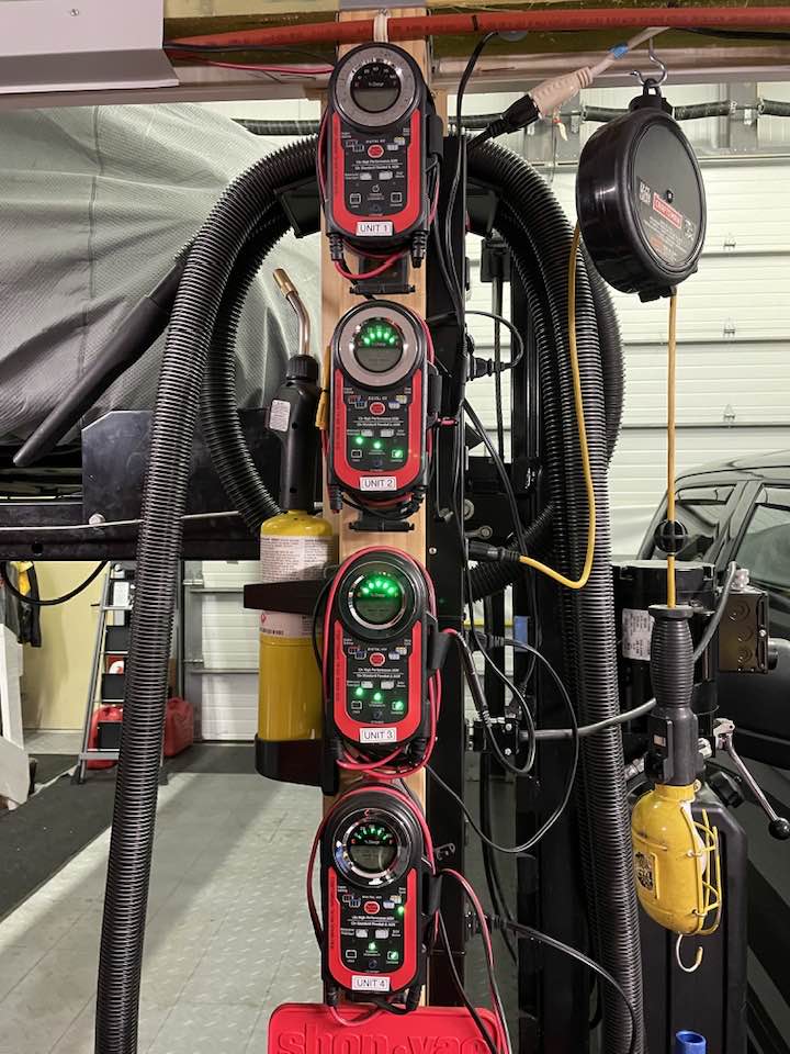

I have 3 Mustangs and a Corvette and they all get plugged in when I am not driving them.

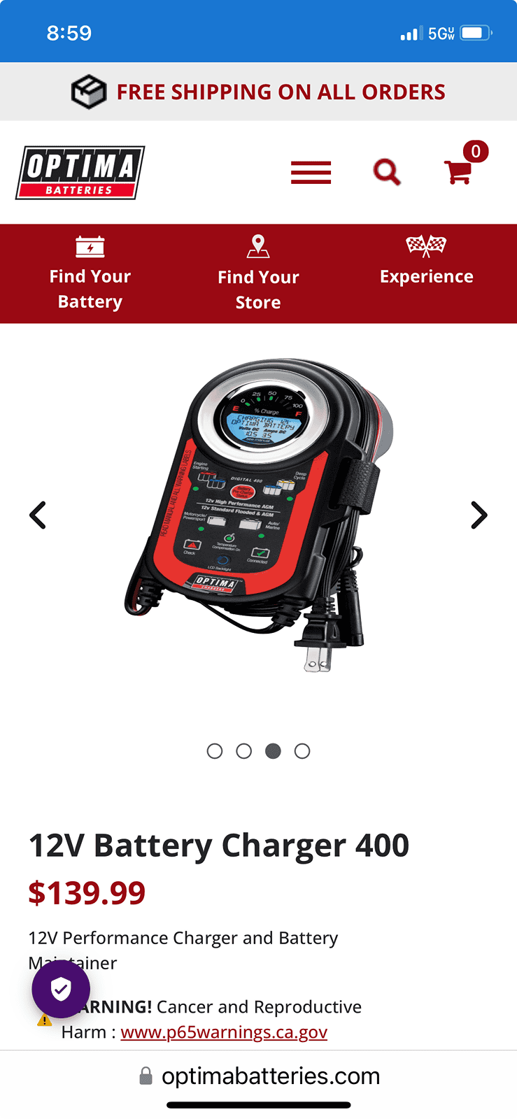

Would you please share the make and model of the battery charger shown?
3,260
3,709
We've used NOCO units with zero issues. We store cars, trucks, SXS, ATV, and other vehicles over the winter in Michigan and during the warmer months when not using them.
These 1A units are relatively inexpensive, safe, and they work great for the intended purpose.
https://a.co/d/6EXkUdB
I install the 2A direct mount units on our off road vehicles so, no matter where I am, all I ever need is an extension cord.
https://a.co/d/6bb6fnf
