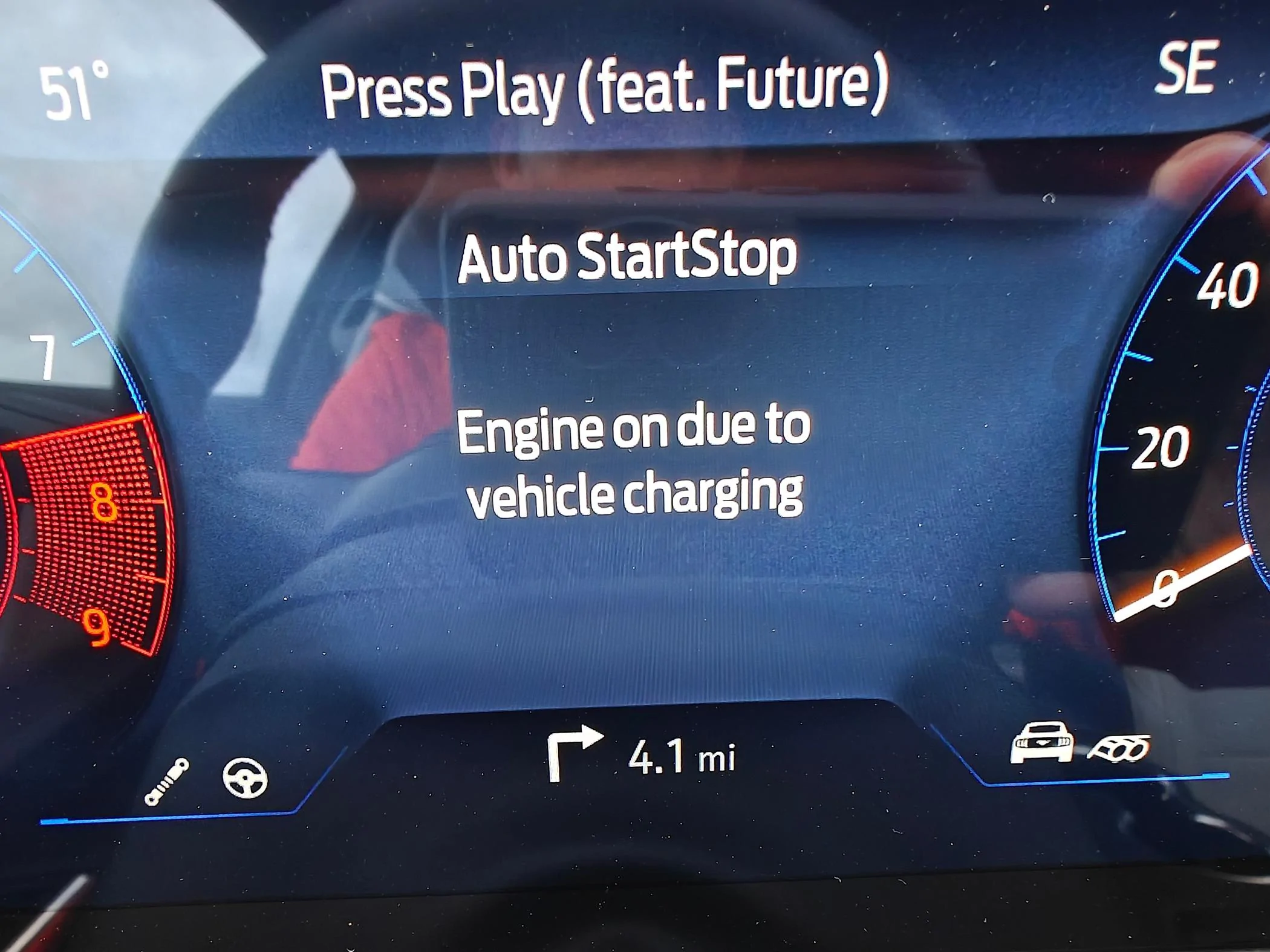

Has anyone gotten this feature to work on manual transmission? The on-screen display says "Engine on Normal operation" when I am in motion. Every time I come to a stop it says "Engine on due to vehicle charging". I drive 50 miles round trip to work and back. The battery should be getting plenty of charge.

I’d be tempted to put it on a charger for a couple of days just to make sure its topped off.

have your battery load tested. if it is weak it will not work. I have a 2017 Ranger that is on its third battery under warrenty.

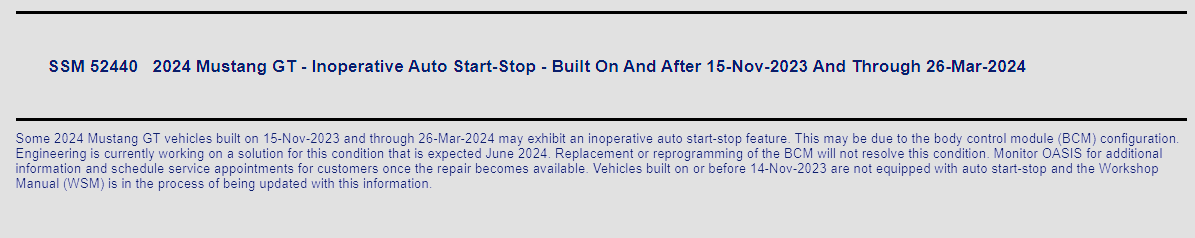

The Auto Stop/Start is also not working on my GT, checked and there is a TSB already out for this.
