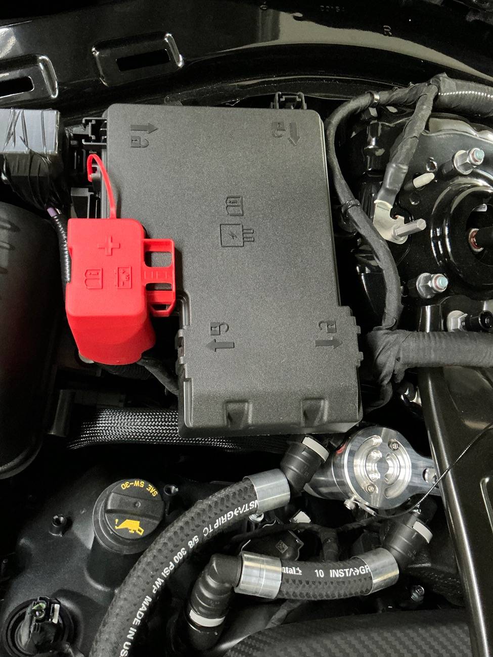

Don’t see any hose even though I had to take it out to properly charge it when I first got the DH! When I got the car battery was low couple times so I took it out and charge it overnight and now it doesn’t falter anymore!
uhm thats a fuse box

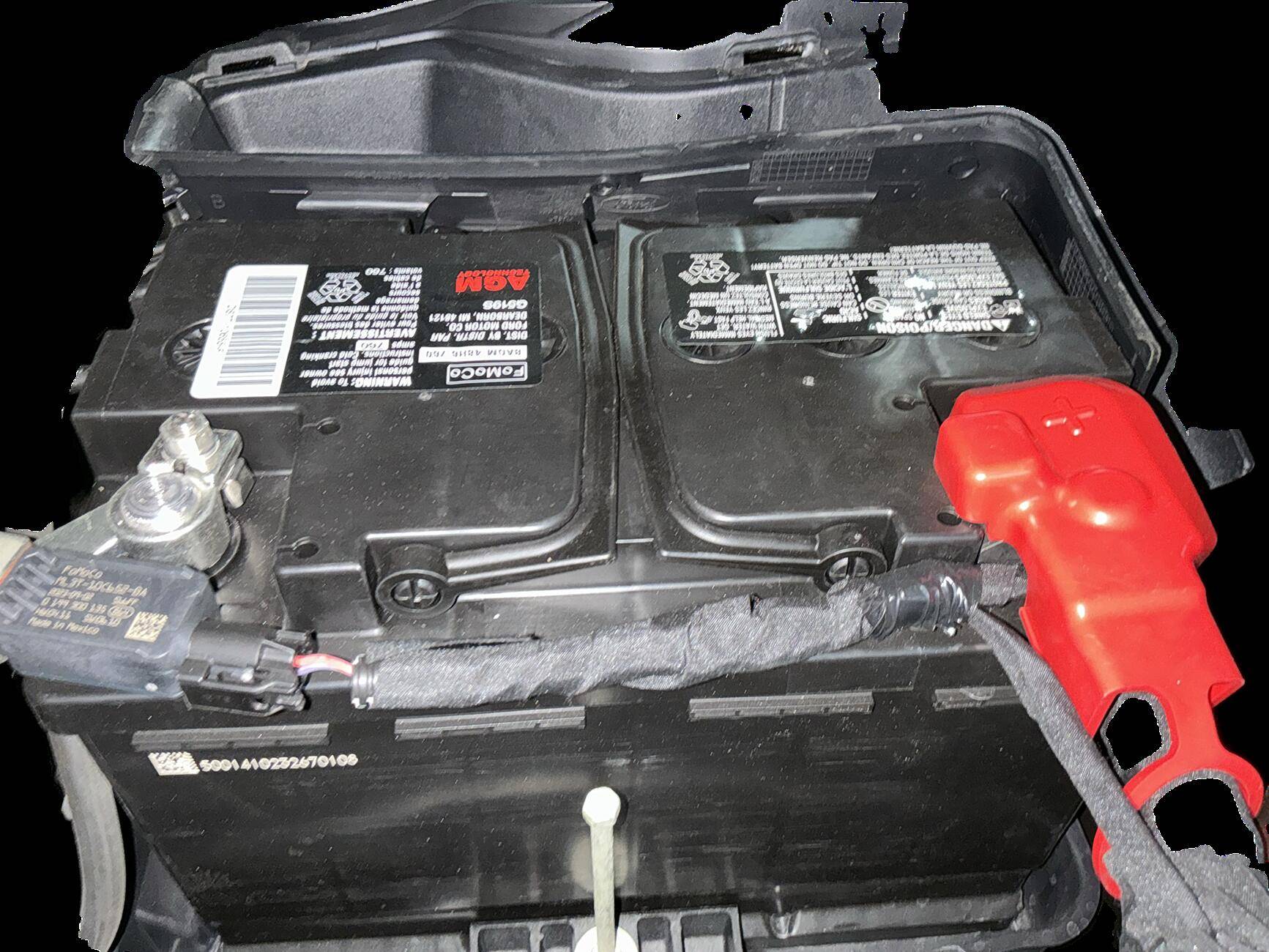

You’re right the battery is under that plastic cover, my morning pajamas oopsie picture taken! Mine is an AGM battery and yes has that hose into it but can’t see it in the picture! Lol! It’s been more than a year since I had it taken out to charge it! I had forgotten what it looked like! My apologies!

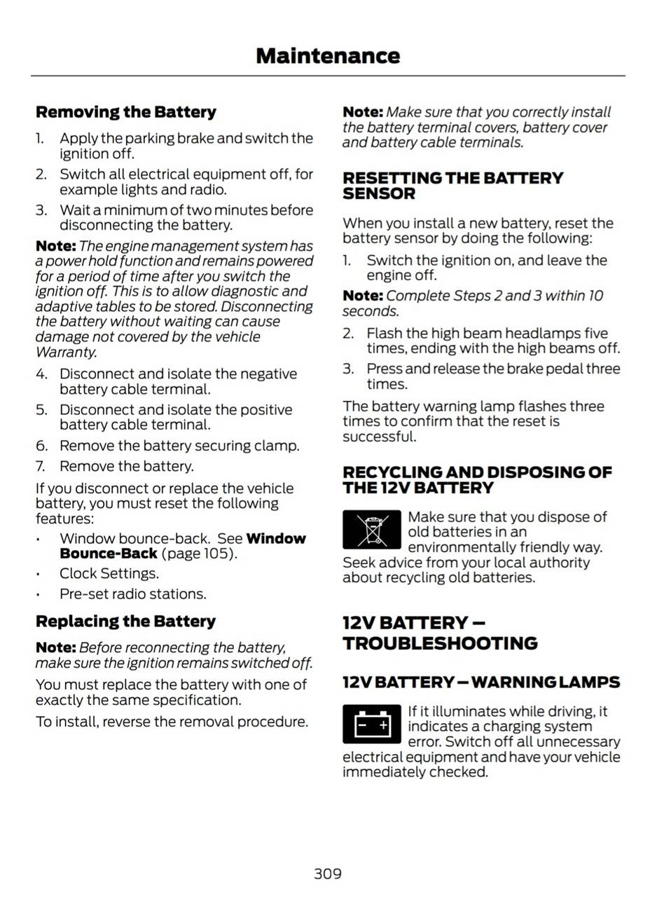

I had just looked whether the manual for the vehicle regarding ”removing the battery”. And it is in the manual on page 309! It has the clarification on how to do it.

Please show me where it's written how to remove the hose, or even mentioning the hose.
Please show me where it's written how to remove the plug for the sensor or even mentioning the removal of the plug of the sensor.
Please show me where it's written what screws you have to remove on the positive cable since it is not clear for somebody doing this the first time which screw it is.
The manual doesn't answer any of my questions. That's why I asked the forum.
It's super frustrating that people refer to the manual after reading clearly that the answers to my question are NOT in the manual.

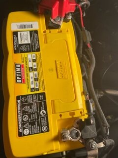

I put an OPTIMA Battery in mine and made sure that I attached the vent and plugged the other vent hole. Should not be an issue if you don't use the tube because the S550 battery is in the same spot and doesn't have a vent. As a side note, an S650 battery tray will fit in an S550 with some minor trimming. I was the OPTIMA Sales director before I retired, so they asked me to make sure the batteries fit with no issues.
