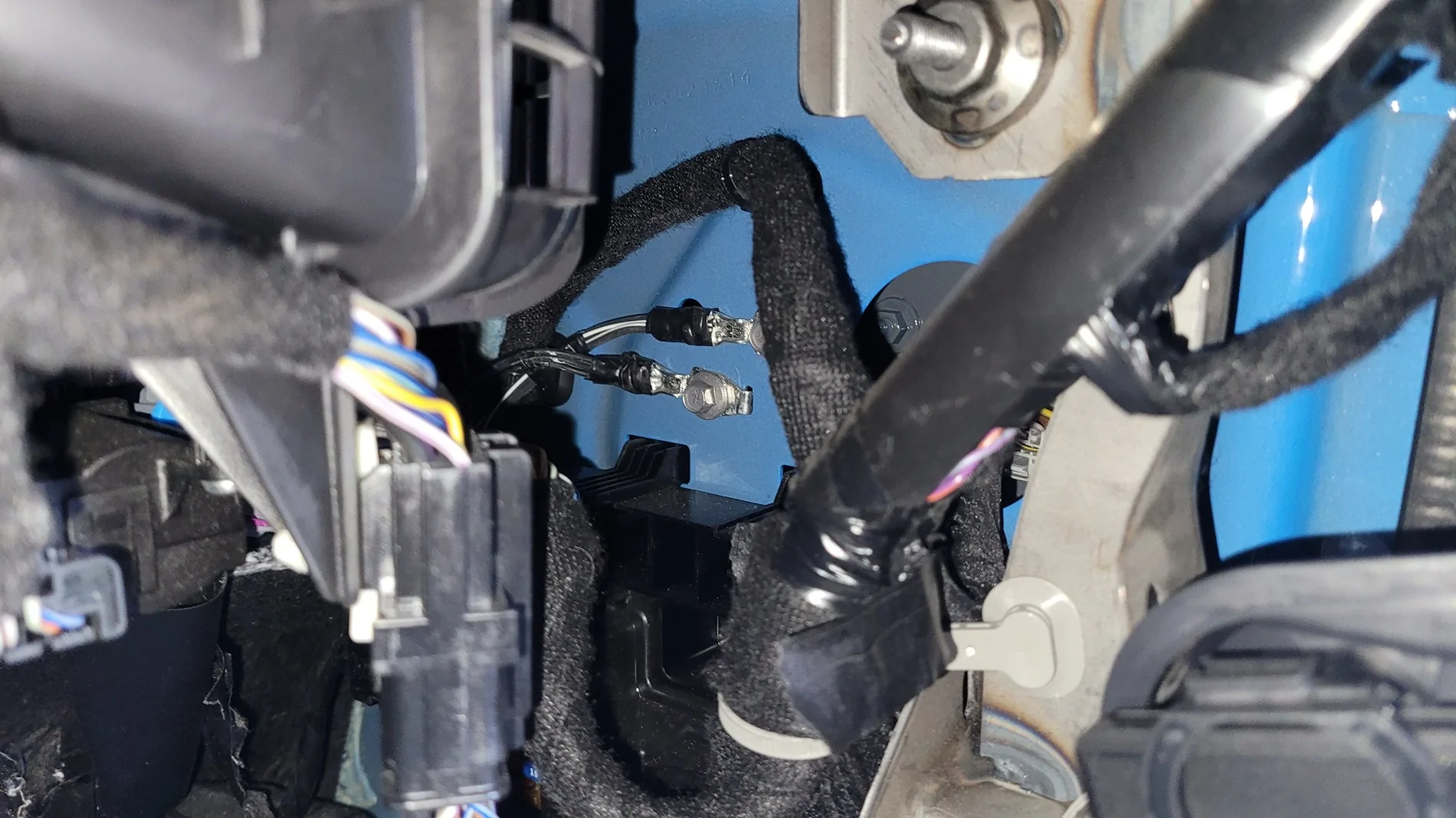

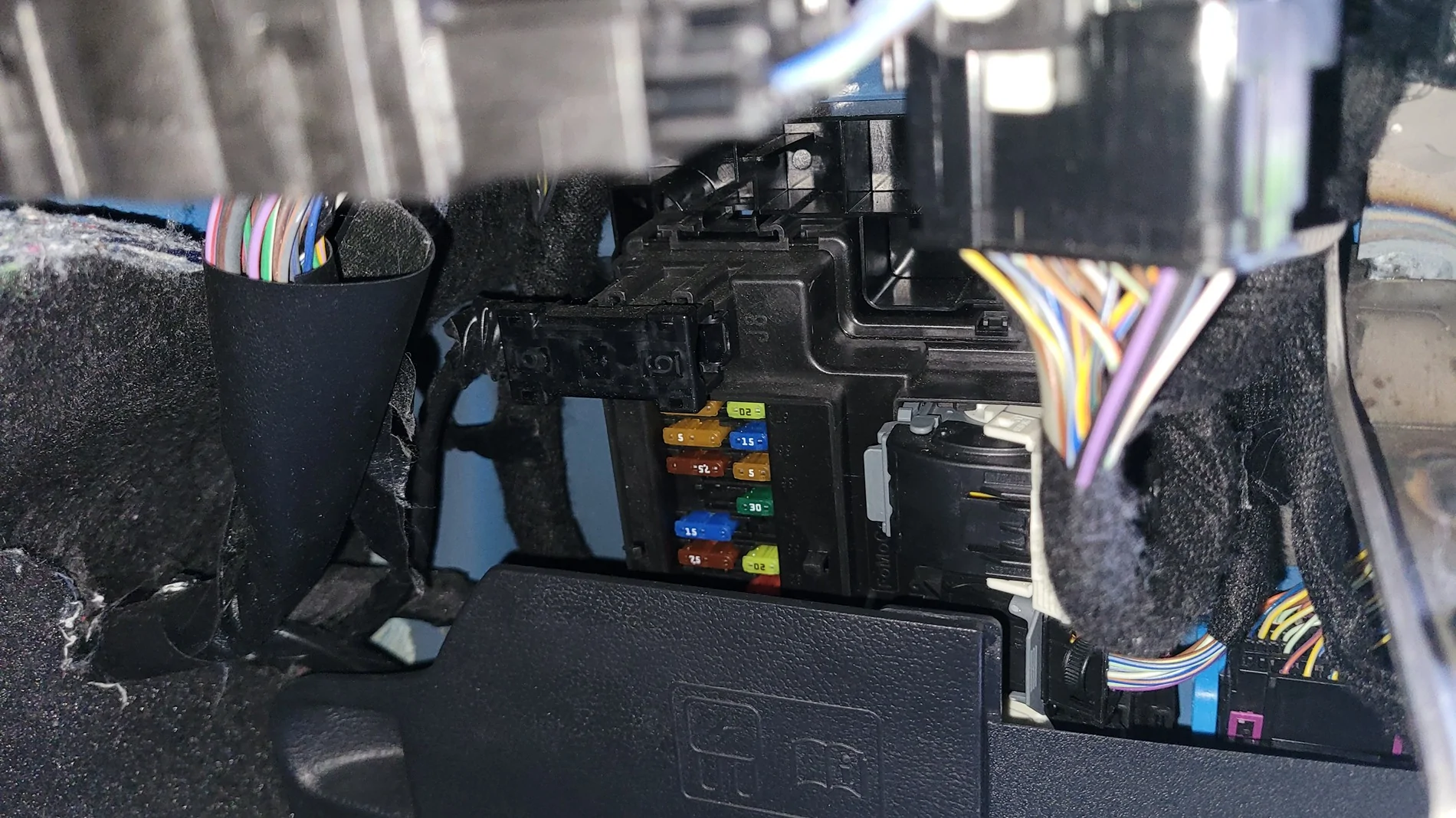

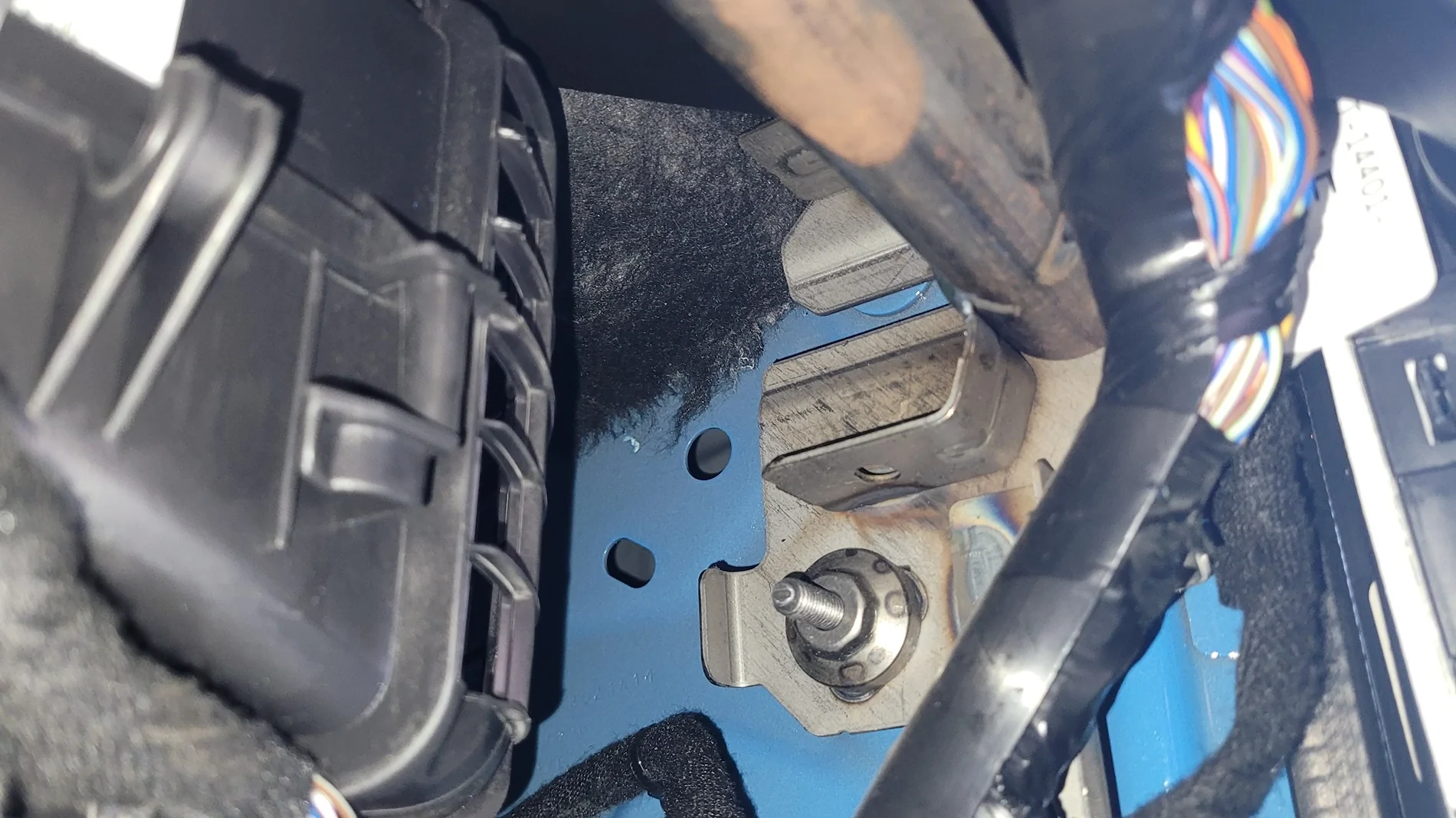

Just took my glove box out to change the cabin air filter (which is a small PITA btw), and snapped a few pics. I see zero evidence of any water intrusion anywhere.
Now obviously I didn't pull the BCM connectors, but I feel pretty confident I have no issue.
I’m getting a dash cam hardwired in the spring I think they connect it here so I’ll have them look deeper for me
