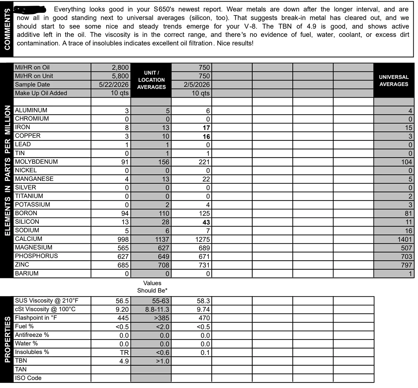

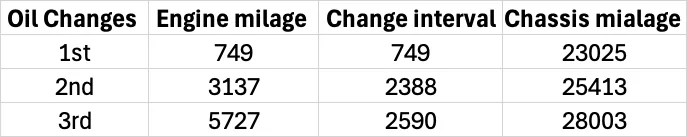

Oil analysis of my second coyote engine. Numbers on the table are more accurate form the ones I provide to blackstone. Oil has always been full synthetic.
When engine got installed I requested to add full synthetic motorcraft. Then in every oil change I used full synthetic Mobil 1 5w-30. Oil analysis in the first and third changes + TBN .

Who spelled mileage wrong twice, differently each time? LOL

Yeah, I'd question the validity of those results if they can't even spell correctly.

I'm guessing that Excel screenshot is from the OP
I'd be running the $15/jug semi-synthetic for the first couple break-in changes, it's only 2,500 miles. Then run 'good' oil for the first 'regular' interval change
That said what else do you expect for a new motor...I guess it doesn't hurt to know the engine is in good shape. But at $50/test or whatever....

My fat fingers spelled the mileage wrong. As for the results, if they were bad, I'm pretty sure Ford couldn't do anything unless there was coolant in the oil and you'd see the coolant level drop over time. That's what happened with my old engine. As for the other numbers, if they were bad, I'd just drive it hard until the engine lets go and put a new one under warranty.
