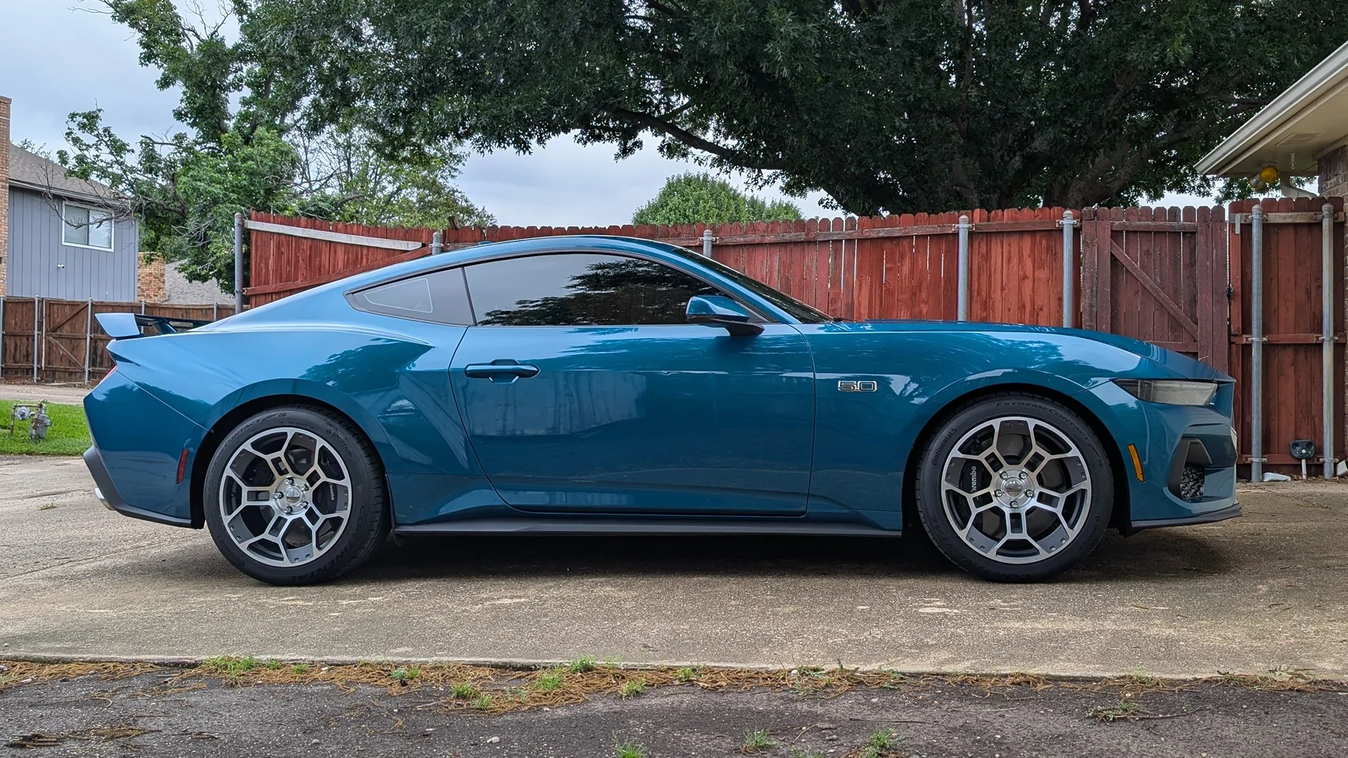

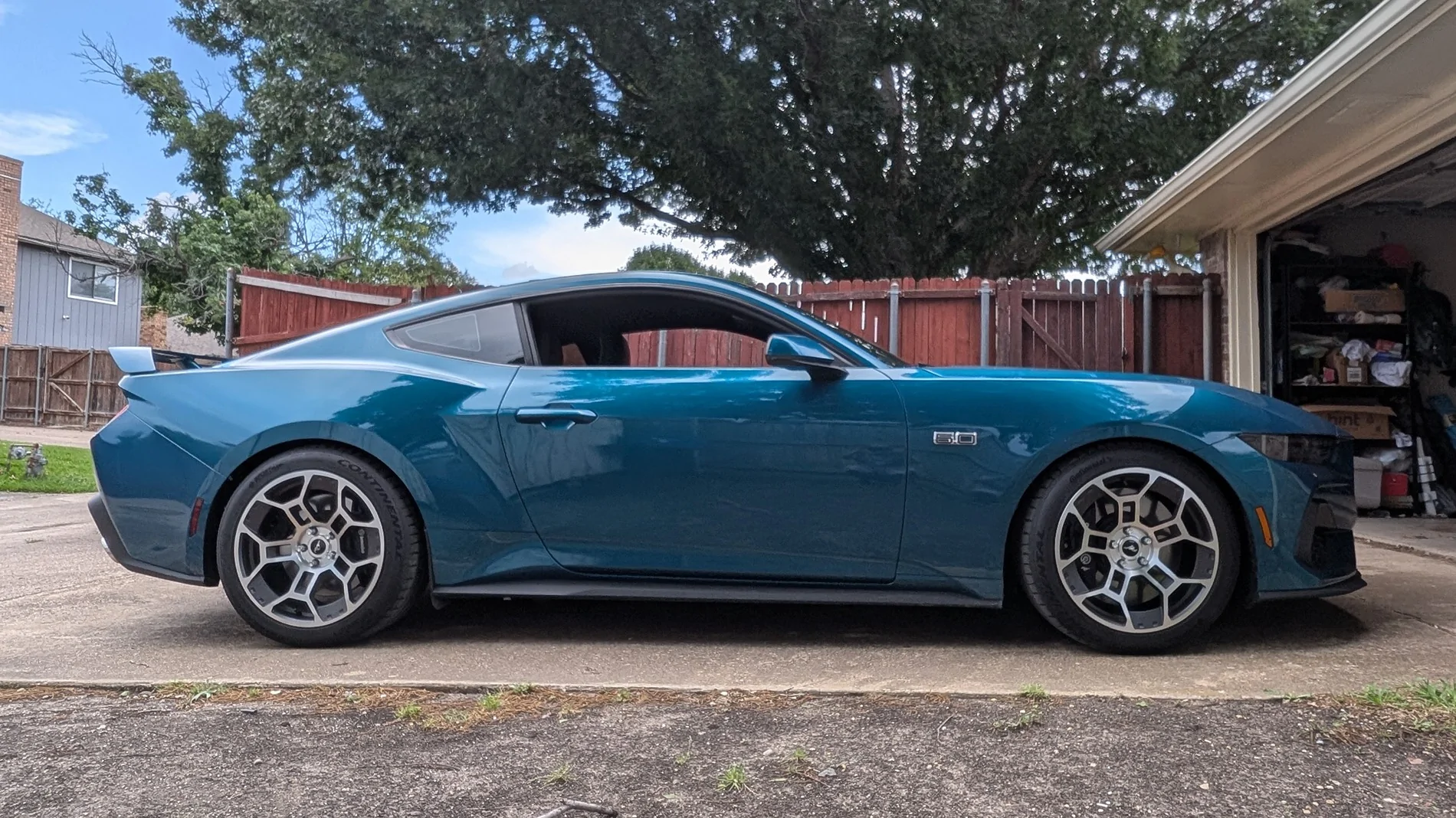

Shortly after having these springs installed and getting an alignment I drove the car from DFW, TX to Eureka Springs, AR for a Ford event. We hit plenty of twisty roads on the way up and in other drives in the area.
I'm very pleased with the springs. Overall, the ride is close to stock. I actually like the ride in normal mode better now because it feels more controlled. Prior to getting the springs I longed for a custom drive mode with "sport" damper settings while keeping the less aggressive throttle mapping of normal mode, which isn't possible. The "new" normal mode with the Steeda springs is closer to that.
There seems to be less of a change to sport mode. It still works great for spirited driving on curvy roads and seems just slightly firmer with the new springs. Even so, it's still fine for cruising around in normal driving without seeming too stiff.
Track mode still feels noticeably stiffer than sport as it did before, but I never used it enough before the change to have a basis for comparison.
Overall I think it's impressive how well the springs work without needing any reprogramming of the Magneride dampers.
Before and after pics to show the drop, which according to Steeda is approximately 0.8 inches front and rear.
S650 Mustang Steeda Magneride Sport Progressive Springs installed - review & photos 1000018874
S650 Mustang Steeda Magneride Sport Progressive Springs installed - review & photos 1000018875

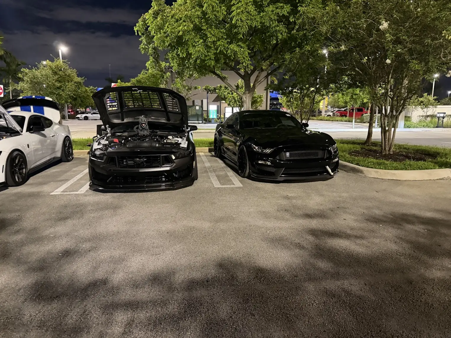

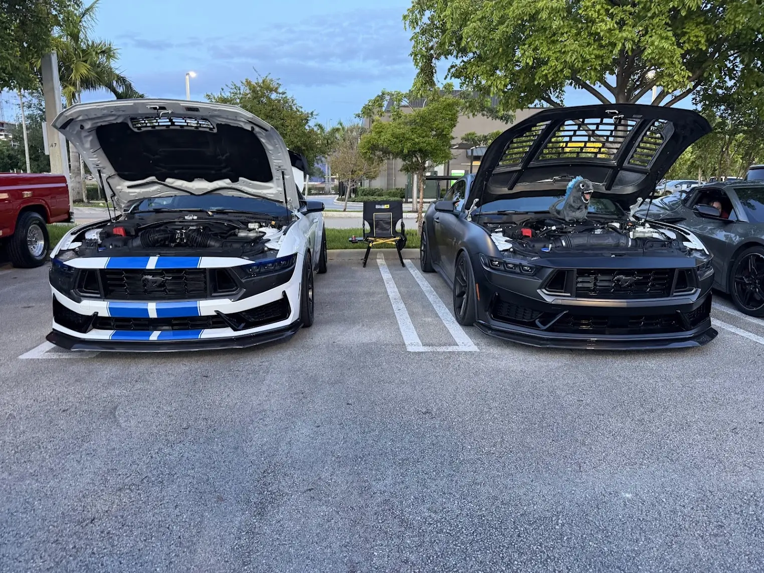

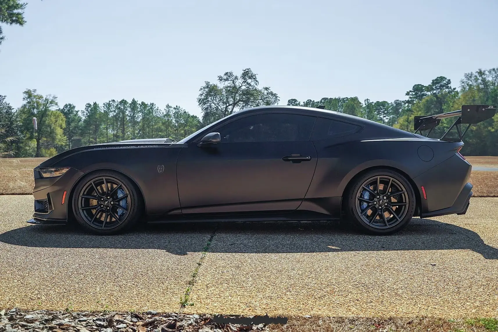

A pic of my car sitting.
1st is a pic of my vehicle (the satin black) next to a DH with the handling pack. (I also have the handling pack, but many more Steeda mods of course)

This is a pic next to a GT350(tech pack) with Steeda handling mods. This vehicle belongs to a friend who does a lot of road course driving.
S650 Mustang Steeda Magneride Sport Progressive Springs installed - review & photos 1780857014361-pd
Side view of my vehicle.
S650 Mustang Steeda Magneride Sport Progressive Springs installed - review & photos 1780857074424-0o

The view of your hood looks like it is completely open from the engine bay to the air above. Did it reduce temperatures on track days?
Yes, it is designed to reduce temps and add downforce. That, with oil cooler mods and the Ford Performance racing oil pan, will bring the oil temps way down as well.
I have not done a full session since putting on the hood; my feedback is from Steeda. I will say, running the car hard on the highway even in this Miami weather, the engine bay cools...A friend who is an advent racer could not believe just how much cooler everything was when we stopped, and he wanted to see what the temps were.

Great review and awesome pics. It’s funny how the “before” pic looks fantastic. Then, the “after” pic, look a little better. Nice job. Did you have to add any strut tower hardware or was the shop able to get it within spec with the stock setup?
Thanks! The offsets of the wheels allow them to sit more flush with the fender, which was an improvement even before the spring install. The magneride springs only lower 0.8 inches, so it's not a huge difference but it is noticeable.
I had Steeda camber plates installed at the same time. Might not have needed them with 0.8 inches of drop but my installer recommended them and having the extra adjustability made me feel better about it.
