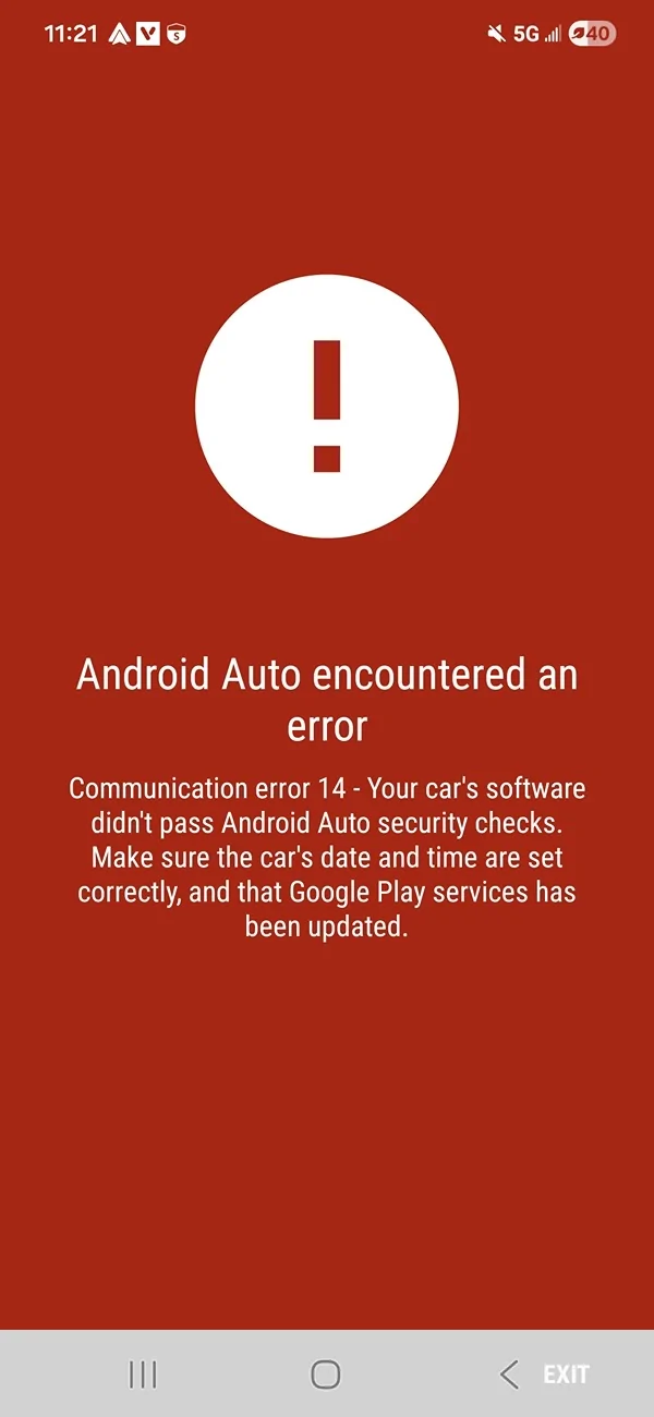

So, finally remembered to try to connect to AA again and screenshot the error screen.
My car's date and time are correct and are set to auto update. Everything on my phone is updated and current. My phone connects to my other cars with AA perfectly fine.
Anyone know what Communication error 14 means?
I posted here in case someone had similar experience and a fix before going to the dealer. I don't know about other's experience but taking the car to the dealer is a time suck with high potential for further aggravation I'd rather avoid.
I've never seen that before. But obviously something isn't syncing between your car and you phone. What phone are you using?

Try and update Google play store. Goto settings, then about, then update play store. Also clear android auto cache and settings. Maybe contact Google support ect.
