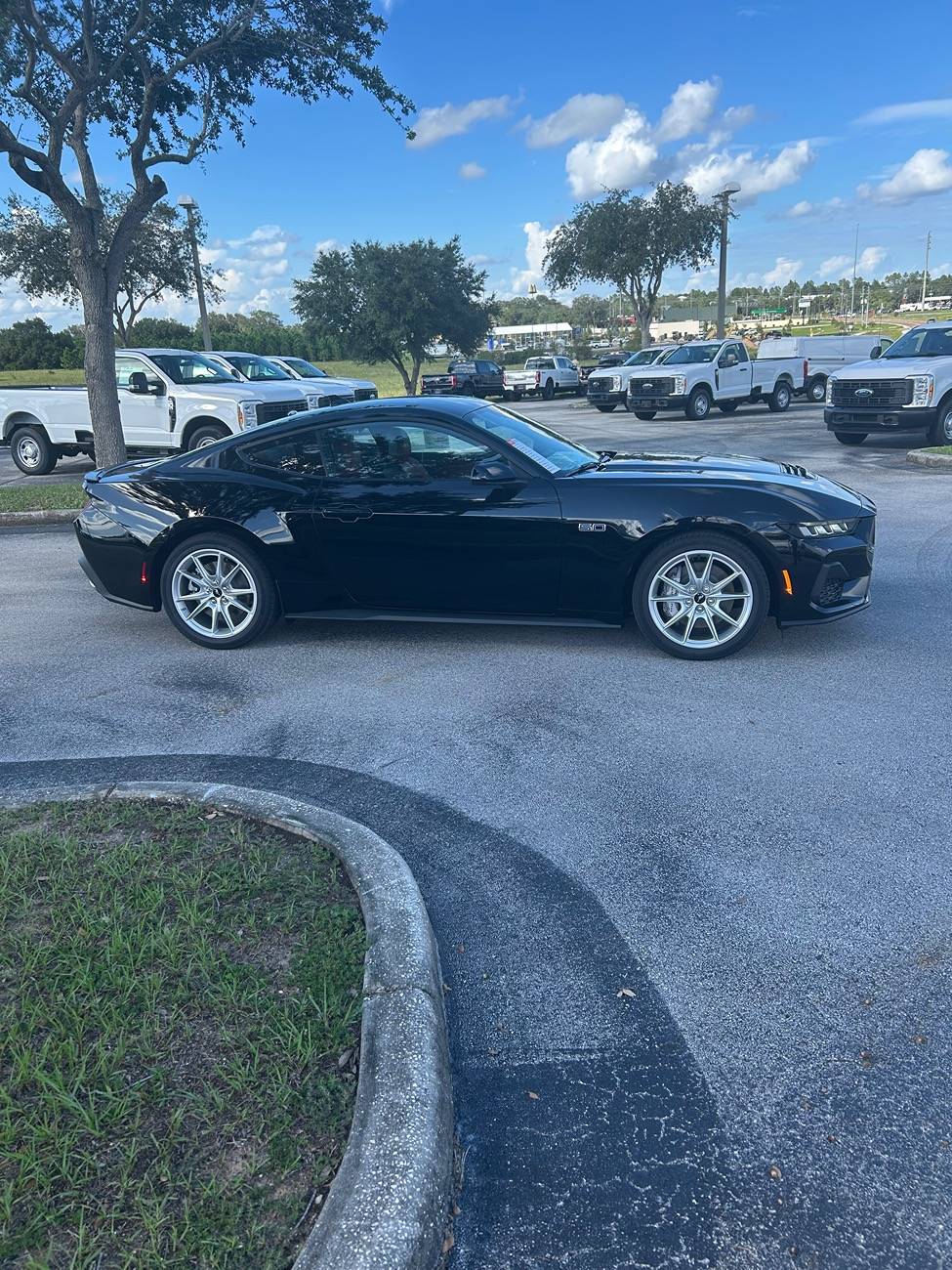

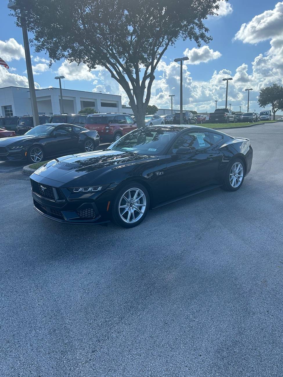

Thanks for the replies! I'm definitely getting a strut tower brace, and I'm definitely getting the cowl brace (and brand new nuts). So, I will have the rigidity needed.
My question is really regarding the looks. I know some (many?) will disagree, but I love the look of the aluminum rims on the black car. Similarly, I think the silver brace (in my first link above) will look better than the black one.
That's why I'd love to know for sure that it will fit.
S650 Mustang Will an S550 Strut Tower Brace fit on an S650? IMG_6833
S650 Mustang Will an S550 Strut Tower Brace fit on an S650? IMG_6834
