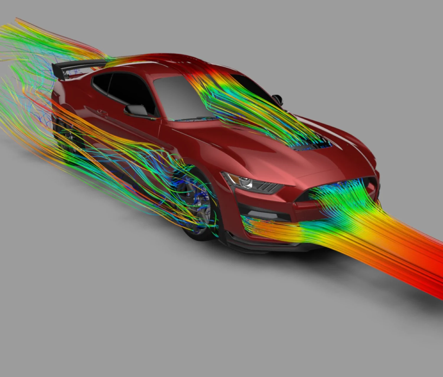

Remember all the cooling they had to add to the GT500. Six heat exchangers total....
S650 Mustang Whipple performance on road race track? IMG_9298
So are there additional cooling modifications we can make?
The Dark Horse R cars have all added a PWR dual pass radiator of some sort and a 960 Setrab oil cooler in front of that.
