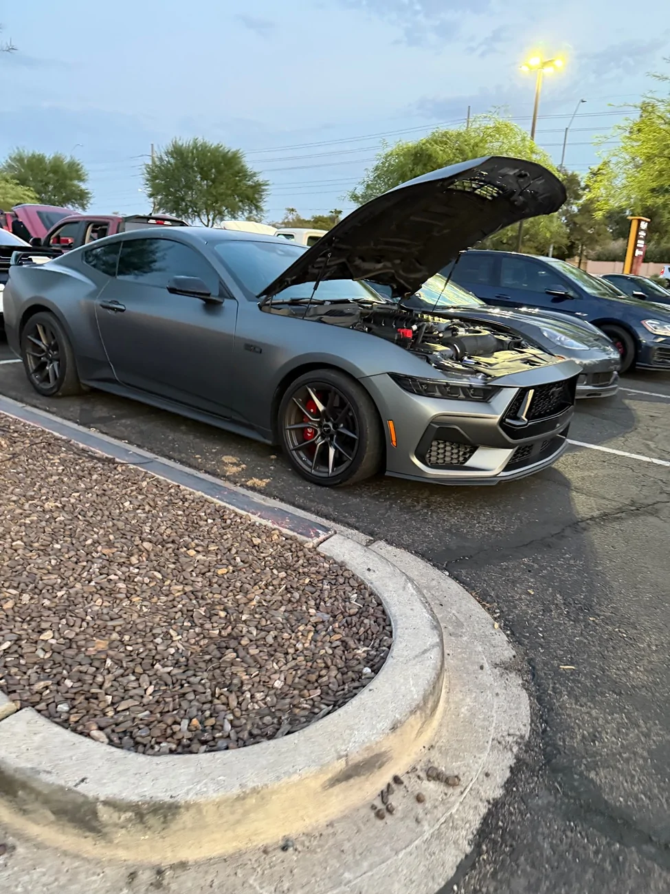

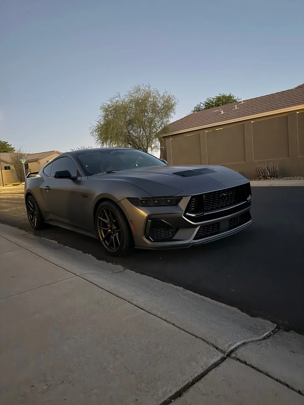

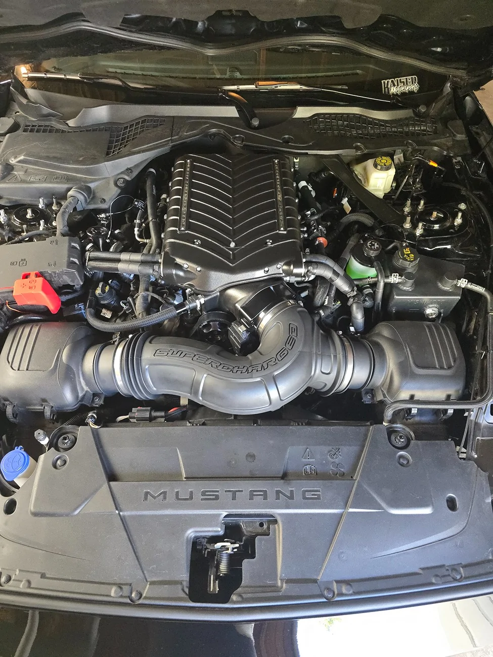

i’ve had my stage one on Apex motor park in Arizona. April, mild temps. Call ran strong. in track mode, Throttle delivery was a little bit more linear. You can control the power coming out. Just make sure your tires are pointed where you wanna gošŸ¤— No heat issues in regards to the blower. Was more concerned about oil slosh & brake fluid. 4-5 lap runs then I let it cool down. Drove it hard then it drove home like a Sunday driver šŸ˜ŽšŸ

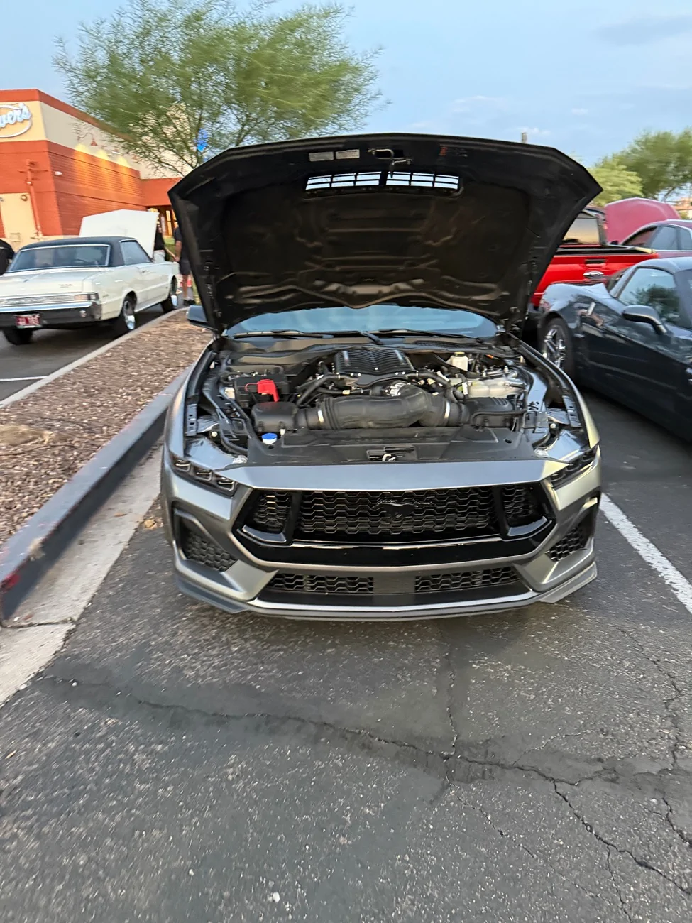

I'll speak to what I have: My GT has the pp and the extra cooling. I have the stage 2 Whipple and I have yet to take the car to a road coarse bc I bought drag radials for it and it's gonna be a minute before I buy a 3rd set of wheels and tires.
I'm impressed with the cooling of the gen 6 3L Whipple. The car has never seen engine temps past the 220s or 230s oil temp. I don't have a diff cooler, so those temps tend to get higher than the engine oil temps and I suspect that if you don't have the DH handling pack with the diff cooler, that will be as big an issue as the engine and oil temps. If you have the HP with the coolers, forced induction will be fine.
If you don't have the coolers then don't boost it unless you plan on also adding all the cooling upgrades to the car.
