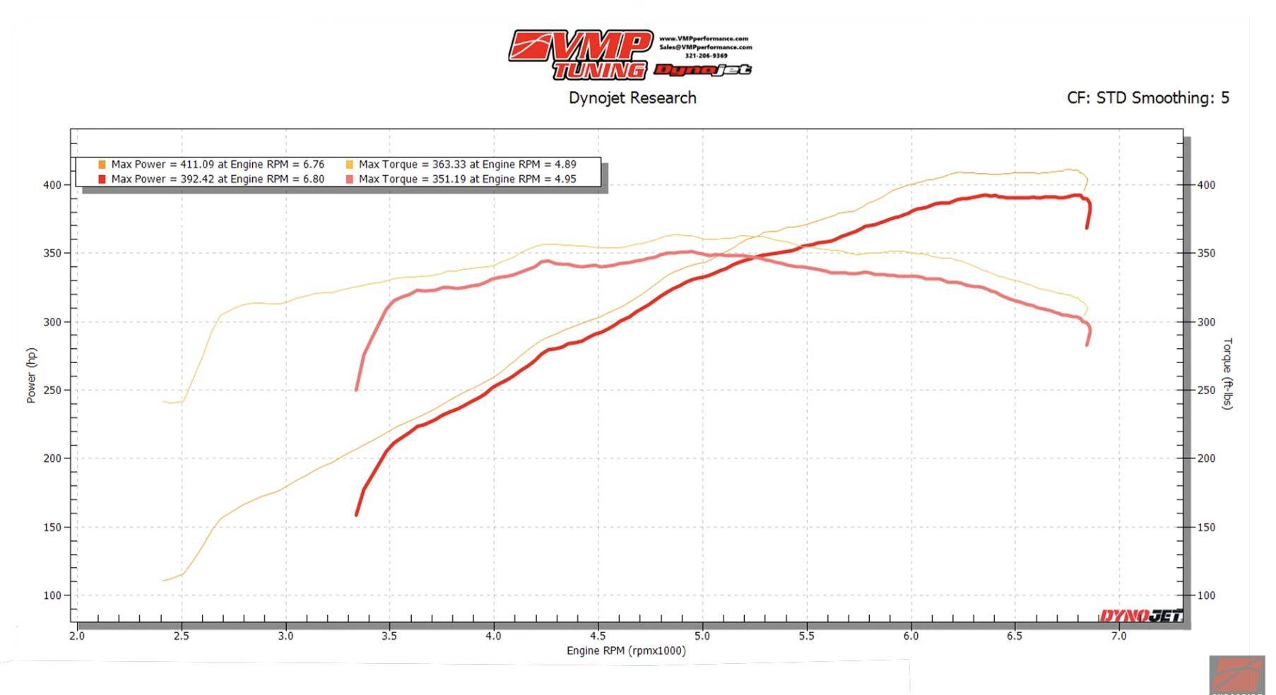

Didn't a couple companies do dyno videos of 91 vs 87 or was that only VMP with the Whipple installed?

VMP ran a 2024 directly from the dealer, they suspected it had 87 octane in it, and then added the suggested amount of Boostane to bring it up to 93, and this was the difference. Sure, it would have been nice for them to run as much 87 out as they could and go fill up on known good 93 but it's similar to gains seen in earlier Coyote engines on 87 vs premium (19hp difference)
