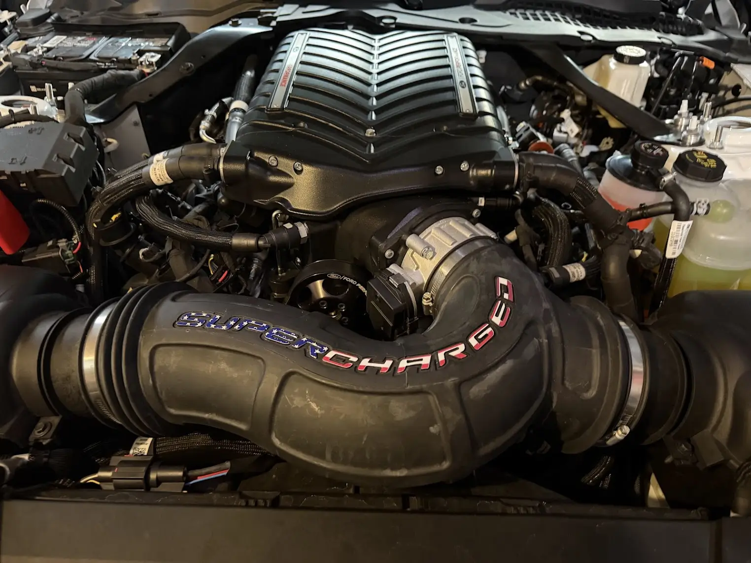

So today a new mod....I'm just down to cosmetics now....But I do like to open my hood. Took my time with these big meat cleavers, but I do draw so......mathces the Ford Performance.
