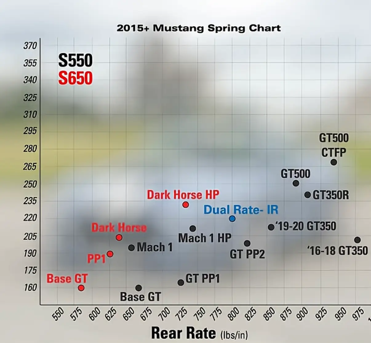

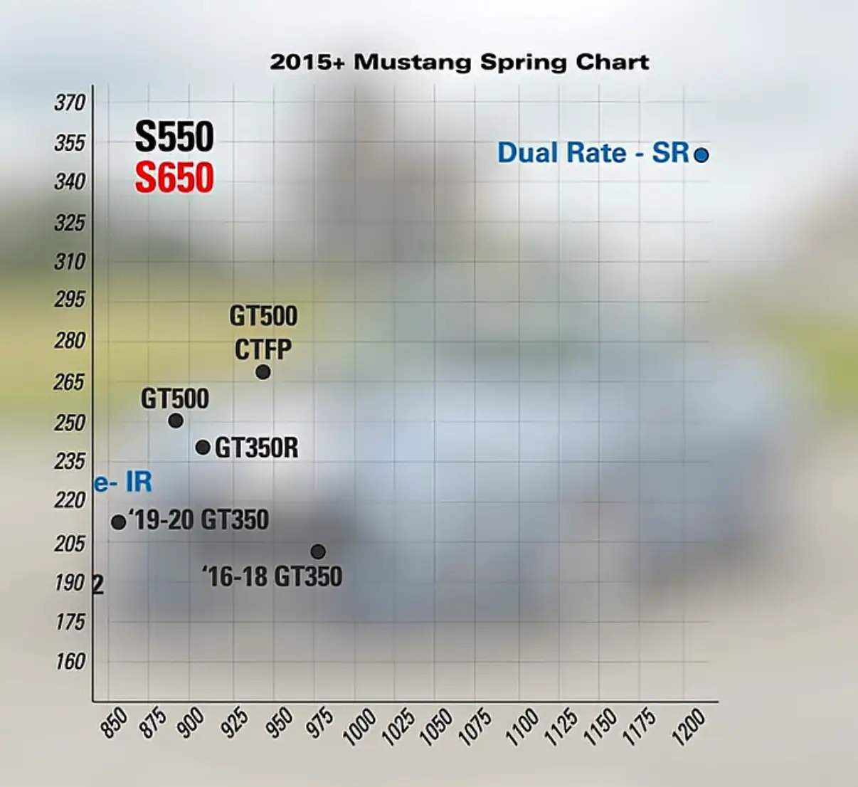

What's the spring rate of the Steeda dual rate springs vs stock Dark Horse springs?
