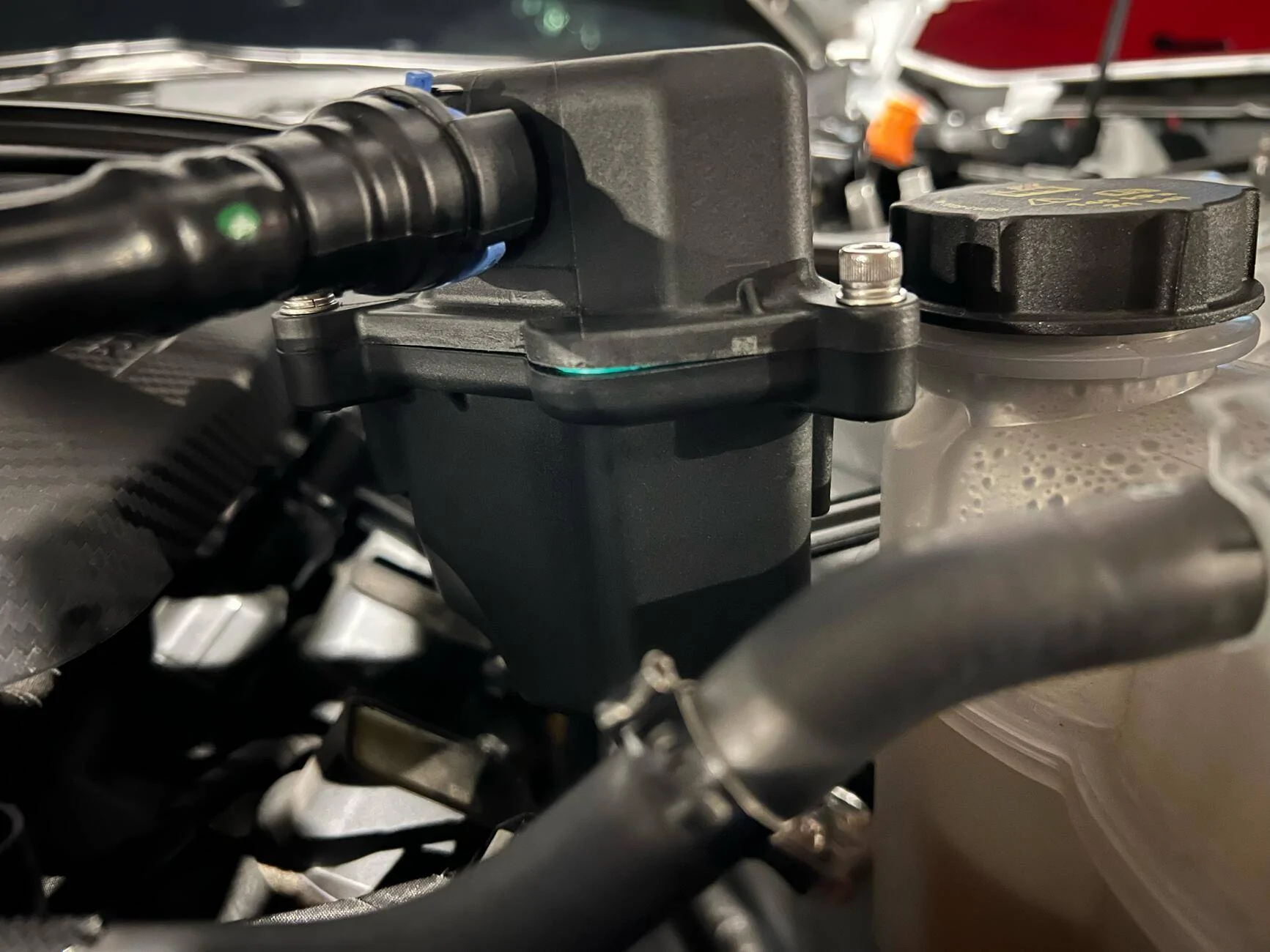

Why is the rubber sealing visible in air/oil separator. The cap is tight. Driver's side is more visible.

It looks as if your oring might not be in the groove.

The oil cap doesn't appear to be fully seated. It sounds like vacuum is escaping from that area as well. Between the lip of the oil cap and valve cover, there should be no gap. The two are normally flush with one another.
As to the oil separator, the O-ring and container are off by a bit. Seems OK. It doesn't appear to be weeping oil. IIRC, the Ford unit is taken apart to empty it. You can separate the two halves, inspect and possibly re-align. If it keeping a good seal, I'd leave as-is.

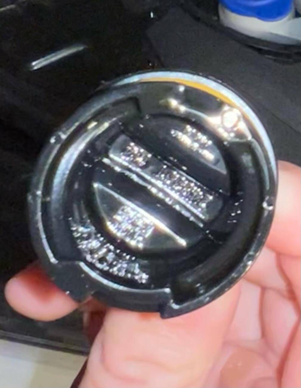

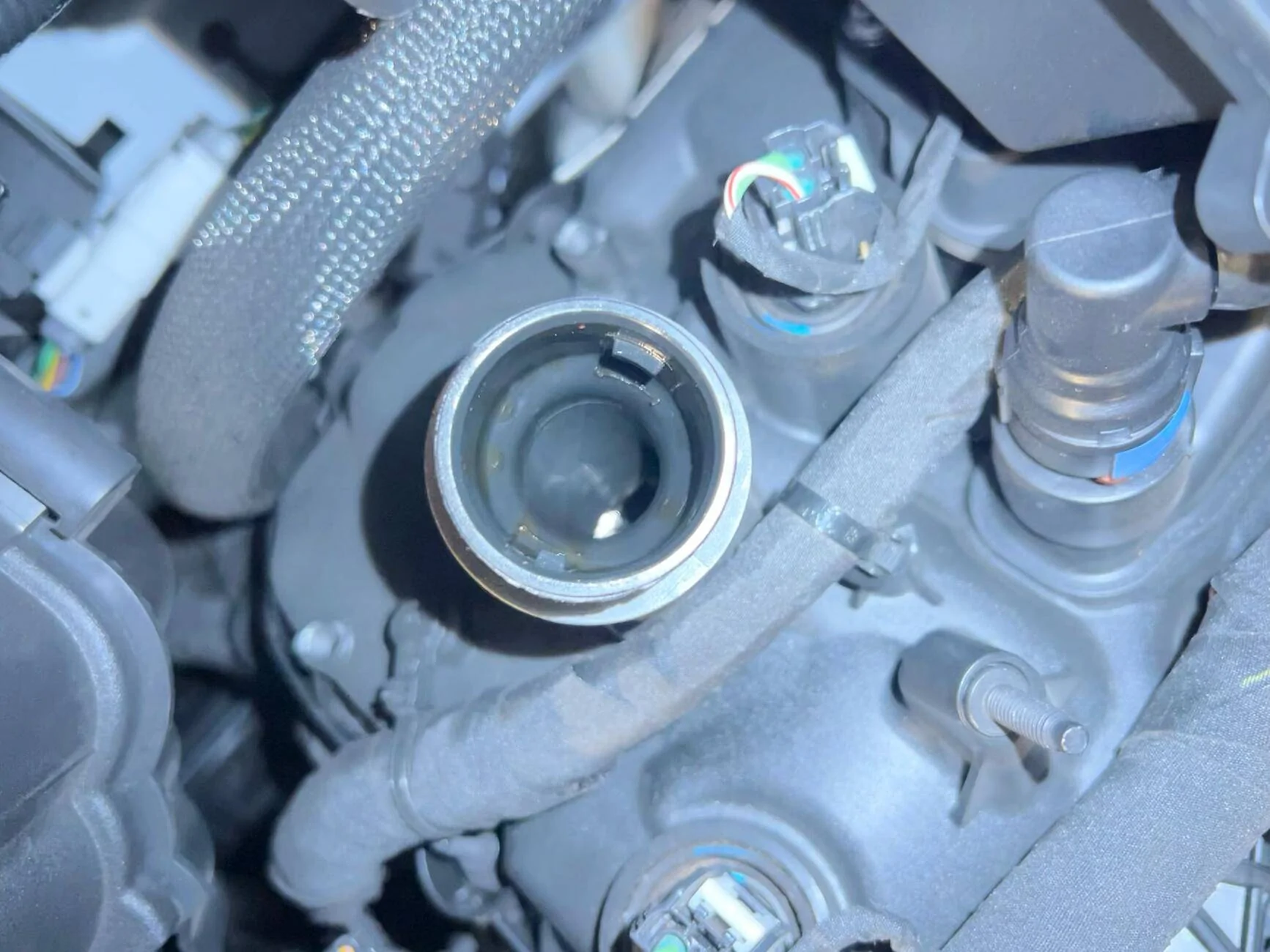

@Skye @24 vert here are the pictures of the cap and the oil tube.
oring seems to be there but it does appear to have some wear (black spots).
Any possible issues fro the engine if there is indeed vacuum leak ?

From the latest photos and the original video, the filler cap is oriented correctly when down. But I cannot tell if it is sitting flush or not.
When the cap is in-place, is the flange of the cap flush with the valve cover? Or, is there a gap? It should be seated and flush.
As to the sounds, the PCV valve is sitting right there. I hear the sound of air passing by. Maybe I'm hearing that.
Often with a vacuum leak, the engine ingests more air than it should, the engine running leaner.
If you confirm the filler cap is seated flush, while the engine is running, I'd run your finger tip around the edge of the filler cap, then around the edge of the oil separator where you've seen that gasket concern. If you do not hear any change, like if you were checking for a leak, I take it as that's just the way it is. If you can change the tone or sound with your finger at some point, that's something to check.
Regarding the O-ring, it'd be a good practice to clean that, remove the deposits with a rag or something. I'd also run that within the seat of the valve cover, to ensure it's clean.

Just came back from the dealership. They checked out and is the PCV valve (the brown part where the house from are AOS is connected. All normal. The guy suggested if I want to change that valve with a performance one front eh gt500. I was like nah if it normal not needed.
1,763
2,772
≈39N
That's cool. Always good to have a cold pair of eyes look at a new concern.
Glad things worked out and there were no issues. :thumbsup:
So in the end, did they say that was the PCV valve rattling / sucking air but it sounded like it was coming from the oil cap?
