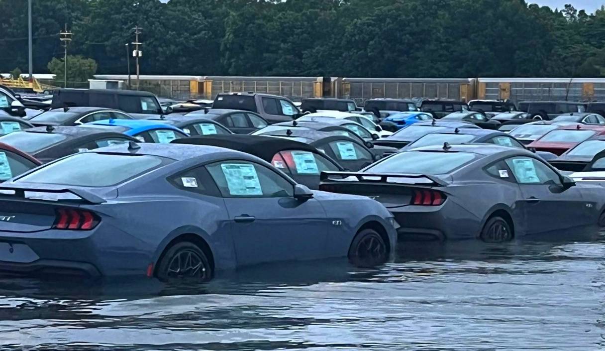

BTW I took delivery way before that Ford lot got flooded
S650 Mustang Turned on heater smells similar to vinegar, Anyone else notice this? flood

That picture is gut wrenching. As for your problem I am not sure. However my DH has same mileage as yours in a heated garage but I have never used the heater just A/C as I only drive in nice weather. So now I'm going to go start it and put the heat on to see if I have the same problem. As it has been parked for over a month because of rain everyday
