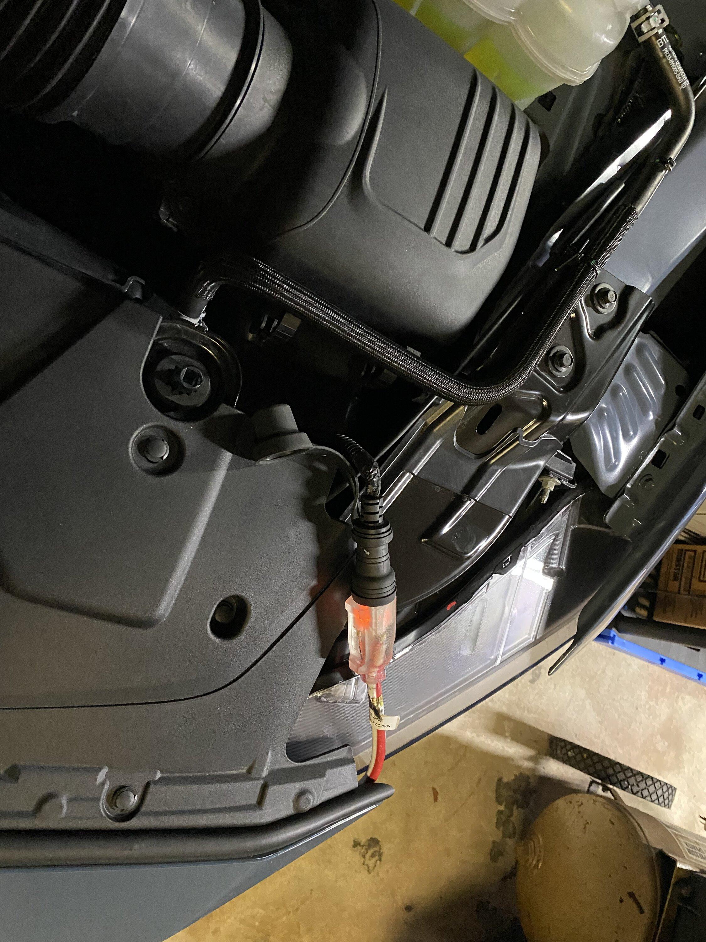

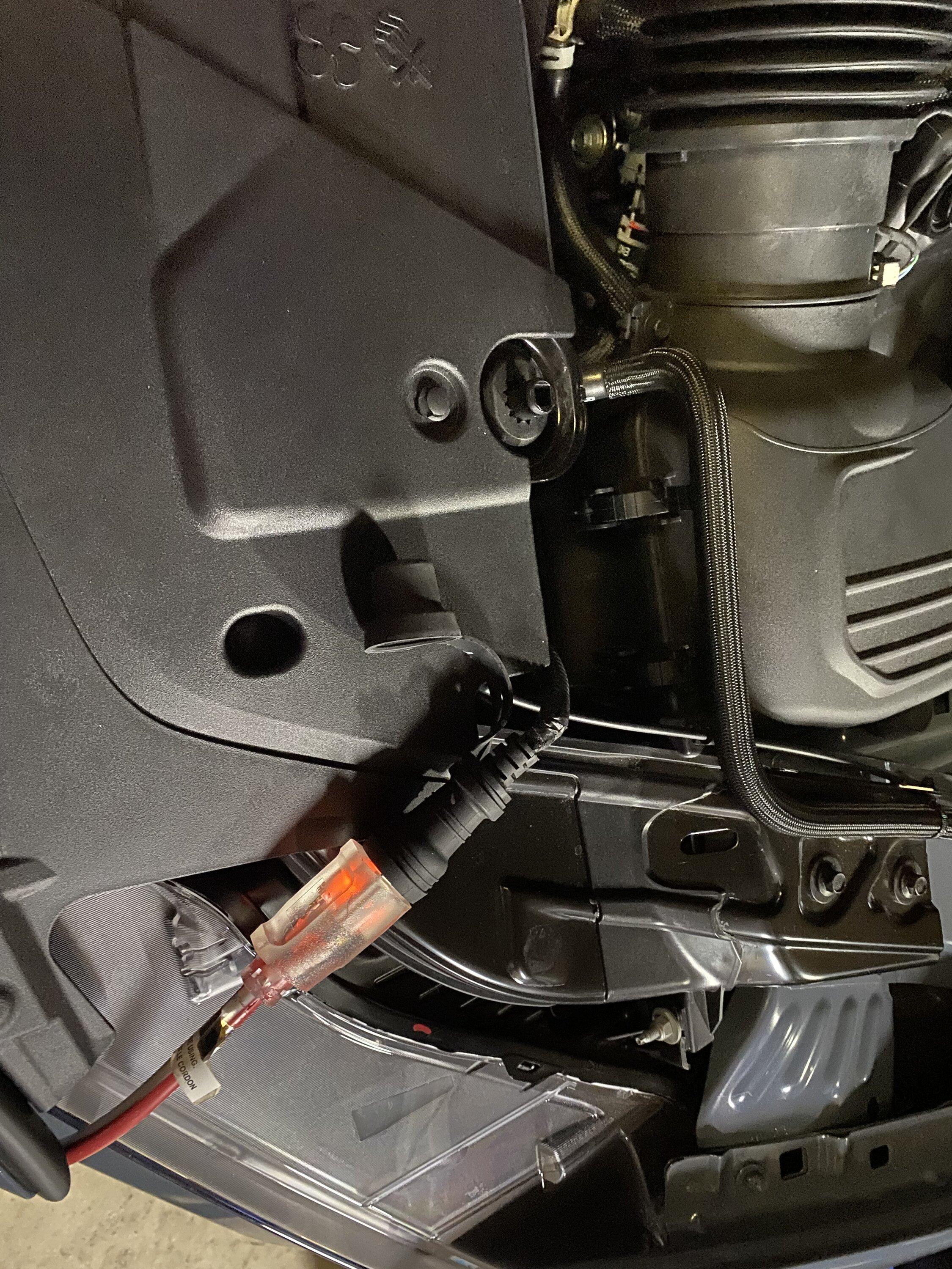

I ordered my GT Convertible with an engine block heater. The manual is absolutely no help as to the location of the plug. Any help is appreciated.

Driver side tucked in just ahead of the air filter box.. I had to hunt for it as well!
