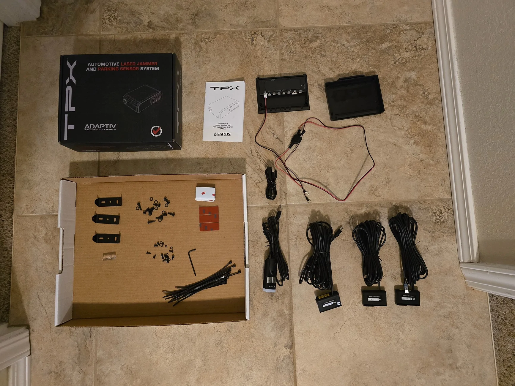

TPX product
S650 Mustang TPX Laser Jammer DIY Install 20251012_193508

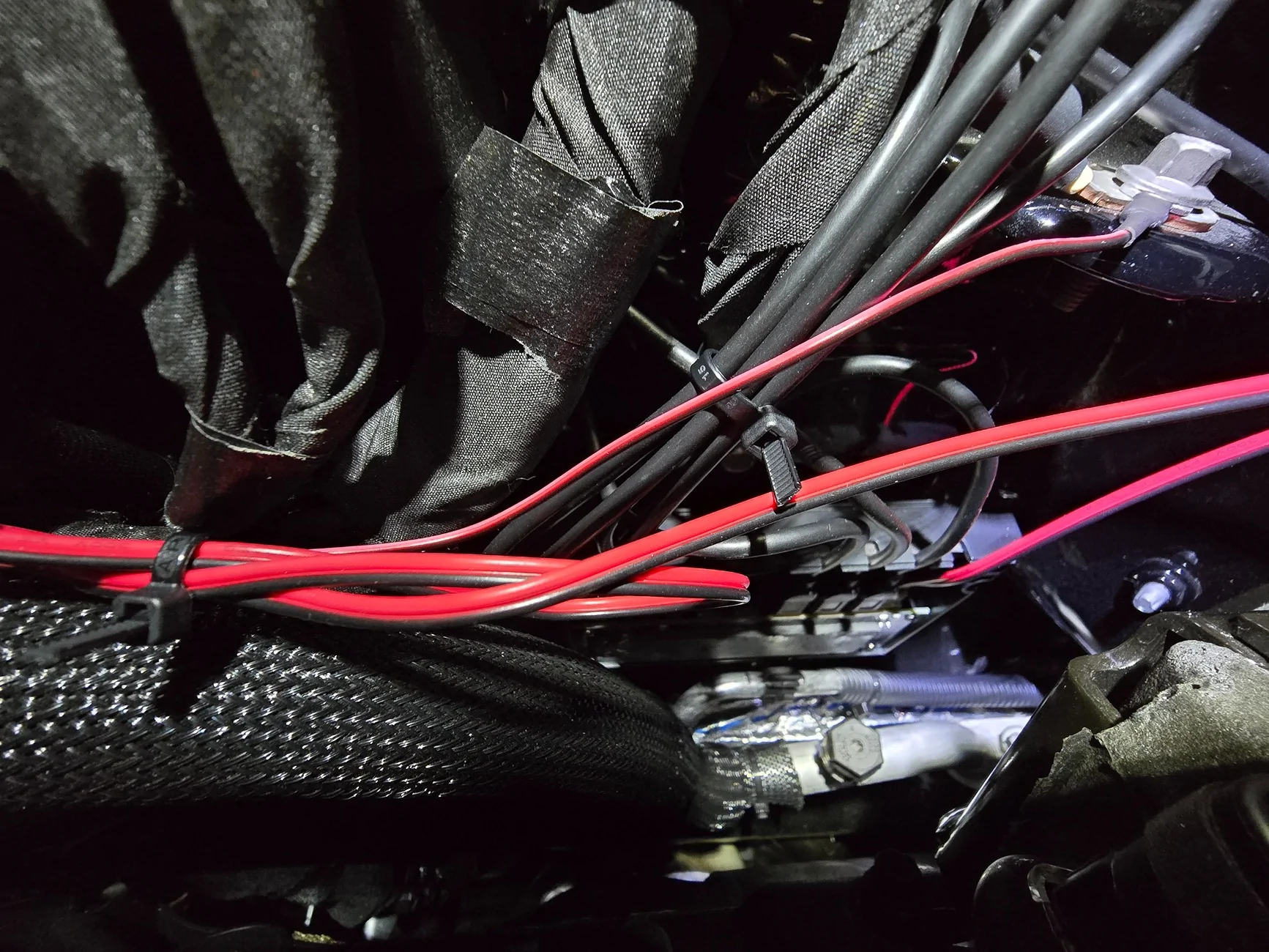

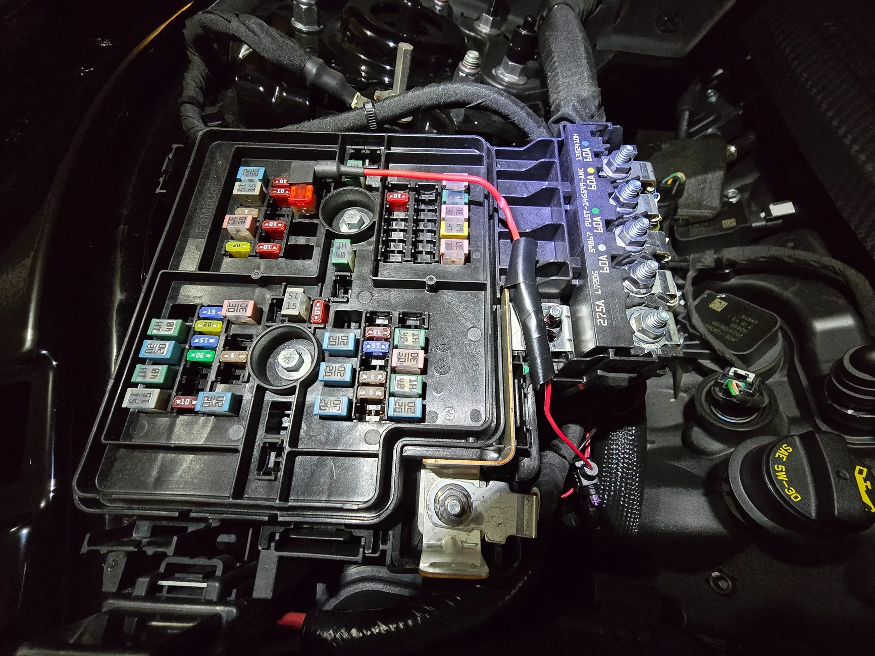

Wired to fuse box
S650 Mustang TPX Laser Jammer DIY Install 20251018_171826

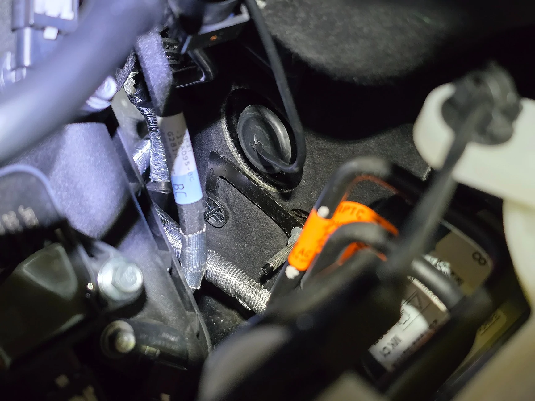

Thru firewall
S650 Mustang TPX Laser Jammer DIY Install 20251018_171858

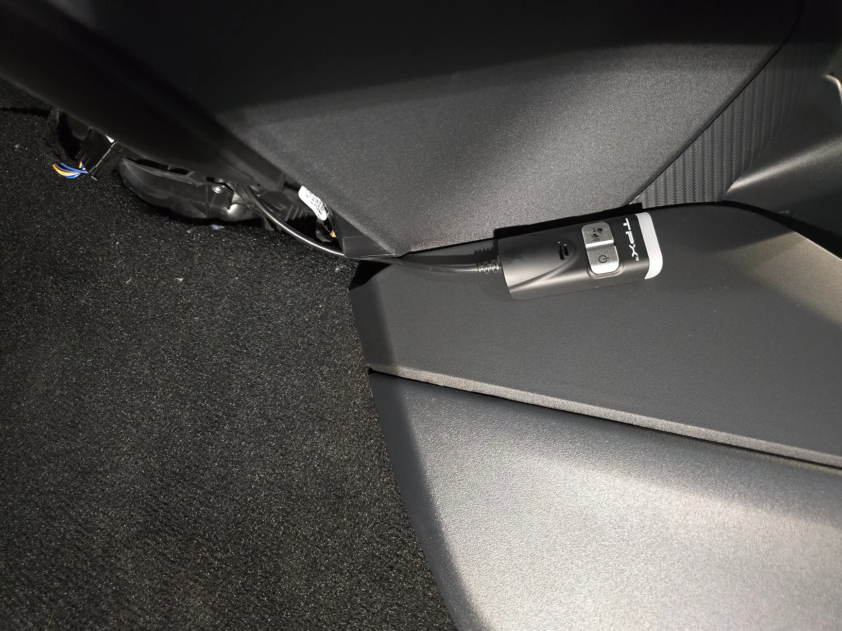

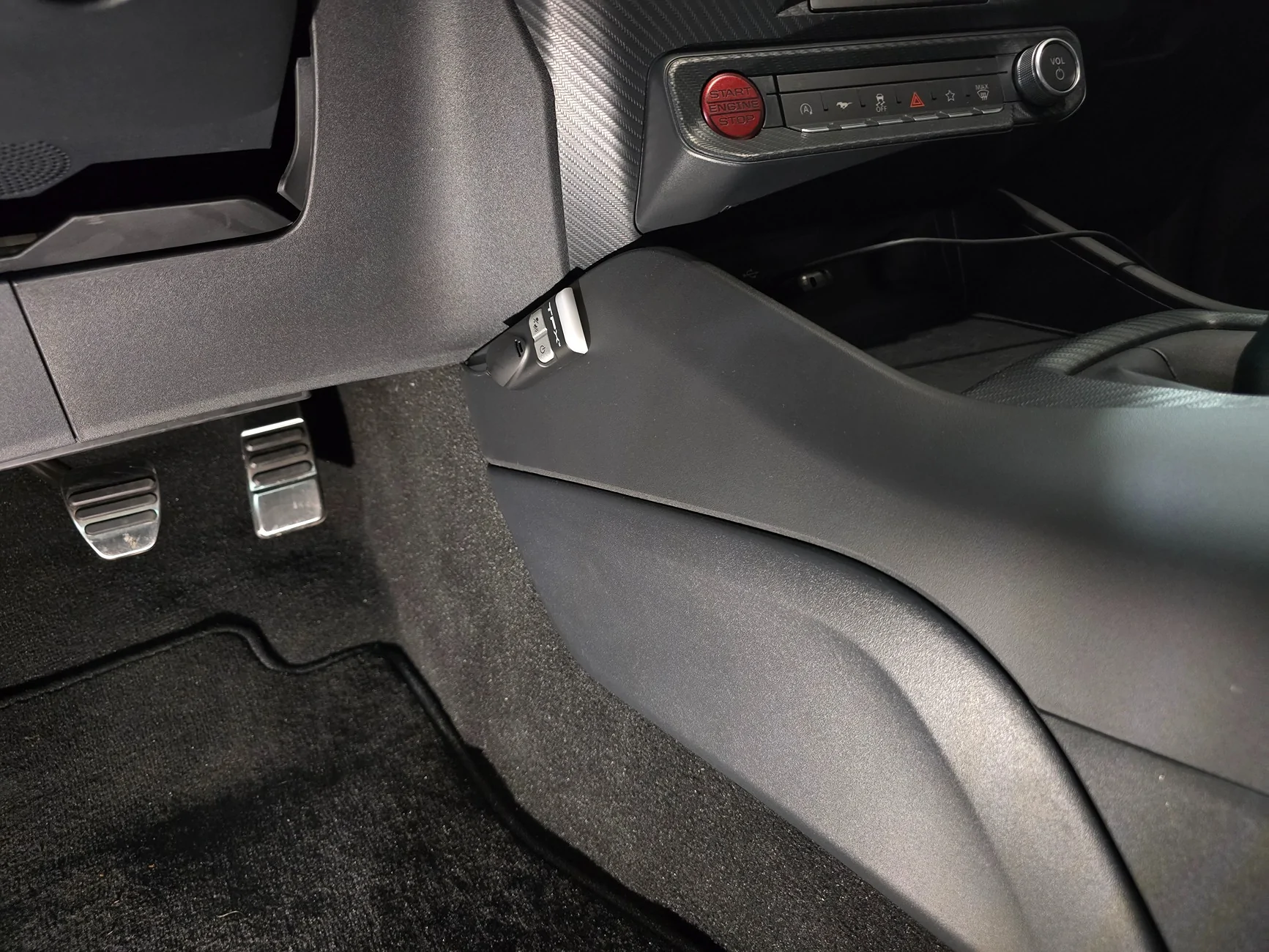

Control in the cockpit
S650 Mustang TPX Laser Jammer DIY Install 20251017_144020
S650 Mustang TPX Laser Jammer DIY Install 20251017_144034

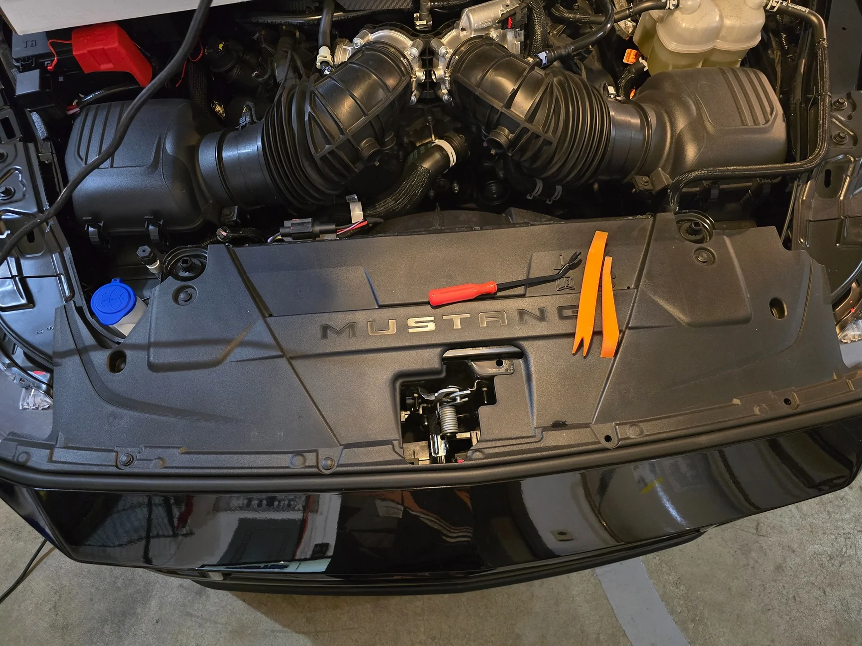

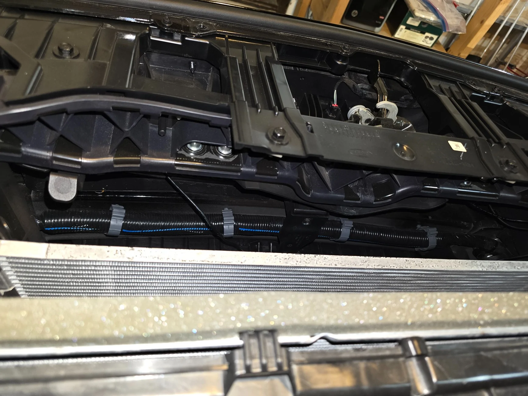

Remove radiator cowling to access behind the grill
S650 Mustang TPX Laser Jammer DIY Install 20260512_144312(1)
S650 Mustang TPX Laser Jammer DIY Install 20260512_144853

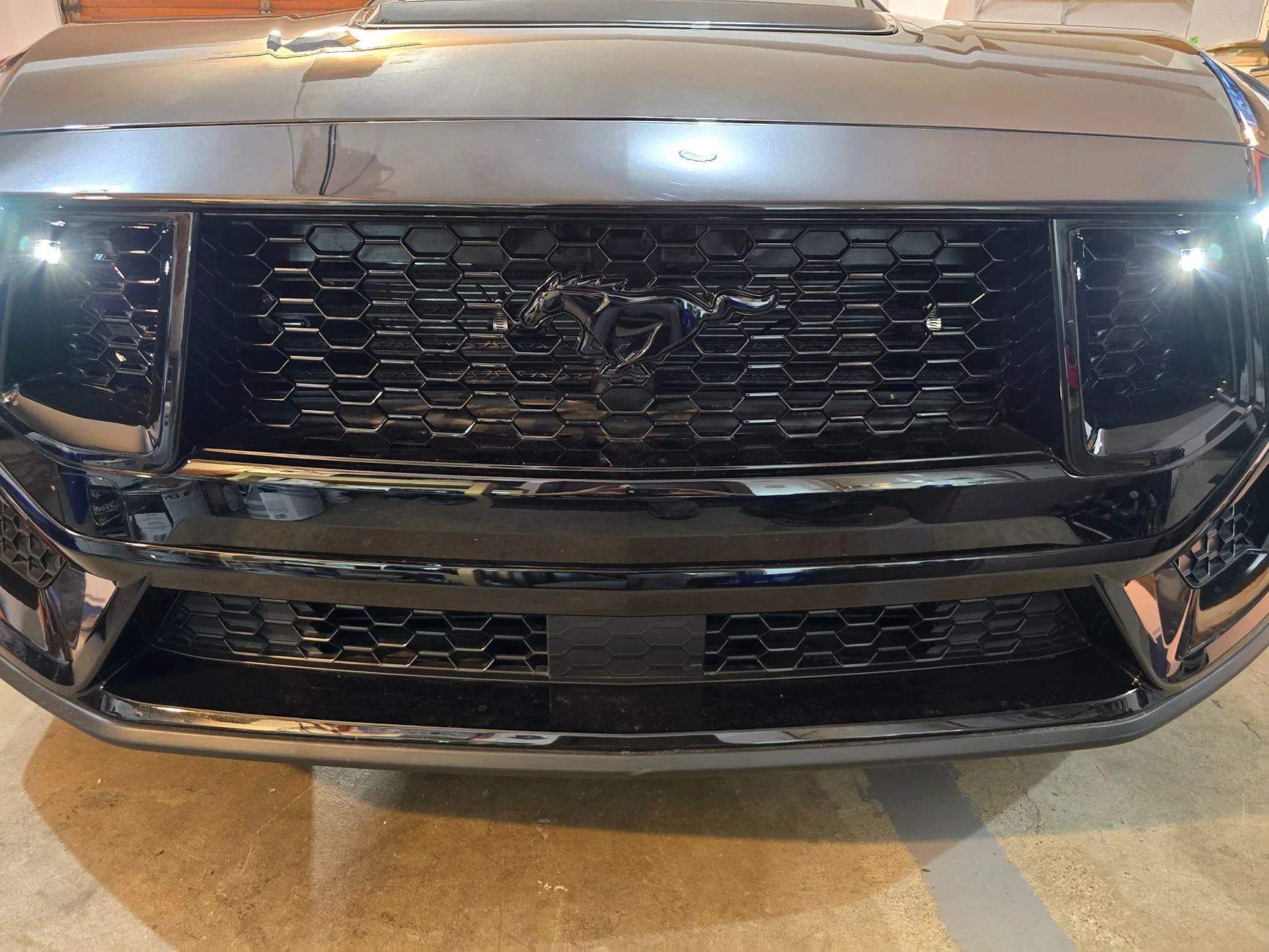

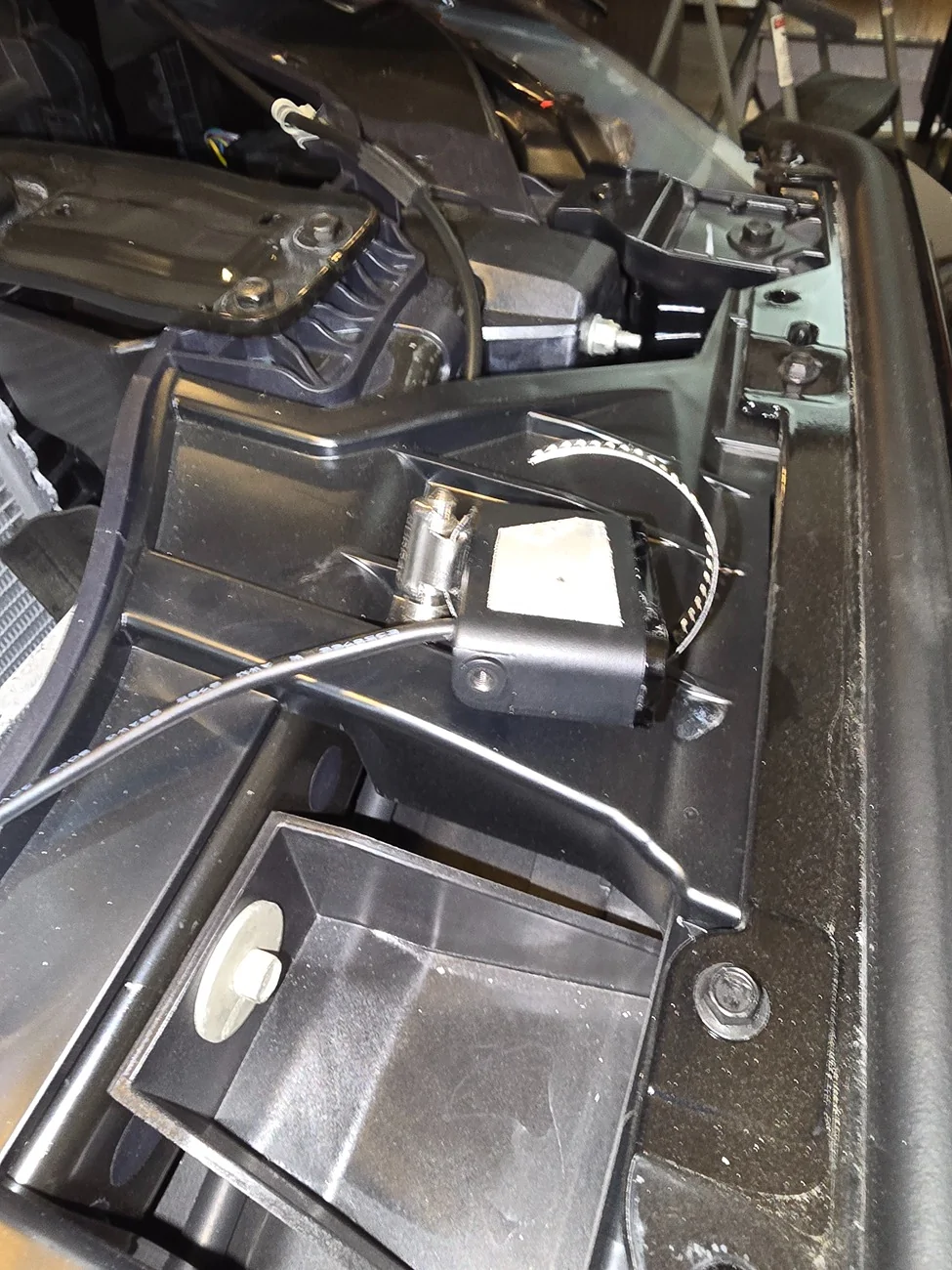

I used steel band fasterners to attach CM transponders (jamming heads) to fins behind grill
S650 Mustang TPX Laser Jammer DIY Install 20260512_153825
If you look closely you can see the stainless steel fasteners attaching the 3 jamming heads behind the grill.
S650 Mustang TPX Laser Jammer DIY Install 20260512_184655

Credit for the install. You are probably aware If the heads are obstructed in any way it reduces the overall effectiveness of the jamming capability. I understand there's a toss-up between the desire for stealth and not cutting. I think the TPX system claims to be waterproof. What is your feeling on that?

How did you get through the firewall? I couldn't really tell by the picture.

good looking install, but unless you're being tagged from a fair ways in front, they're going to be rather ineffective. also you should know those shudders open and close, they don't stay still, so just hope they don't ruin the cables to the heads or close when you're being targeted
