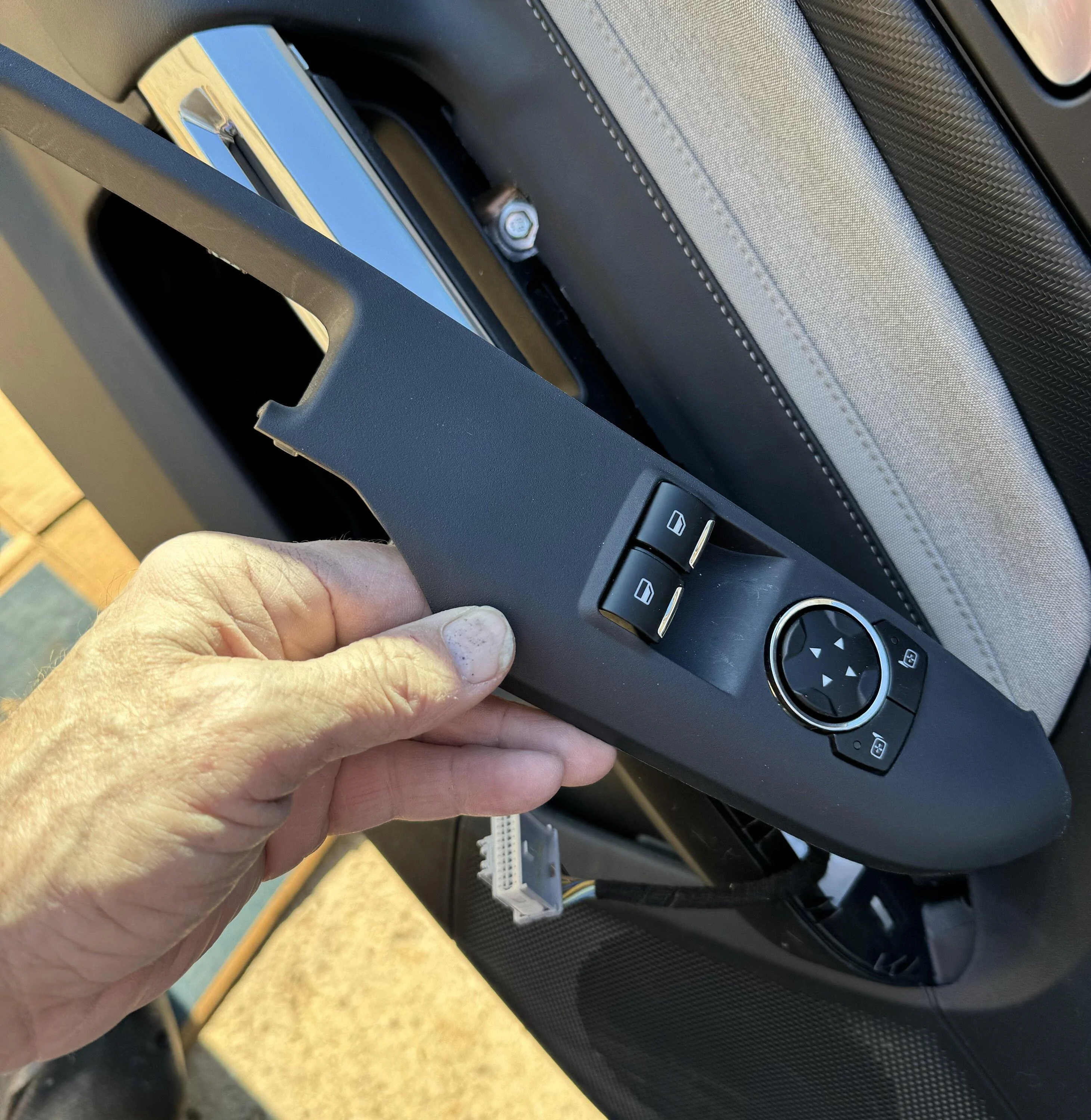

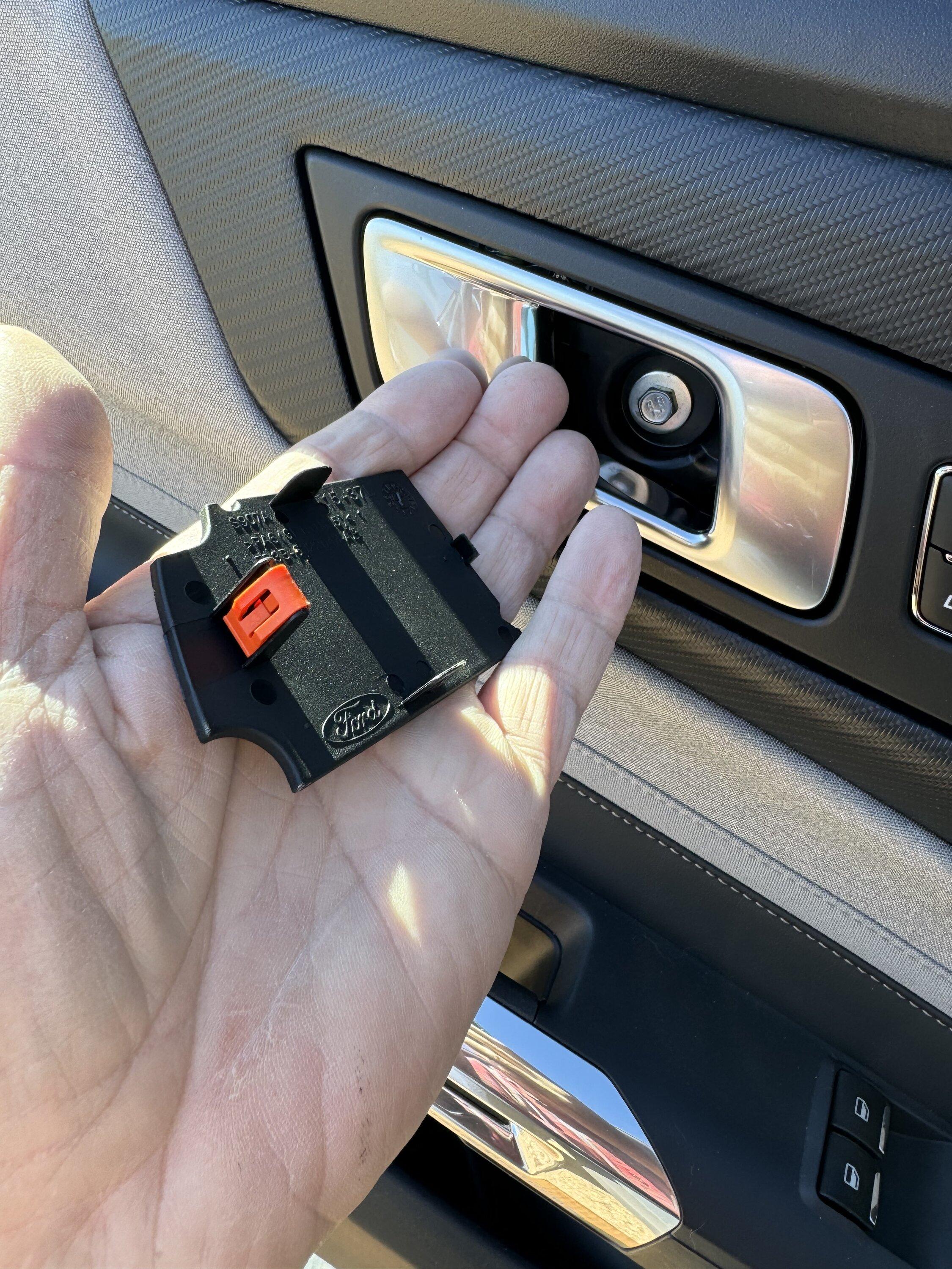

Pop out the small panel behind your door lever. That shiny bolt takes a 10mm socket. Do same for the switch panel (carefully pry it up with your plastic pry tool) and you’ll find another 10mm bolt. Withdraw both bolts.

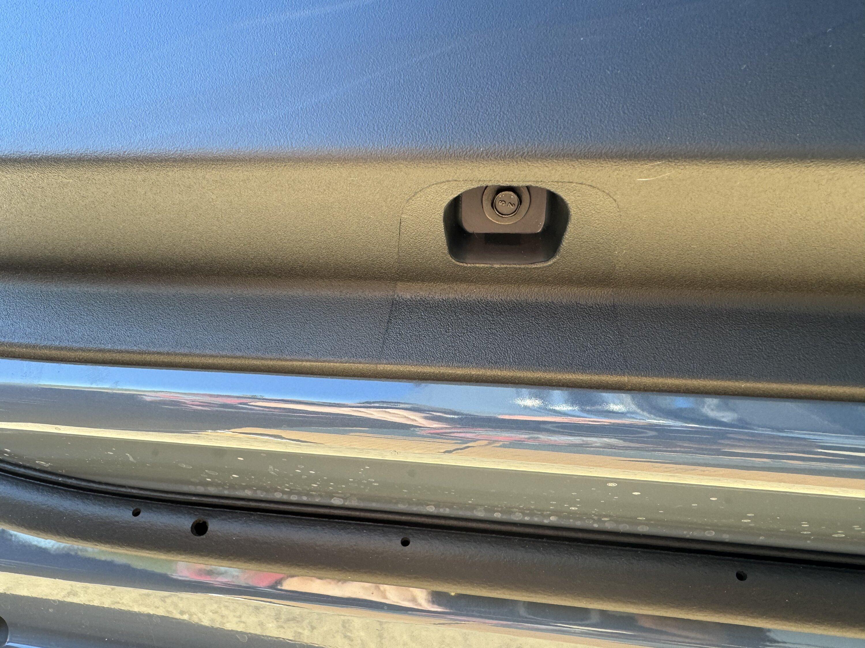

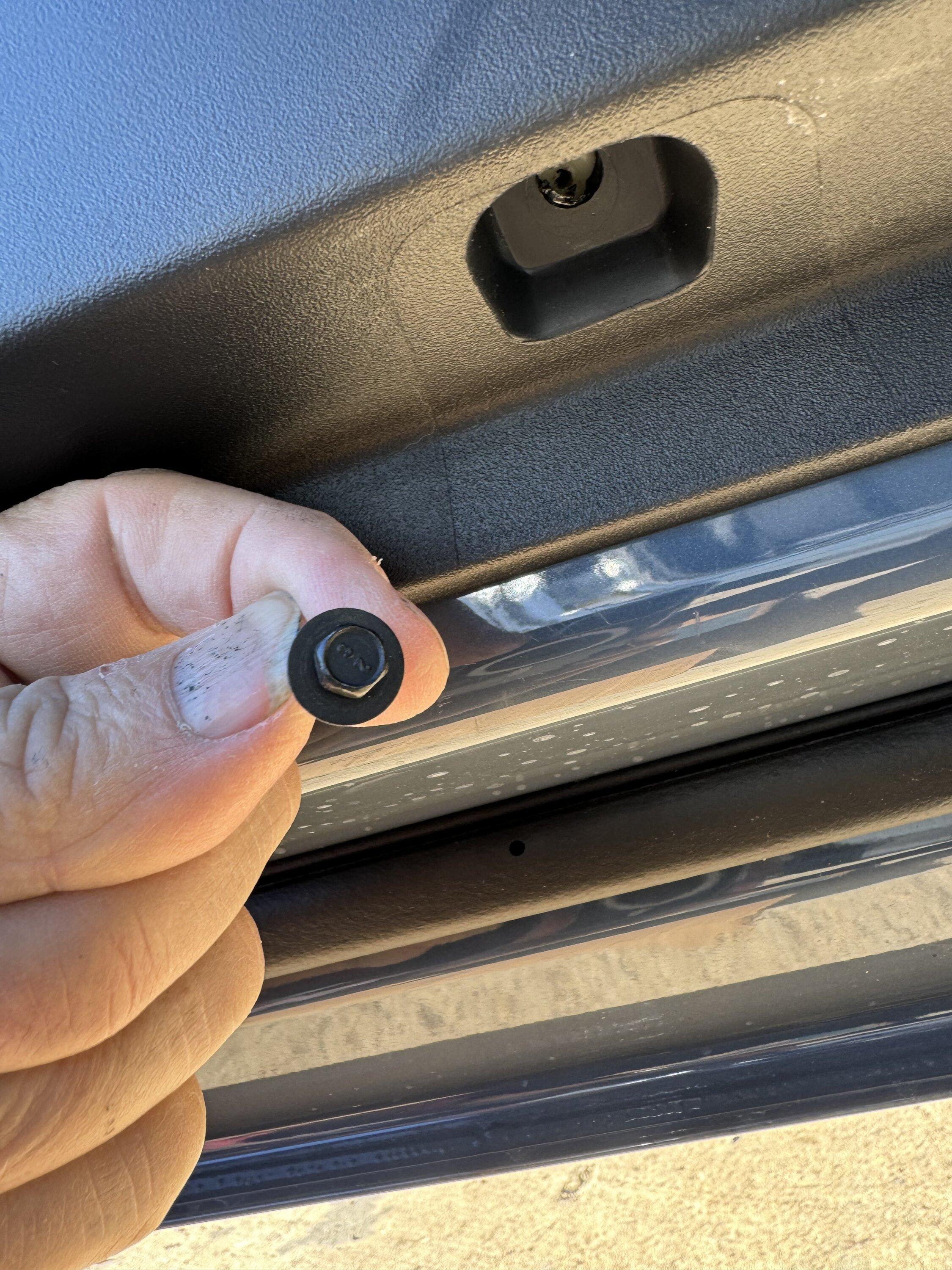

You have a pair of 7mm screws aslong the bottom of your door panel. This one is out.
S650 Mustang Removed Door Panels for Speaker Upgrade - DIY Writeup IMG_0608
This is the other 7mm bolt, waiting for you.

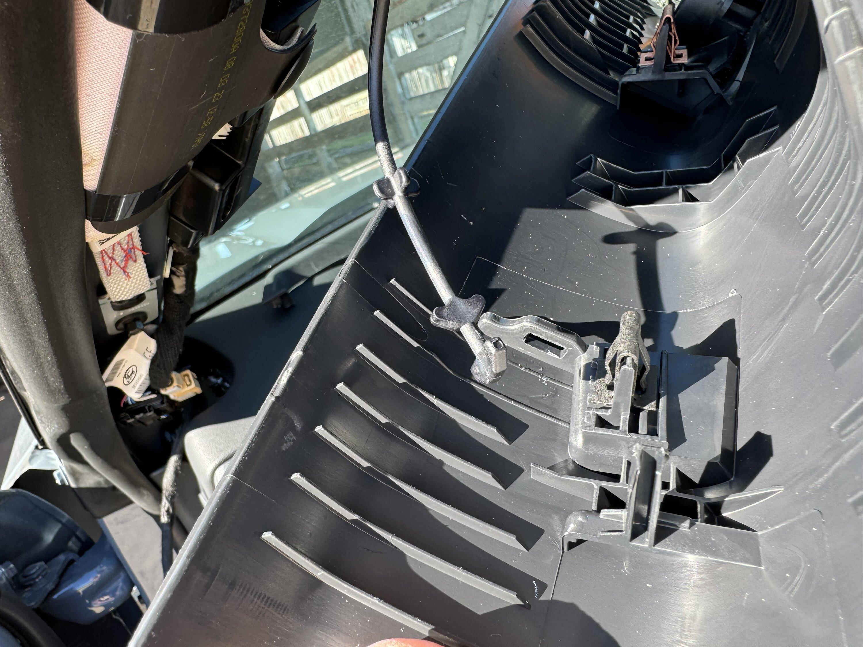

Pry out the top of the A pillar trim panel. You have to rotate (twice!) that plastic retainer in order to get the panel out of the car.

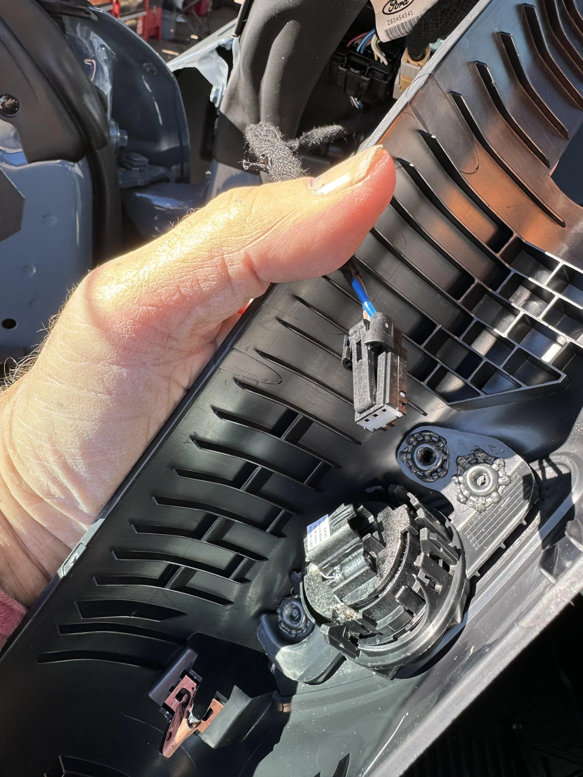

Stock tweeter, unplugged. My new tweeter was much larger so I had to cut into that mounting ring enough to have what was left secure my new tweeter. NOT for the faint of heart!

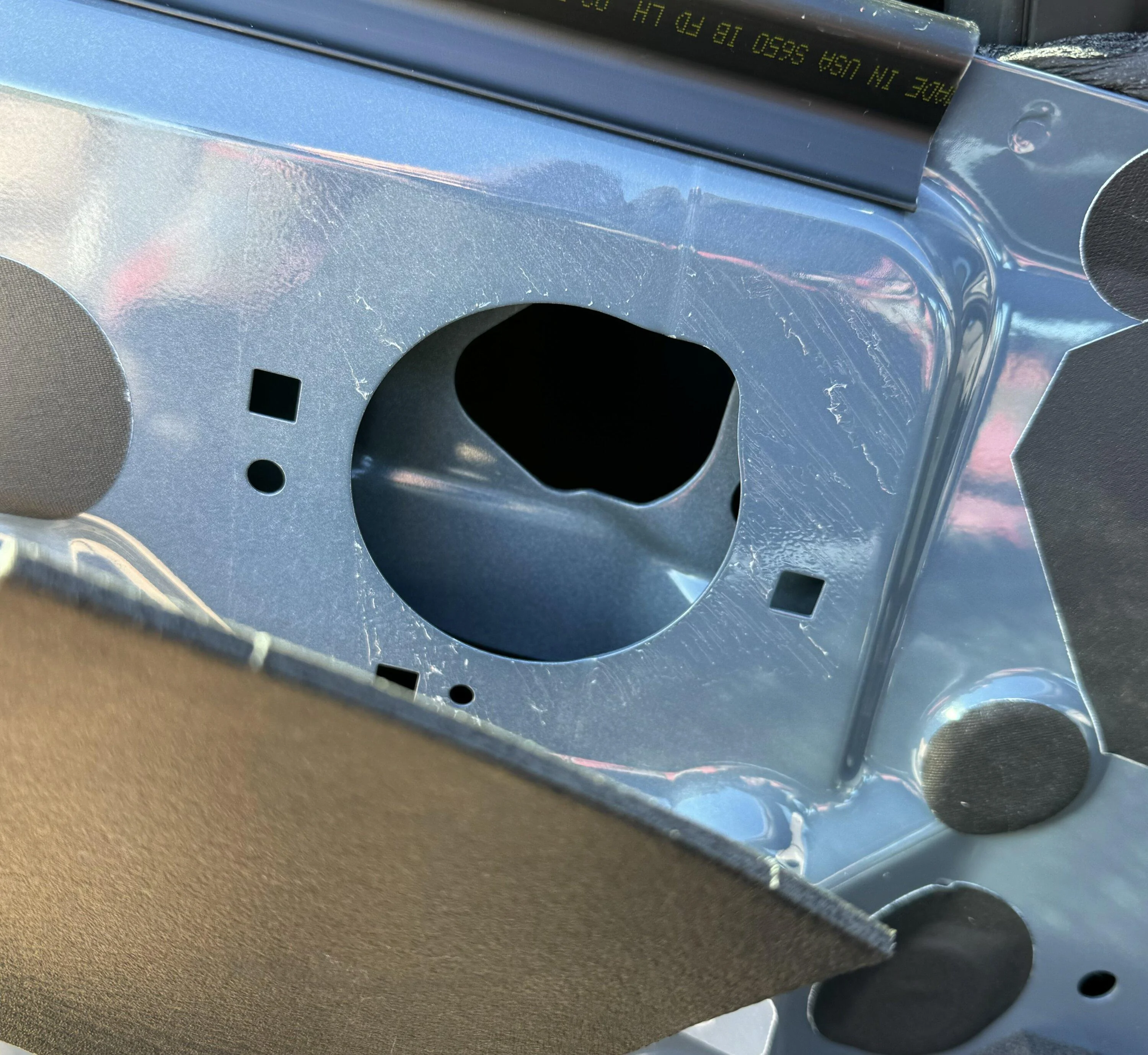

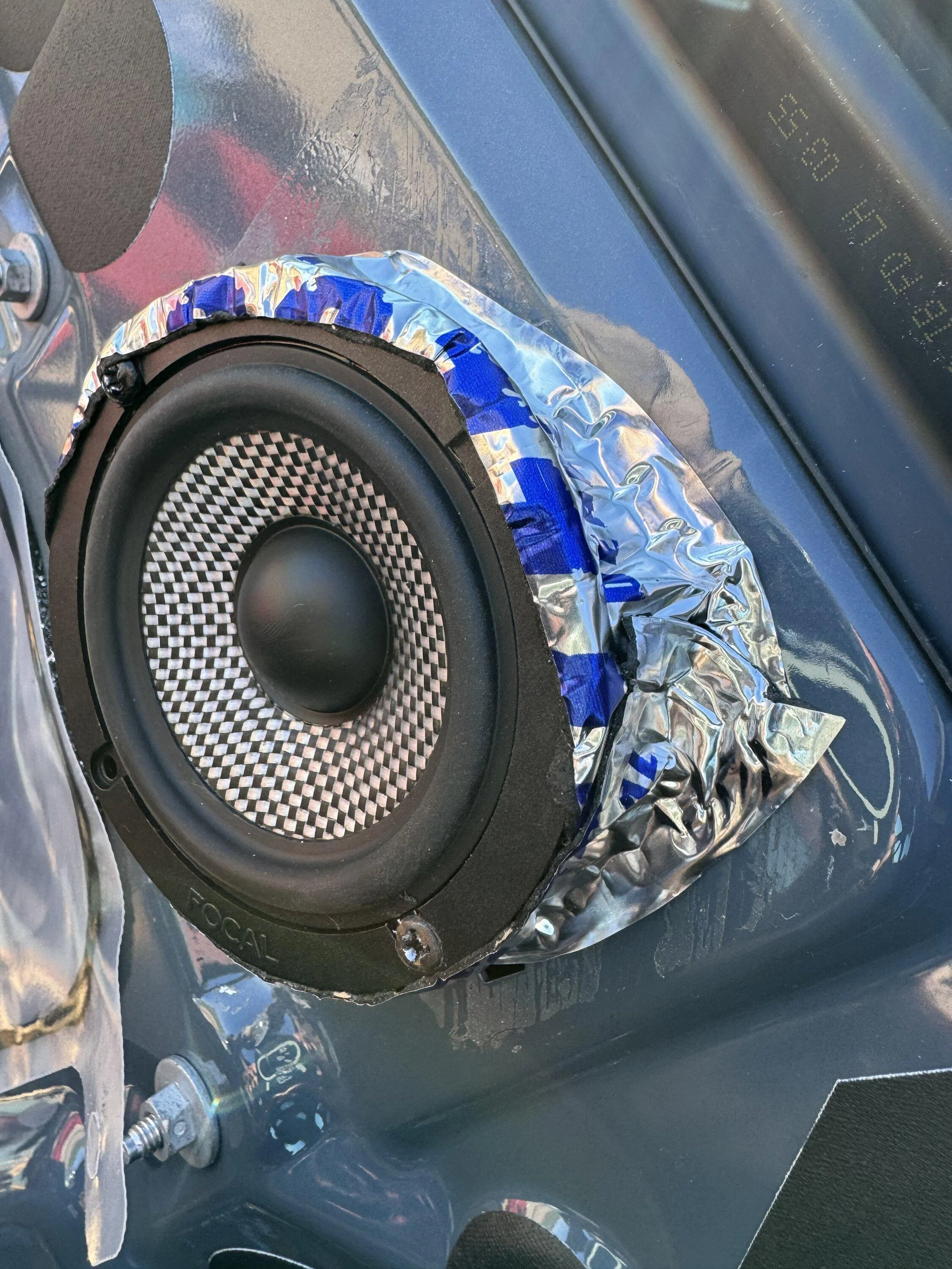

My midrange was way too deep to fit in the shallow opening so I did two things. 1) I used a jigsaw to cut into the second (slightly deeper) metal of the door and then used a chisel to beat the cut pieces back enough to allow more room for the magnet of my new mids.
S650 Mustang Removed Door Panels for Speaker Upgrade - DIY Writeup IMG_0616

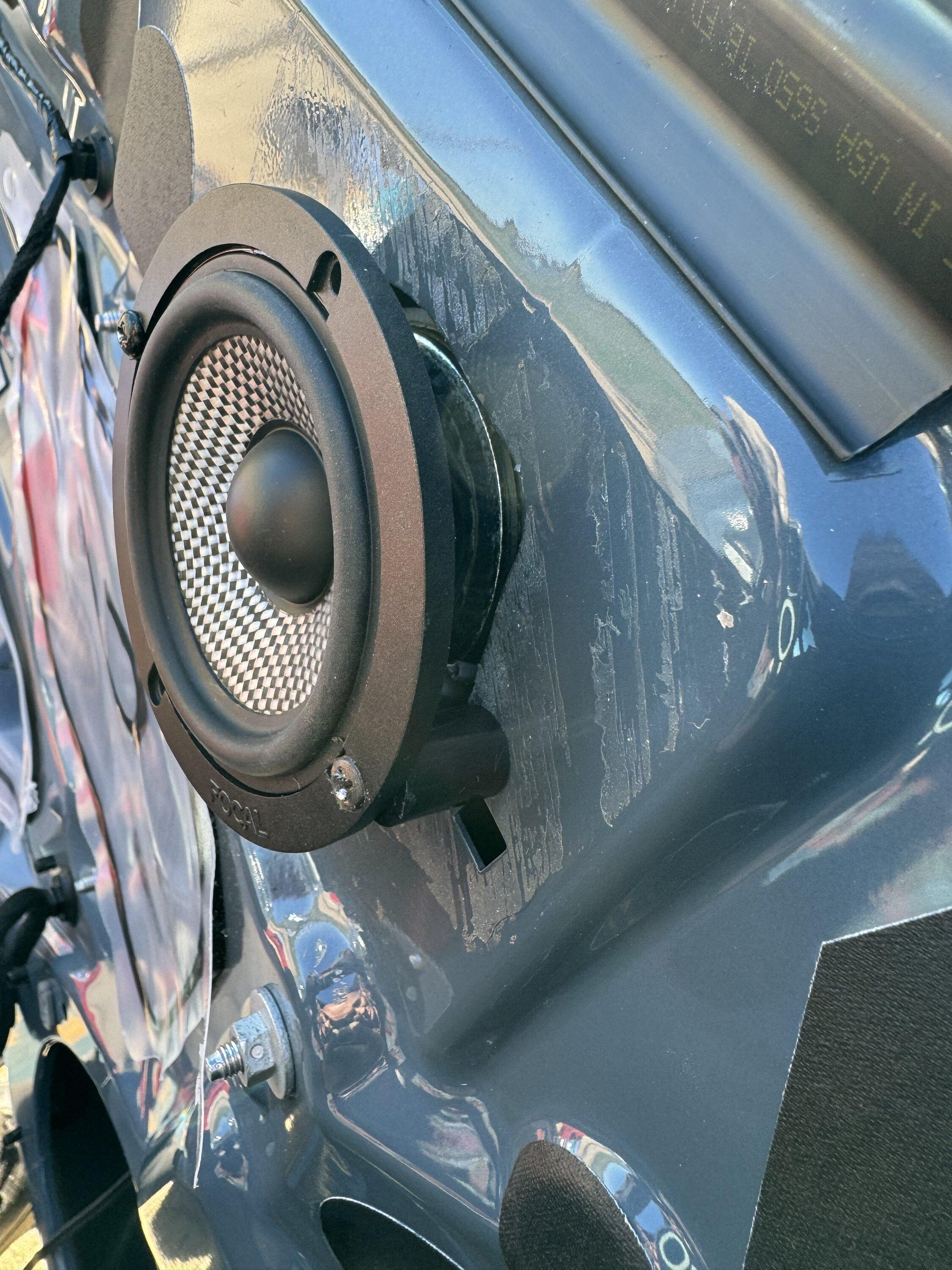

Using just two long sheet metal screws and a pair of 1/2” spacers, I got the mid driver in. Used some dynomat as an insulating ring arou d the driver to seal it.
S650 Mustang Removed Door Panels for Speaker Upgrade - DIY Writeup IMG_0618
All this trouble just to now see an aramid fiber midrange where there was nothing….worth it!

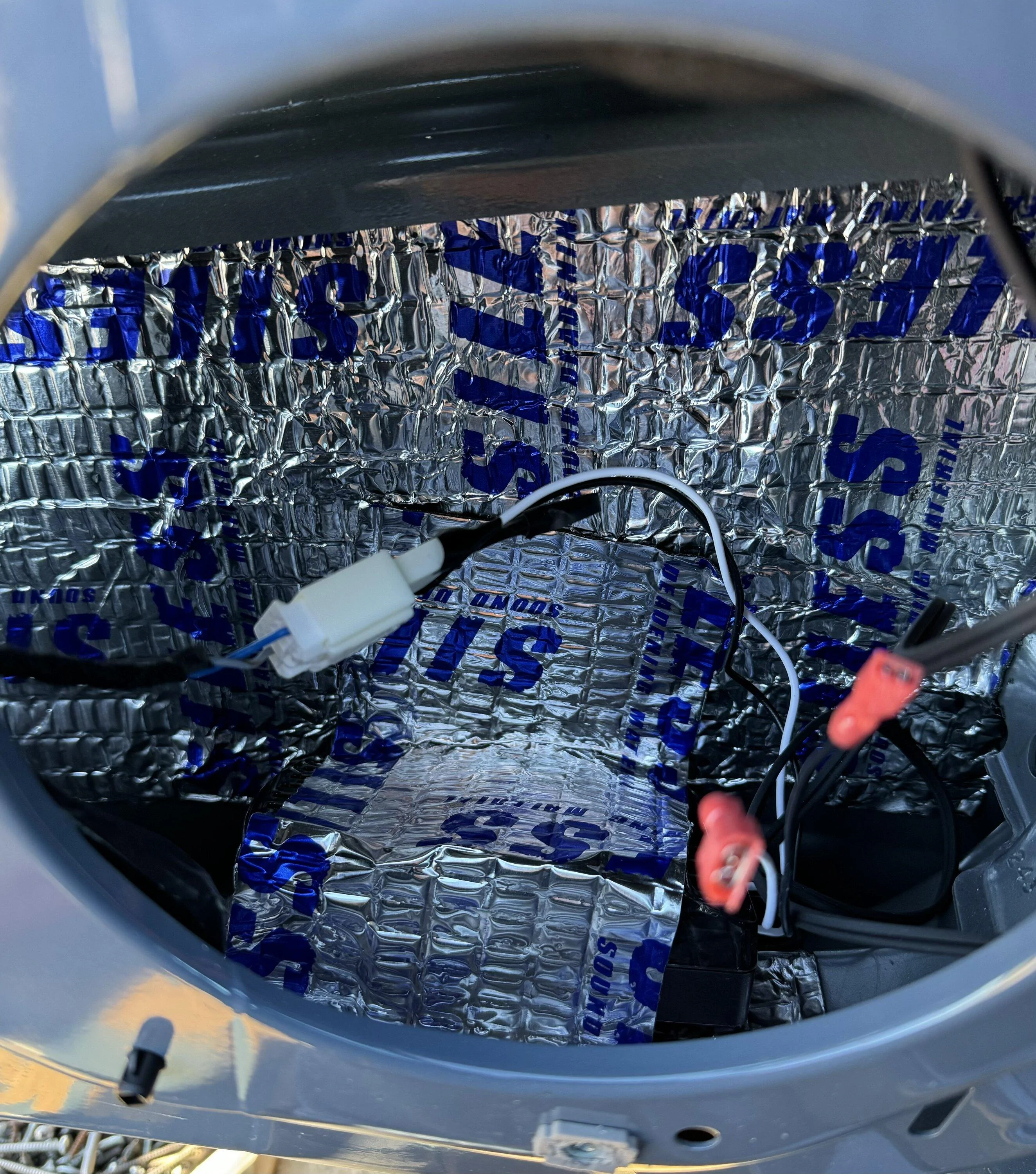

Here’s a view of the window switch area along with the midrange speaker opening. Look how close that deeper panel is to the face of the door.
S650 Mustang Removed Door Panels for Speaker Upgrade - DIY Writeup IMG_0602
This piece was down tight! New car…
S650 Mustang Removed Door Panels for Speaker Upgrade - DIY Writeup IMG_0611
I think that the 9 and 12 speaker cars have a mounting bracket that goes here to offset the stock midrange out a bit. Not having that bracket, I had to come up with my own way to do the same thing! That square black piece of foam was stuck over the midrange opening to seal that area in this 300a car.

What is the depth like behind the woofer? I see which model of Focal 3-ways you used and I'm looking at doing the Focal Flax which are about 3" deep.
gwoutrider
Feb 4, 2026
The Woodlands, TX
2024 Mustang Convertible
Using the Harmony Audio adapters (they are thicker), I had no issues mounting Focal PS 165 midbass in the doors. Checking the specs, the flax are 2.7mm more, but I had at least an inch of space left, if not more
